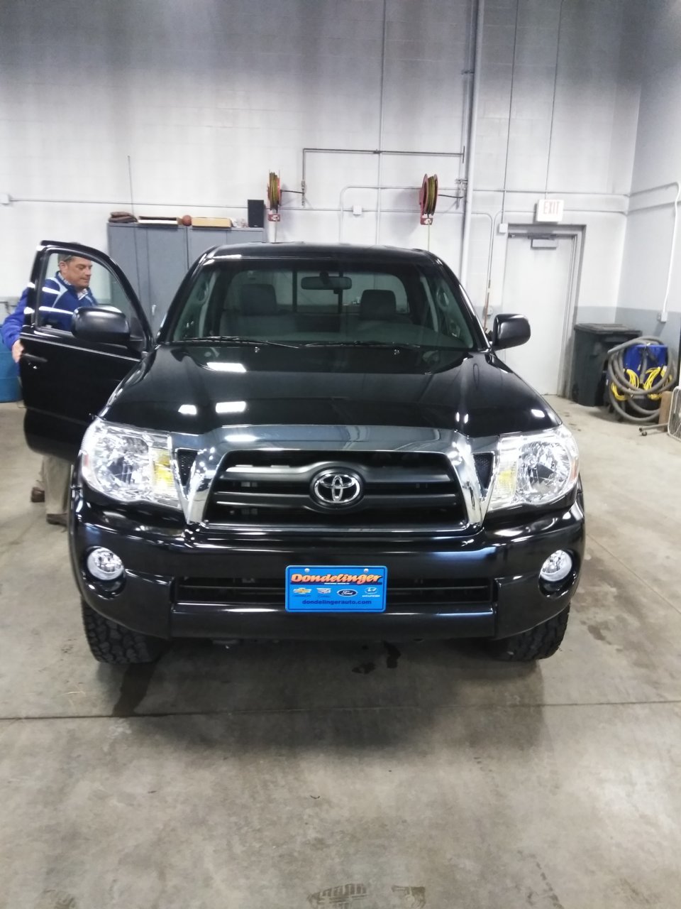

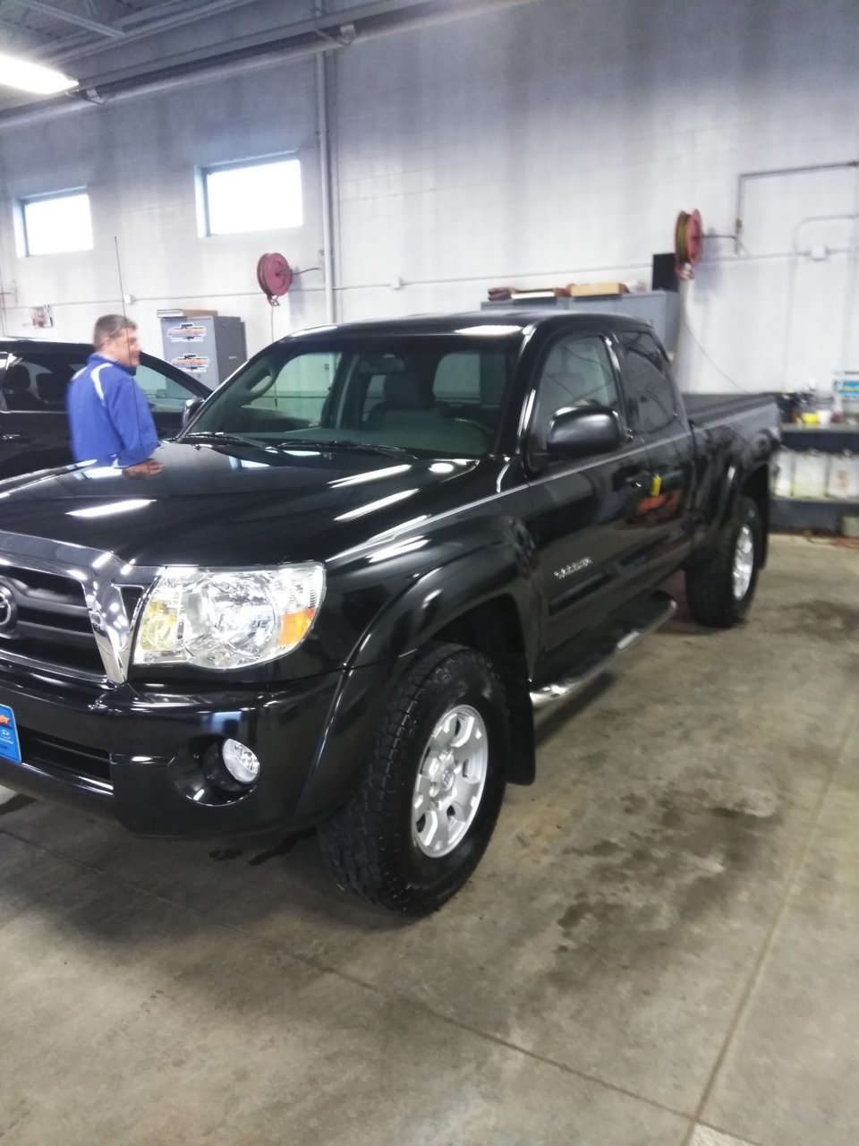

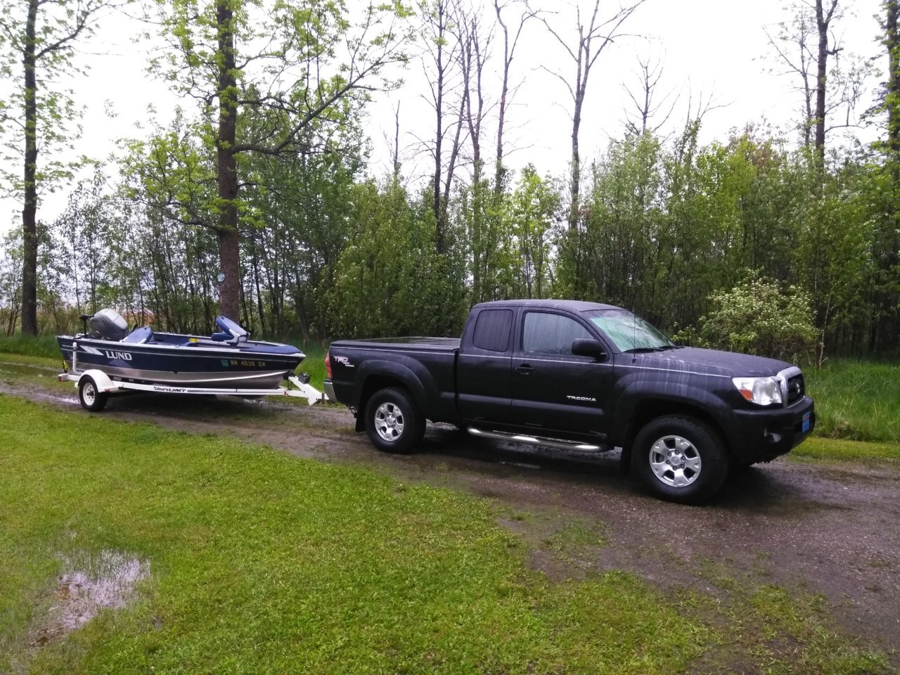

    Here it is all shiny and new looking right before I drove it off the lot.... Then I had to hook up the boat and go chase walleyes

    What a find!!! Awesome truck you got there.
    Check out the stickys for maintenance tips, also use search, there’s tons of info here for ANY issue you might have.
    Have the dealer run the VIN for any outstanding TSBs, recalls....
    Terrific, good for you :cheers:
