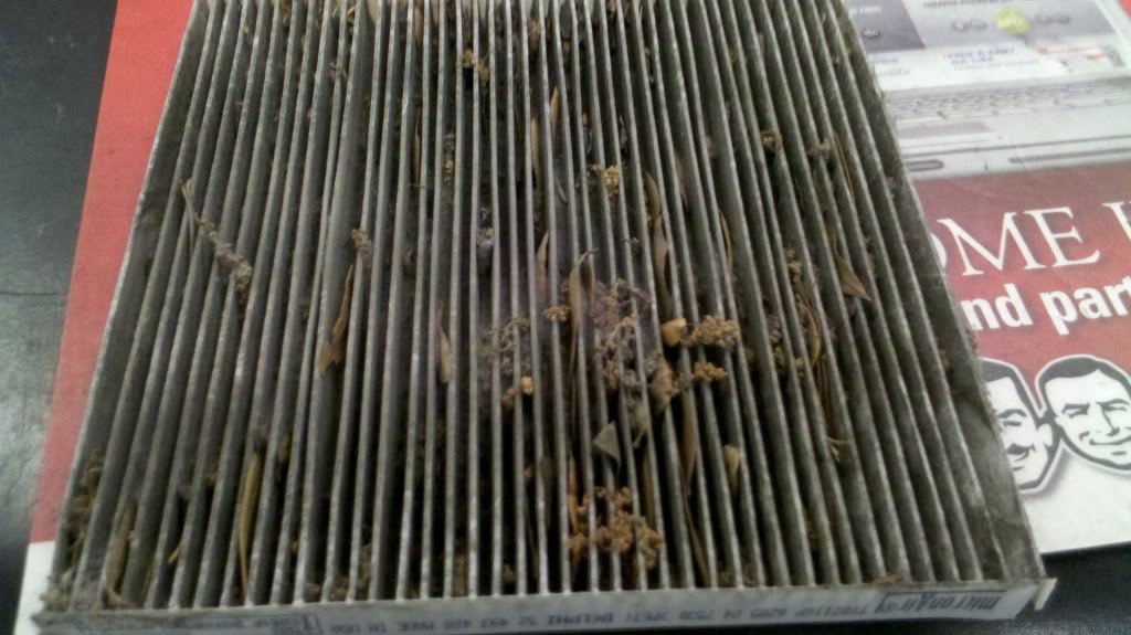

    Here is what my 70K mile cabin air filter looked like. And dont worry I took out the blower motor and cleaned out the AC case and put a new filter in

    Toyota wanted 40 bucks for a Cabin air filter pepboys was 25
