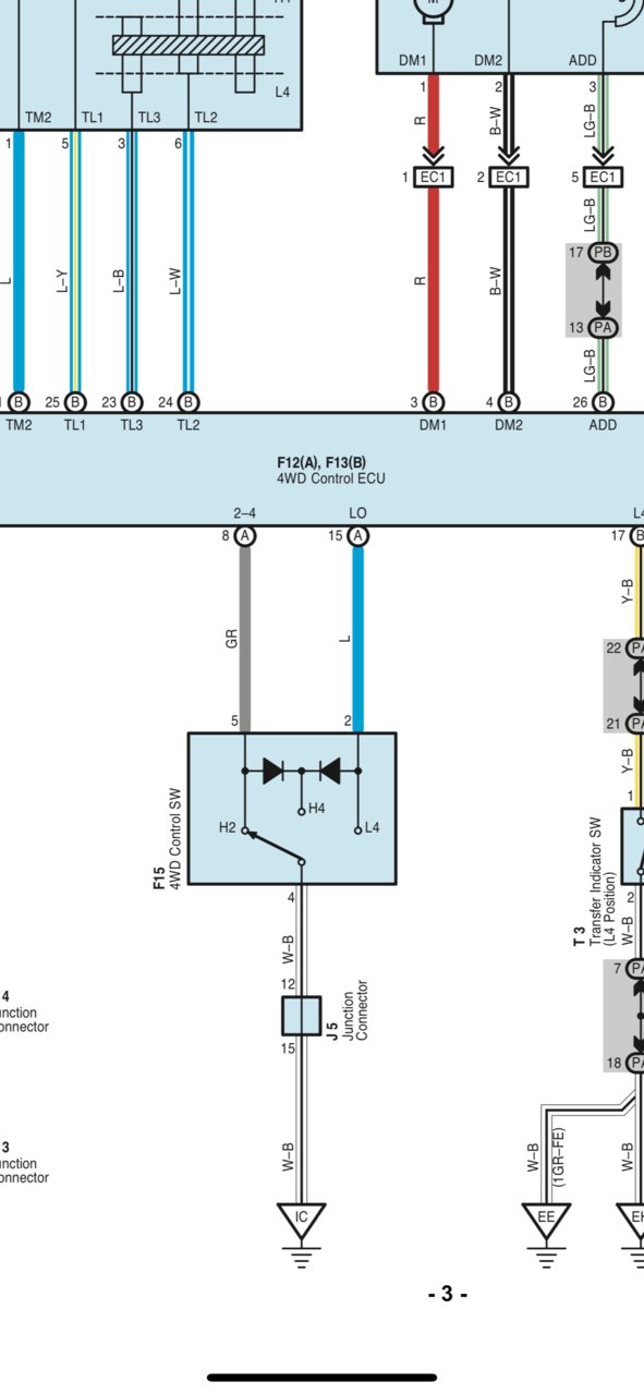

    switch will have continuous power. Likely around 10 volts there’s a diode when 4 hi is selected. Measure from pin 5 to pin 4 of the switch. To post pics hit “upload a file”, select the pic, then once it’s at the bottom of the screen attached hit full image.

    just pry it out by the vent, comes right out. None of the dash has to come apart.
  15. Nov 24, 2020 at 12:52 PM
    6 gearT444E
    6 gearT444E Certified Electron Pusher
    Feb 3, 2018
    #243372
    7,776
    Deep South
    Herculiner Hootus
    See attached, hope this helps. Good luck.

    I pulled the switch, took it apart cleaned it and used diaelectric compound and after reassembly checked it with a meter. Contact is good and diodes are ok. The harness that plugs into it has no power to it with ign on. Now what? There most likely is a relay under the hood for it but I have no idea which one.
  18. Nov 24, 2020 at 4:07 PM
    #18
    TnShooter
    TnShooter The TacomaWorld Stray
    Sep 2, 2010
    #42625
    20,888
    Deogee
    07' TRD Off-Road, Auto
    STOCK
    What switch are you talking about?
    The actual switch on the dash that turn to engage 4WD?
    If so, there is no relay. It goes to the 4WD ECU.
    In the T-TT-0052-10.pdf file that 6Gear provided above, you will find a diagnostic chart.
    It shows you what reading you should find in each 4WD mode.
    6 gearT444E likes this.
