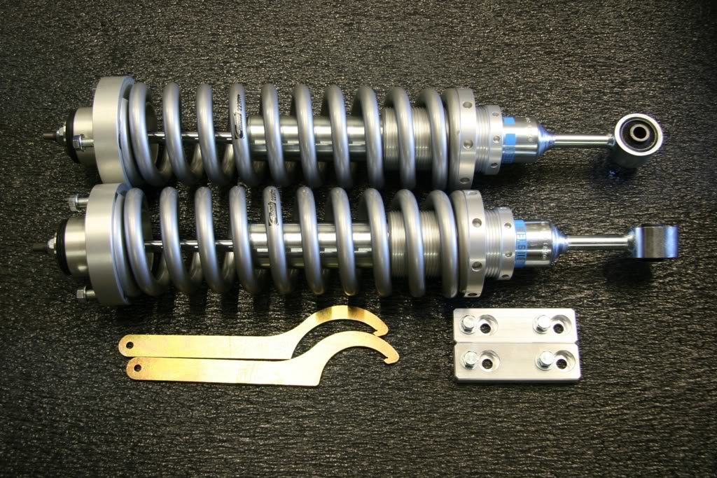

    Here is a recap of what i'm thinking of getting for my 2007 Tacoma TRD 4x4 Dbl Cab.
    1. ToyTec Front Coil Overs For 05-09 Tac SKU# TTAFCS-6005
    2. Alcan Add-A-Leafs
    3. Diff Drop
    4. Bilstein 5125's for the rear
    Note: You quoted me $1050 for the above.
    5. Also thinking about getting the Extended Break Lines?
    Questions:
    1. How much will the rear 5125's with the AAL raise the rear?
    2. What height setting will I need to use on the front shocks to level with the rear?
    3. I have 265 BFG's that came stock on 16" Rims. Will I need new Rims if I go up to 275? 285s?
    4. Am I missing anything else that you recomend I get with this set up.

    why 5125 billys in the rear instead of 5100's??

    I talked to Kirk at toytec and I think he said that the 5100's were for the front and the 5125's are for the rear.

    they make billy 5100's for the front and rear.....just the rears arent adjustable. i have the 5100's on my truck.
