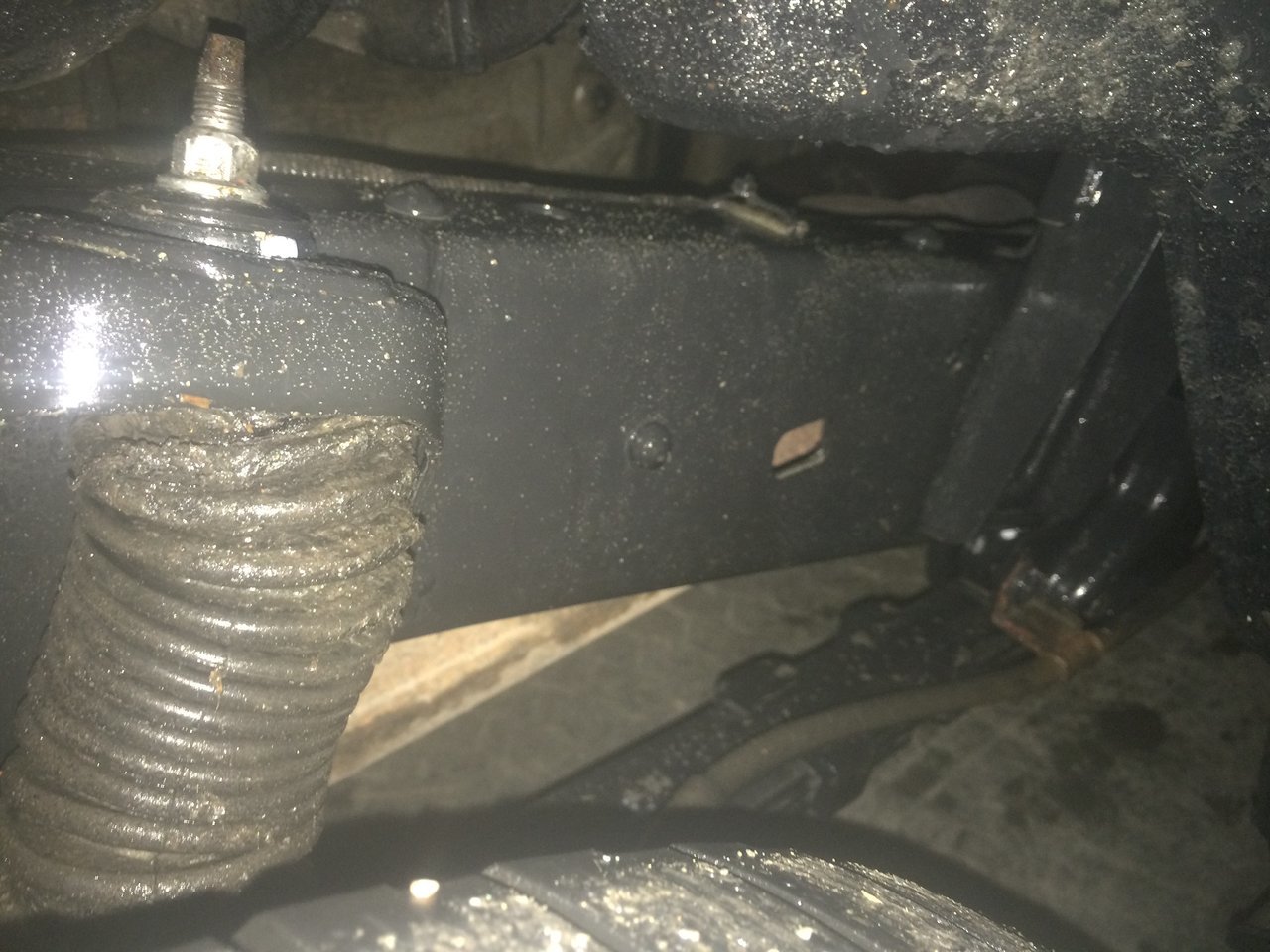

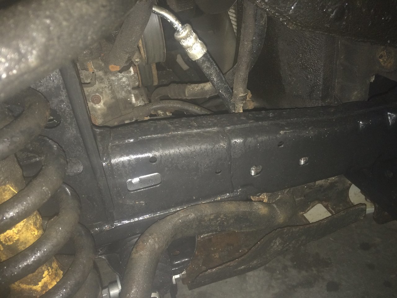

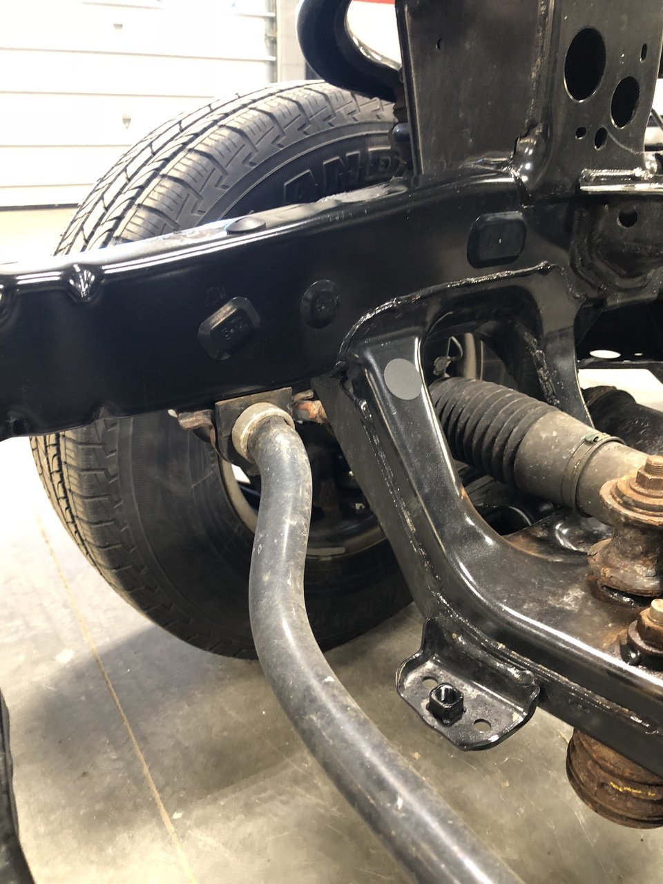

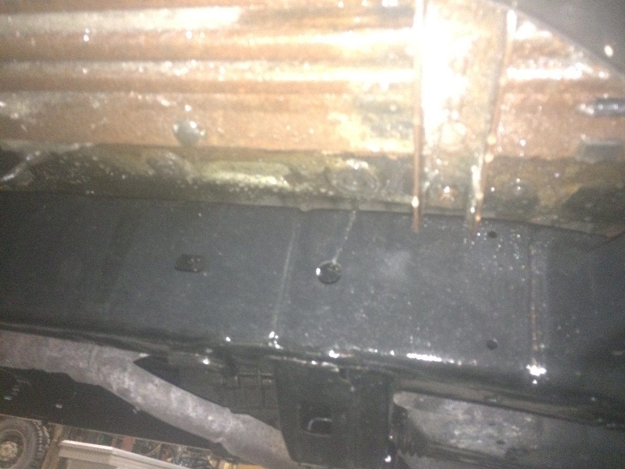

    6. new frame, and i noticed that there are big open holes in my frame with no plugs in them. Some people say its not included with the frame recall, some said it was not on the Canadian trucks PLUG KIT - TOYOTA (04002-07104)

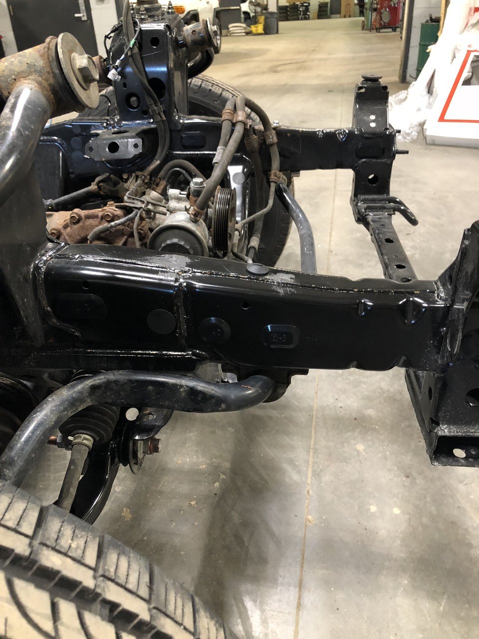

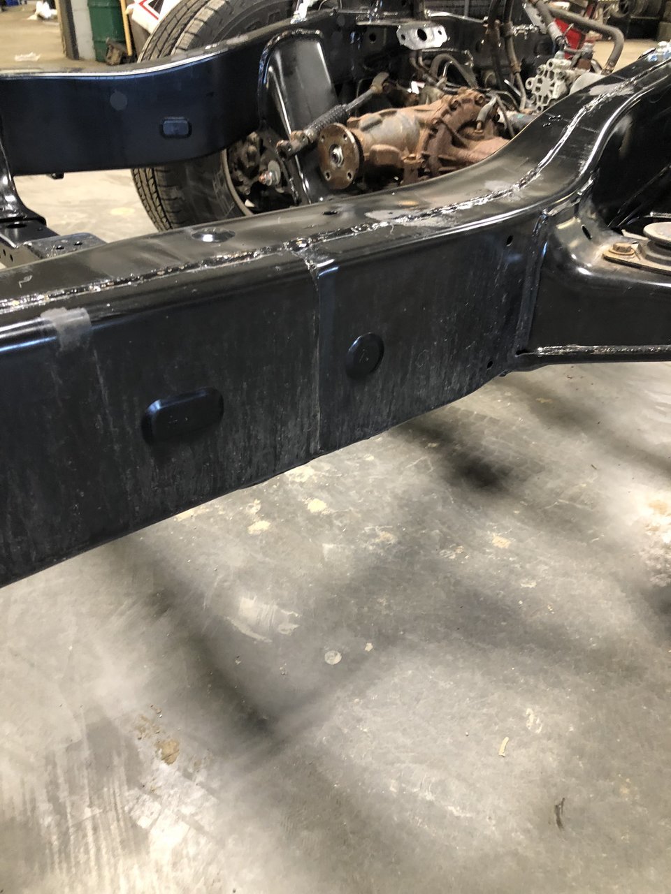

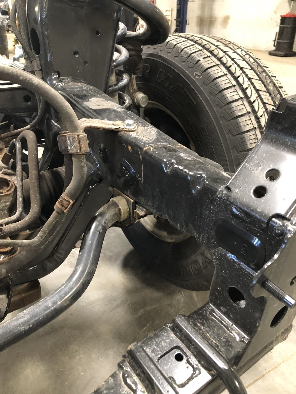

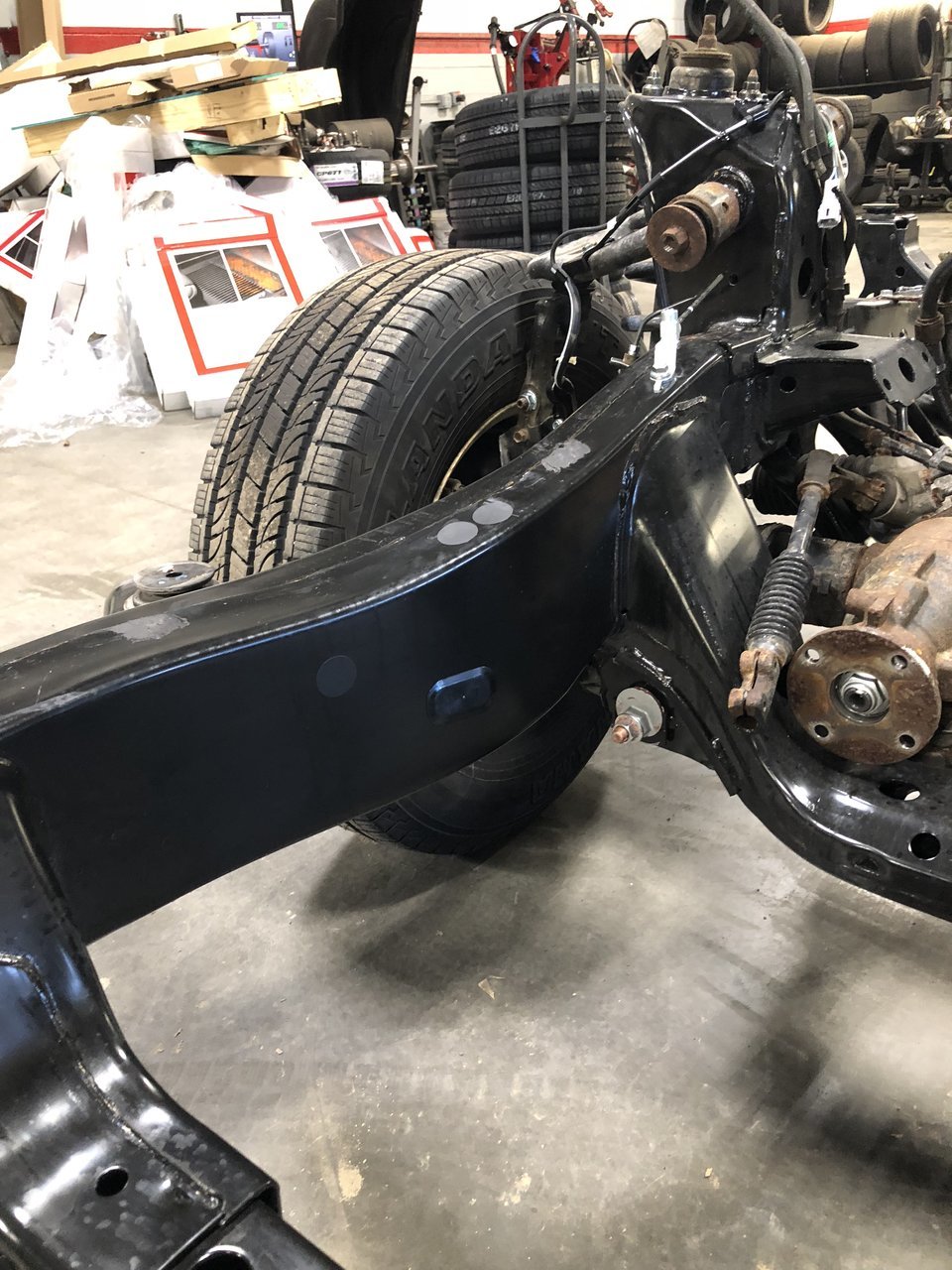

    I work for toyota in the US and i can't see what the technical instruction read for your country. We get plug kits in the US for the front boxed section only, After the frame turns to C channel no plugs are applied into the frame there should also be big plugs right at the box to C channel Section. If you look under your truck on the drivers side its right next to where the rear brake lines go body to frame on the inside obviously.

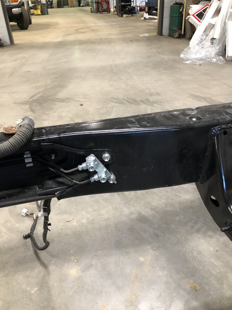

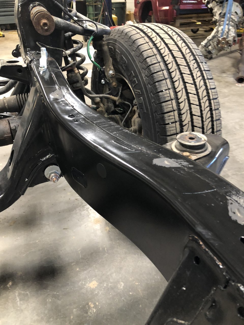

    Here are some pics of a 4x4 plug kit this is a 2tr truck. I install the plugs right before I put the power packs back in it’s easier this way but it can be done with the cab on and drive train in.

    I seen somewhere there was 29 plugs ?
    I am going to have to find a way to get some in Canada
    Do you think they are worth it ?
    Do you have any suggestions or tricks to treat the inside of the frame with a rust check ?
    Thanks for the pictures :)

    Honestly i don't know how many plugs the kit has i never counted. I know there is a difference between the spay kits and frame replacement kits. The frame plug kits are on Manual release only and the average person wont be able to order it, But you can order the spray plug kit and end plugs separate. I am not sure if the plugs work toyota sends them and i install them lmao. I am not a fan of the toyota chemicals for customer paid under coating we use a stuff called final coat. When my personal trucks frame comes in a few months i plan on using their wax on the inside of the frame and undercoating the top of the frame before dropping my cab on and then doing the entire outside of the frame. No problem on the pictures glad i could help.
