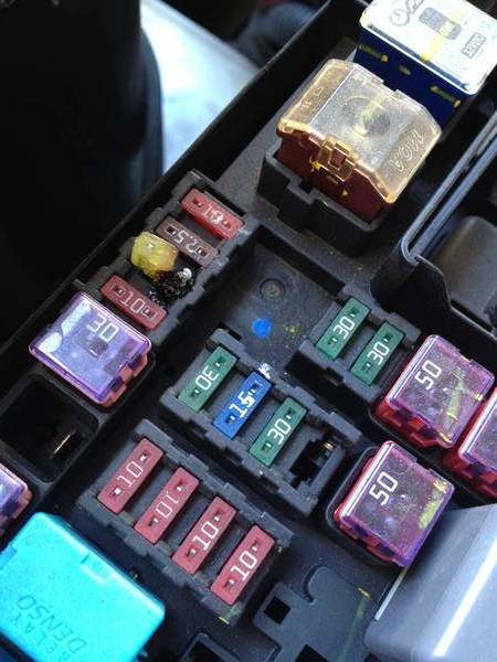

    Fixed it!! turns out my EFI fuse completely melted.... ive never seen a fuse melt this bad before. popped a new one in and it fired up right away.[​IMG]

    What could of caused that? Is the fuse holder corroded to cause increased resistance and heat?

    Yeah I'd be wondering just why in the fuck that fuse would blow, let alone MELT. SERIOUS concerns there.

    I would check that fuse socket. I don't see how it wasn't further damaged from the heat.

    Correct me if I'm wrong, but it appears that is a standard mini fuse that was in the slot, and not the micro fuses that surround it. Has it been an issue before this?
    After checking the diagram and junction layout, the melted side is the feed side of the slot. It is possible the spades on that "wrong style" of fuse fit too loosely into the slot and could be building heat. I would take a trip and put the correct micro fuse in there and make sure it fits snugly into its slot.

    I didn't catch that... After looking at the picture again I think you nailed the initial problem.
    I would be more worried about damage to the contact clips in that slot now. They do weaken with that kind of heat...
    Def put the right frickin fuse in the hole.
