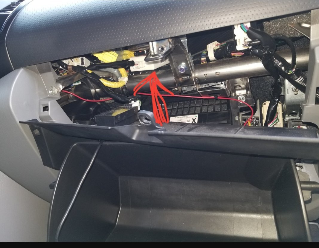

    Ok, take a look behind your glove box, after you remove glovebox, then take out the black plastic pannel (held on with a 10mm hex head bolt) and look for the white electronic box, if the white box is there, the truck came with remote locks & fob.Capture+_2021-12-06-17-14-36~2.jpg

    PERFECT! Thanks! I'll dig in and check for that.
