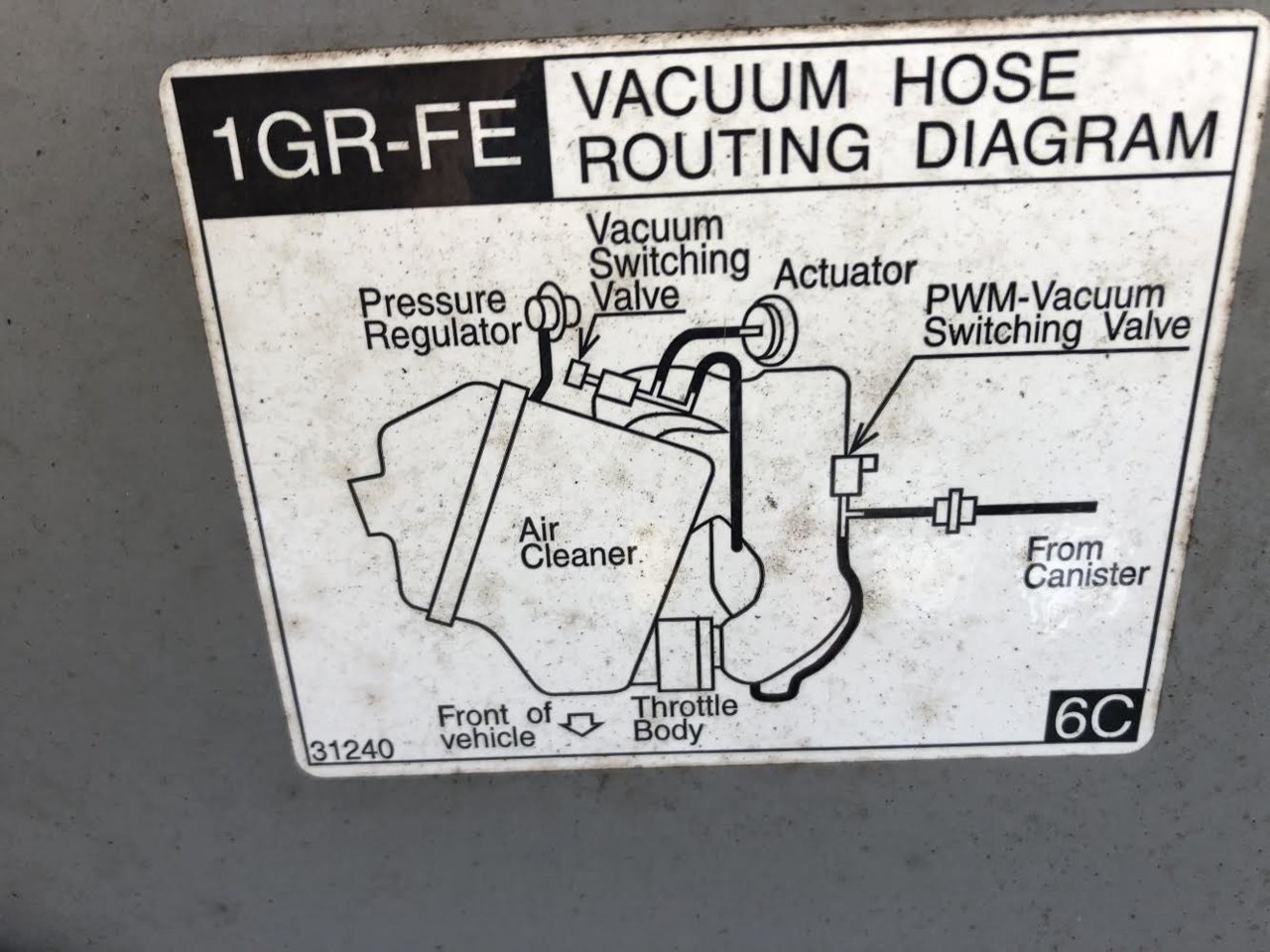

    Can anyone provide a diagram for the fuel and vacuum line's?
    My truck will not start. Very low fuel pressure.
    New pump installed, still very low fuel pressure.
    No signs of leaks.

    If it’s the 4.0, here’s is the vacuum diagram from my 2007.
    retardrabbit and BassAckwards like this.

    I do have other issues, I was looking for vacuum line diagram so I could confirm the locations.
    I have a constant humming noise when I turn the key to the on position. The pump does not engage. The pump does work, I confirmed by direct wiring it.
    I also got a pic of a friends Tacoma to verify the fuel line connections.

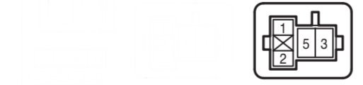

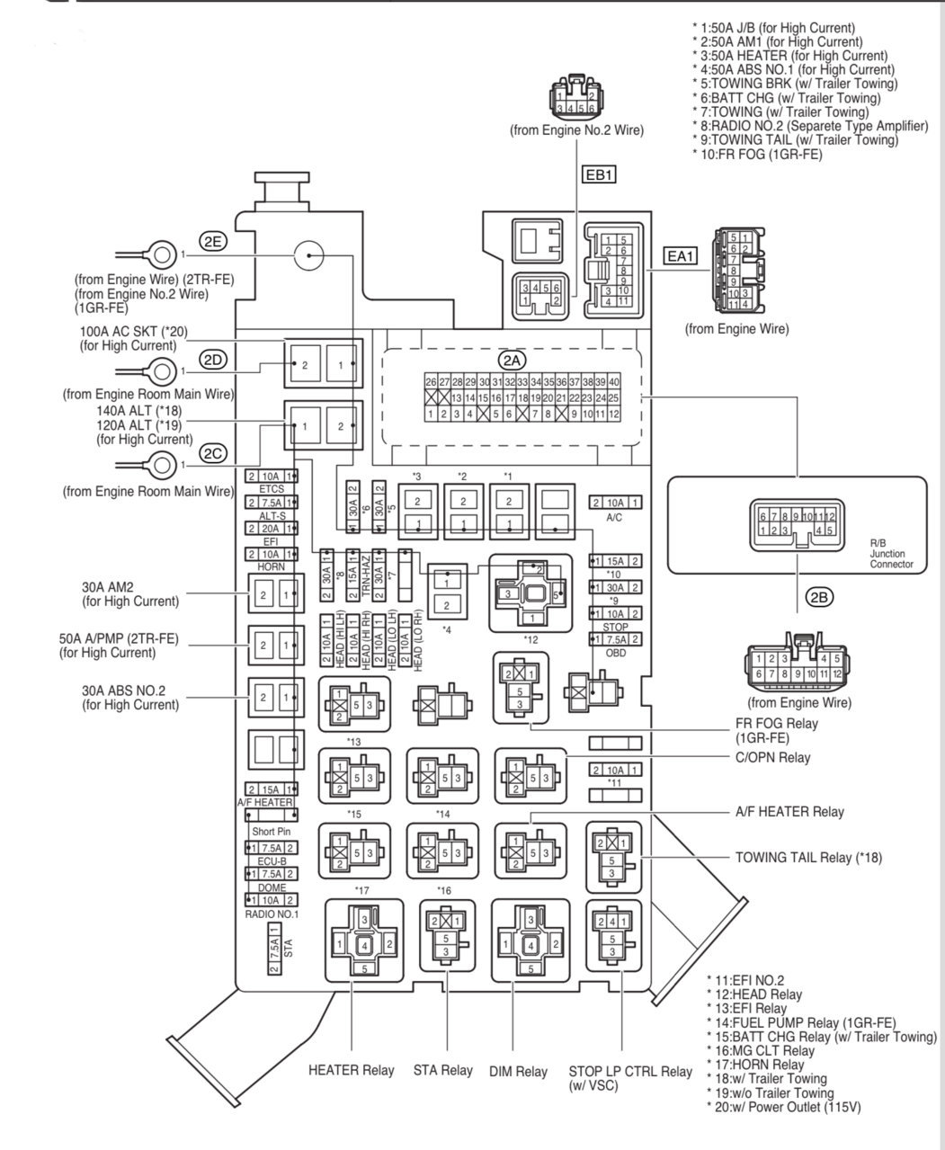

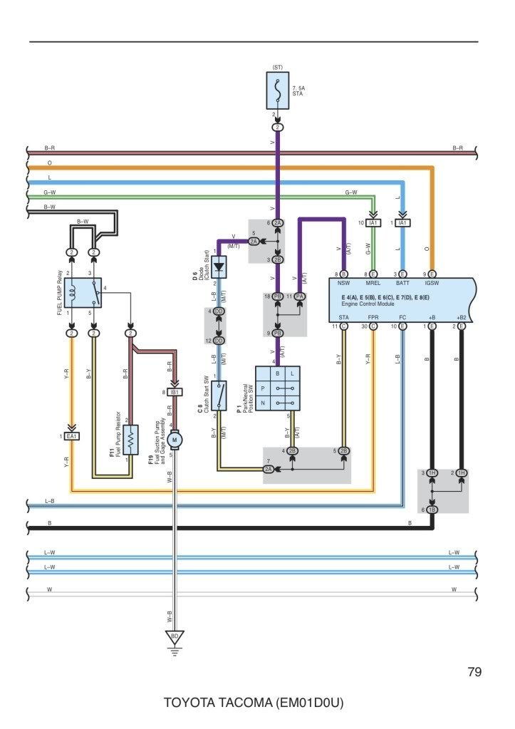

    The Fuel pump Relay gets all of it power from the C/Opn Relay.
    This means that Relay control, feed, and The fuel pump both get power from the C/OPN.
    The ECM grounds the Fuel Pump Relay.
    When you pull the Fuel Pump relay
    Do you have power to pins #2 and #3
    And a Ground to pin #1?
    I pulled this pic from the link below.
    https://www.tacomaworld.com/threads/wiring-diagram-for-fuel-pump.159486/
    There lots of good in for in that post, you may want to look over it.

  12. Nov 5, 2020 at 4:21 PM
    Tacoma03_Low
    Tacoma03_Low [OP] Member
    Mar 9, 2020
    #321650
    20
    No ground to pin 1
    12 v to pin 2 and pin 5
    0 volt to pin 3
  13. Nov 5, 2020 at 4:33 PM

  14. Nov 5, 2020 at 7:48 PM
    Jimmyh
    Jimmyh Well-Known Member
    May 16, 2012
    #78991
    14,203
    SC
    2012 Prerunner SR5
    @Tacoma03_Low
    I agree with TnShooter what you stated makes no sense. If you have power to pin 2 you should have power to pin 3. The only way to get power to pin #5 is from pin # 3.

  15. Nov 7, 2020 at 10:47 AM
    Tacoma03_Low
    Mar 9, 2020
    #321650
    20
    No power to pin 3
    Pin 2 and 5 read 12.44 Volts
    Constant humming noise when the key is turned.
    Remove either the efi 20 amp fuse or the efi relay and the humming noise goes away.
    Remove EFI #2 fuse (10 Amp) and the noise remains.

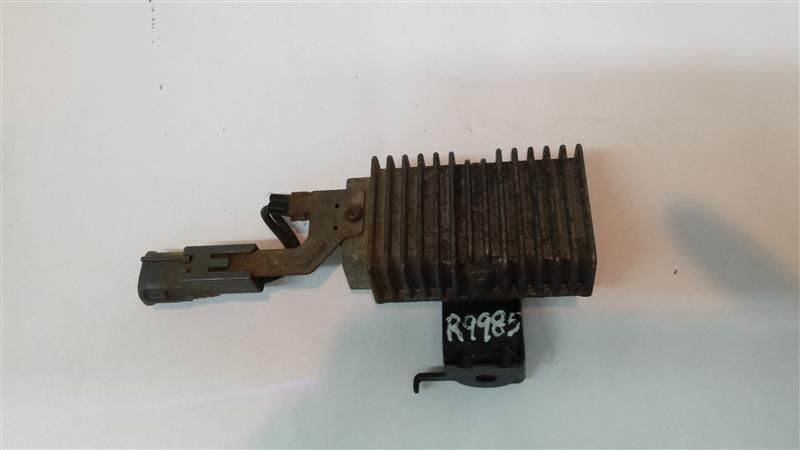

  16. Nov 7, 2020 at 7:46 PM
    #16
    Jimmyh
    May 16, 2012
    #78991
    14,203
    SC
    2012 Prerunner SR5
    Unplug the Fuel Pump Resistor in front of the Battery and then take the readings again with it unplugged.
    TnShooter likes this.

  19. Nov 8, 2020 at 11:52 AM
    #19
    Tacoma03_Low
    Mar 9, 2020
    #321650
    20
    same readings with it unplugged
    Humming noise is still there also.
  20. Nov 9, 2020 at 2:41 AM
    #20
    Jimmyh
    May 16, 2012
    #78991
    14,203
    SC
    2012 Prerunner SR5
    Well I'm really stumped now as with the Resistor unplugged there is nothing connected to terminal 5 of the relay.
