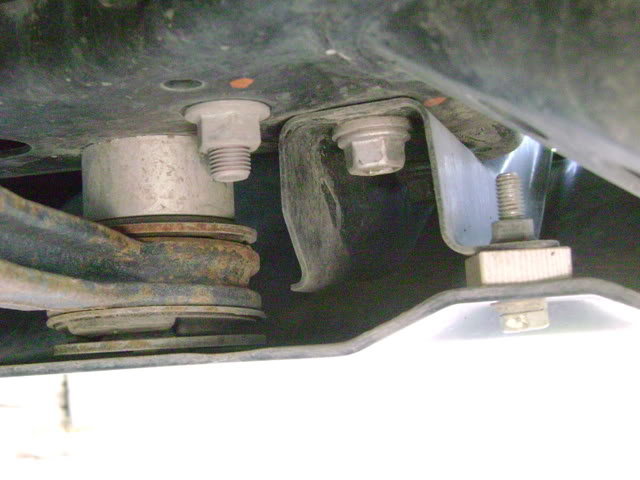

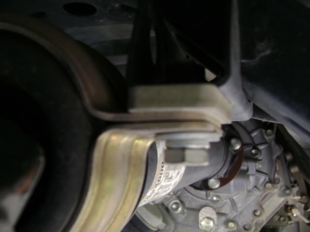

    They have some shims that are supposed to correct this. The drop your front diff as well as your hanger bearing and shim your rear diff. It is supposed to keep your driveshaft inline.
    Front diff and skid drop
    hanger bearing
    I have a block and the shim to degree the rear diff

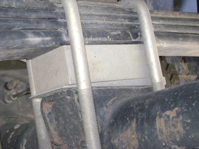

    I had 2" angled block's in the rear, dropped the carrier baring and dropped the diff, and the vibes were still there. Today I took the blocks off and the carrier baring spacer and drove it, still vibrated, so I took off the front spacers and everything else and the vibs stopped. I have heard of many people having these problems but no real solutions, I think I will try the toytec lift if people have been happy with it.
