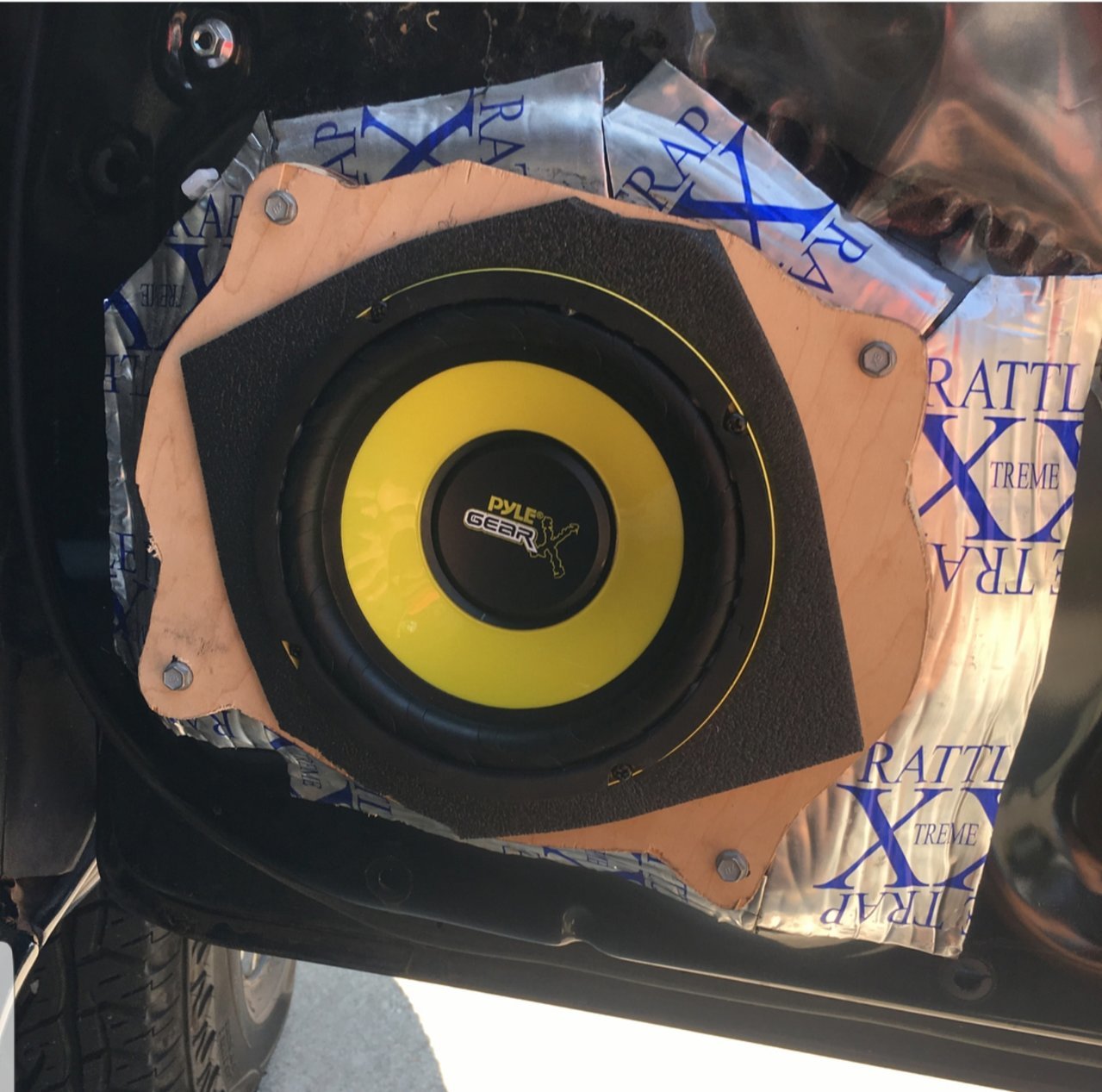

    Here is a shot of the pyle 6.5 plg64 speakers and the wood adapters I made, they work great and as you can see ive used sound deadener, an xtc 6.5 baffle with the bottom half cut away per info from here. Id love to replace these 6.5's with the speakers in the link above IF its possible or ill just stick to buying 6.5 components JUST for the 6.5 mid bass drivers since my midrange and up is covered.

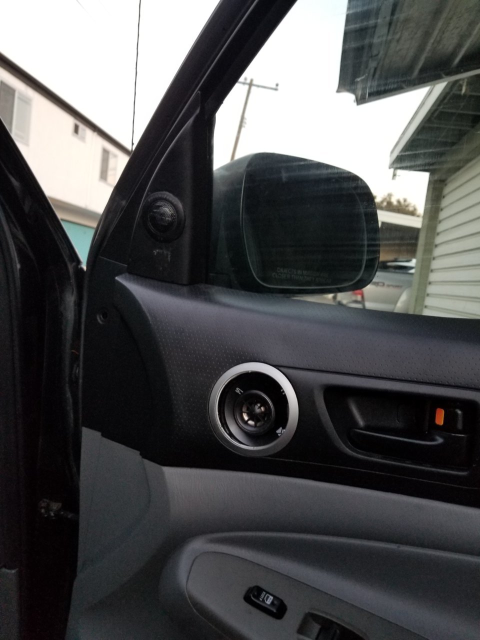

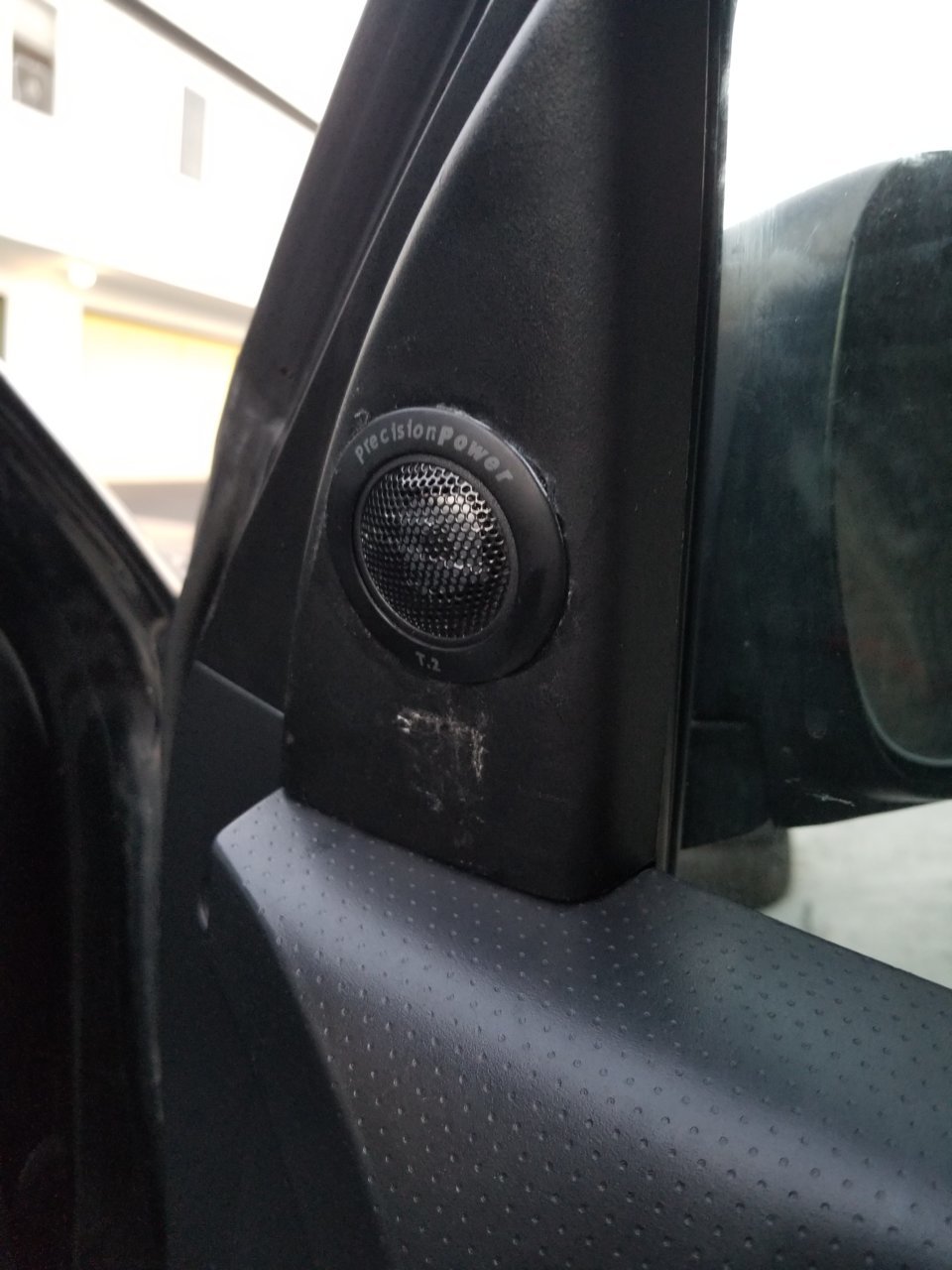

    And here is a quick shot of the kicker 3.5 speakers in the stock tweeter locations...yes the grills do snap back into place w/o hitting the speaker. Also a pic of my new ppi t.2 tweeters flush mounted in the sail panels. (Disregard the stuff below the tweeter its double sided tape residue that has since been cleaned off)

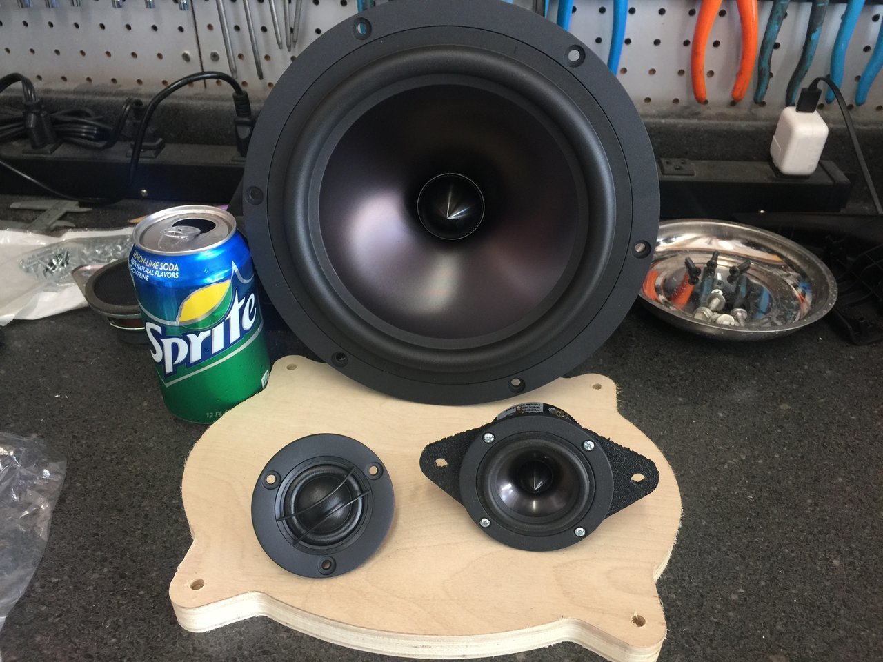

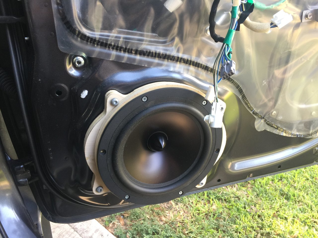

    I managed to stuff a pair of 8” Dayton’s in my doors. Took a couple of birch rings to make it happen, but it can be done.
    https://www.tacomaworld.com/threads/loginfaileds-stolen-idea-emporium-plus-bs.520767/
    8EC2C529-66FB-401B-A5E9-7F36A86EF8FF.jpg 1DDD5FB9-2495-4F4A-A214-29CFA5F23721.jpg
    Look closely there’s a 1/2” thick 6”x9” adapter plate and then on top of that there’s another 1/2” thick 8” spacer on top of that.
    These Daytons really kick. Almost don’t even need a sub, unless you’re a bass head like I am.

    Two rings it to get the driver in the correct position. Partly to make the magnet clear the window. But more importantly to allow the door trim panel to be reinstalled. The speaker can’t be perfectly centered over the 6x9 hole. The second ring must be offset toward the bottom.
