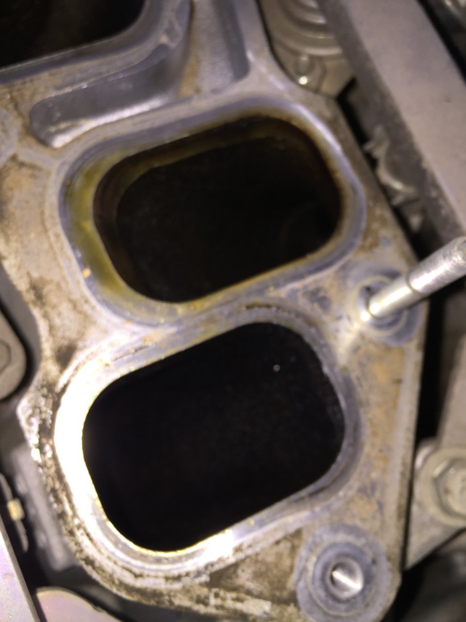

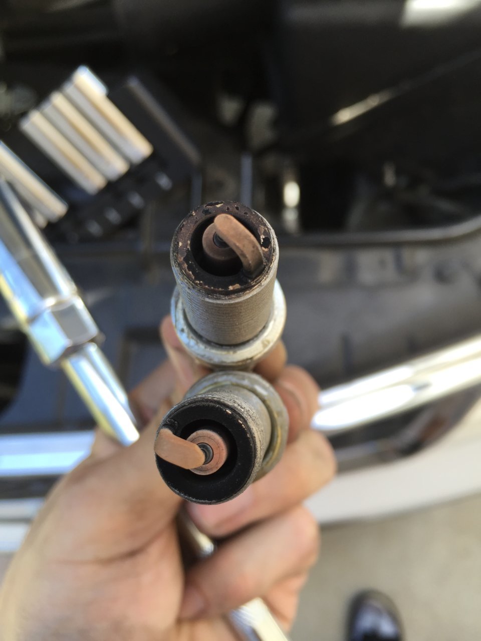

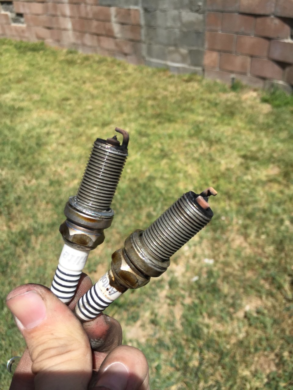

    Today I decided to look at it and I removed the intake manifold and found what looks like oil or jellied gas around the intake passage opening. The spark plugs looked ok, while one of the coil plugs looked burned.

    sounds like a head gasket. white smoke is usually water vapor, blueish smoke is oil. gap looks a little larger but i'd check that. Check your compression on your pistons, that will tell you if you have a leak--or blown head gasket. How many miles on it?

    Unless it was like -70° i dont think that gasoline had jellied. Can you tell if the coolant is low or is there oil in the top of the radiator (the radiator cap not the reservoir) is the oil milky?

    I've drained and refilled the coolant with water many times in my attempts to fix the engine with a sealer. The oil looks black and watery, and the oil level also went down but the smoke coming out isn't blue to indicate oil burning. I remember I had changed the oil not too long before It started acting up.
