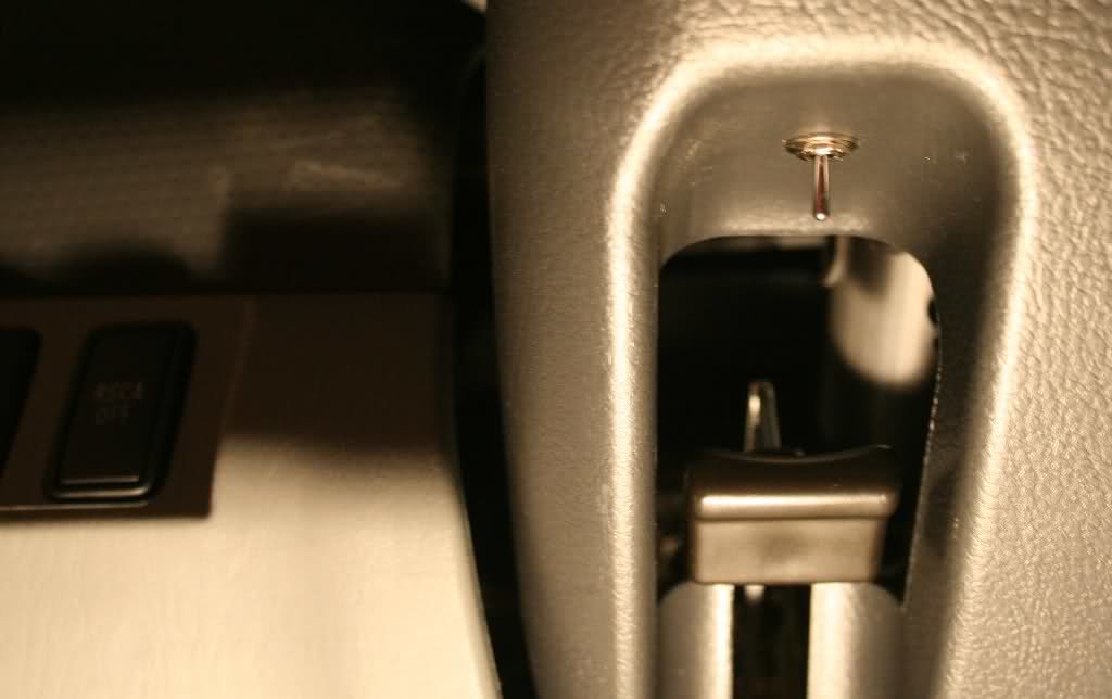

    Removed coin tray and find a suitable location for switch

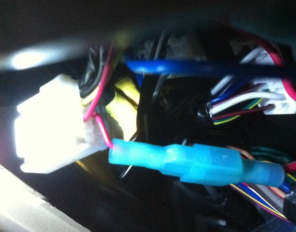

    Find connector IN1

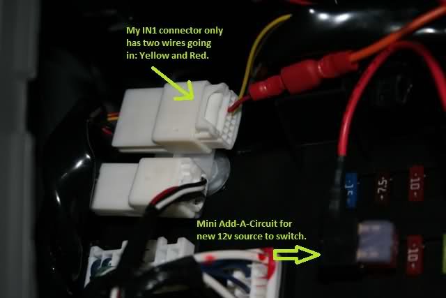

    Your connector may look different and have fewer wires in it!!! My connector is full because of the accessories (Bluetooth) that came with my truck from the factory.
    Find the Rev Wire pictured below OR See PIC ABOVE DEPENDING ON YOUR TRUCK'S ACCESSORIES.
    Remove factory insulation and cut the Rev wire and add slide connectors.

    If you use the same location for the switch, make your harness about 14" in length so you have ample wire, trim as necessary.
    Installed SPDT switch

    NOTE: Read the instructions that came with your Add-a-circuit. You can't simply select an empty fuse slot--it will have no power. You must choose a fuse to unseat and put the Add-a-circuit in there.

    Rear camera anytime switch, 4x4 Illuminated Switch (from rcbs204) , rear view mirror lift bracket (from ImMrYo), 75 cent tailgate anti-theft. Technically not mods but give me a break I'm trying to fill space here... OEM Leather pkg, keyless unlock & ACC chime silence, BakFlip G2, Ultra Gauge EM, WeatherTech floor mats, OEM roof rack
    Thanks for the good write-up, Crom. I'm all done my mod - just need to mount the switch. Everything works perfectly. :D
    I had only two wires going into IN1 (differences in truck accessories). The steps in Crom's write up are still correct. The red wire going into IN1 is the one you need to cut and wire up as he showed.

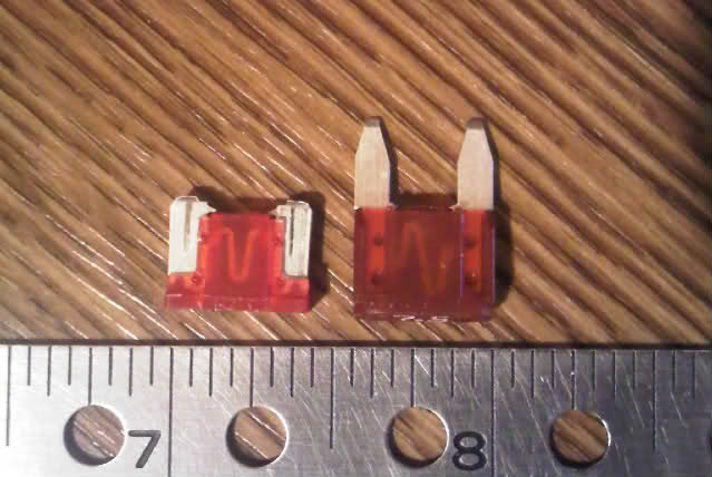

    For anyone confused about the fuse sizes...
    Low-profile mini fuse (left), regular mini fuse (right).
    The regular minis will fit fine in the low-profile mini slots in the truck.

    Finally got the switch mounted. Good idea on the location, Crom..
