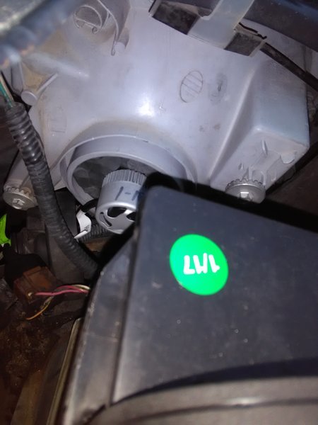

    Im guessing this is on a sticky or a how to thread, no prob just direct me. anyhow heres the pickle my new led headlamps have a big honkin housing for their transformer, circuits, cooling fins and fan thus i cant get the rubber boot round the lamp and even if i did id have to figure out how not to cover or impede air flow to the fins or fan. Has any one made a aftermarket boot or is their a clever way of insulating humidity or water from getting in the Toyo lamp housing like it came from factory ?

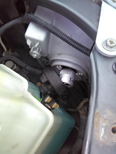

    cliped the new leds in with no boot and i could see air gaps where water and moisture can creep into the housing foging up and wearing out the leds prematurely. so.....

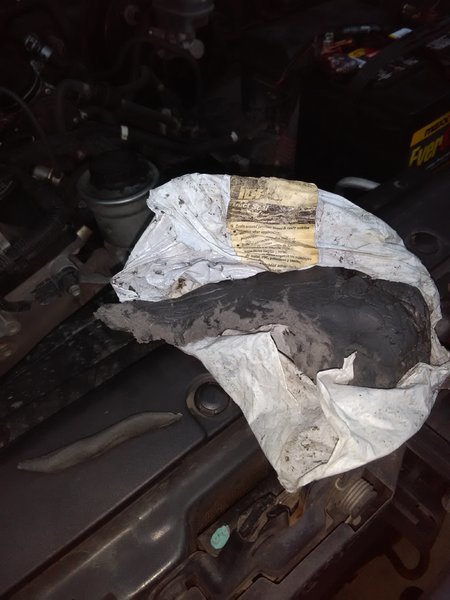

    I broke out some Ideal Elecrical Duct Seal I had laying in my tool box its esentialy playdoh for electrical boxes to keep moisure out of electrical boxes and the penetrations behind or near them. think- another form of silicone or foam but this stuff is like playdoh you can form it how you need it its water, sun & freeze proof & non conductive or toxic holds its shape for years. i rolled some pieces and wrapped around te paperclip area careful not to cover any fins or fans, done. That was my idea again i had it laying around if theres a better way please let me know.

    @tacotruck 2.7 bought some of the duct seal and it worked great. Awesome idea!
