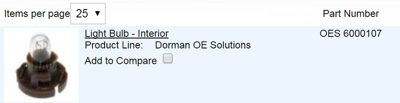

    NAPA stores #600-0107
    3$ a bulb:

    One of my HVAC switch lights went out last week, and I stumbled on this thread. Yesterday I verified that the Dorman bulb described in the post above (Napa part number 6000107) is plug and play for my 05' TRD. Worked flawlessly. Thanks, jesseunvoas.
