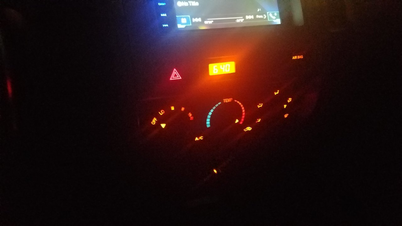

    Bringing up an old thread. Just to clear up some of the confession I see online a 2nd Gen Tacoma uses two T4 bulbs. I went with LED warm white. You would not know the difference unless I told you. Perfectly matched the instrument panel.
    These are from Superbrightled.com. NEOx

    I also want to confirm that these are the right bulbs. I just installed them and they’re perfect.
    Edit: Actually I’m not totally satisfied with these bulbs. They’re bright and give the perfect color but they don’t illuminate the panel evenly. At night it’s completely fine but at dusk or early morning before sunrise it’s more apparent. I’m going to get these incandescent bulbs from Amazon people have been linking to. As others have mentioned, incandescent bulbs give more of a spread which I think bathes the hvac panel in light better.
    Compatible Dash Light Bulb Kit for Toyota Tacoma Heater A/c Climate Control (Set of 2 Bulbs) https://www.amazon.com/dp/B00CMFF1AA/ref=cm_sw_r_cp_api_i_TBq5Db9ACXFRQ
