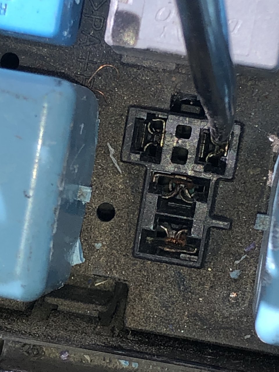

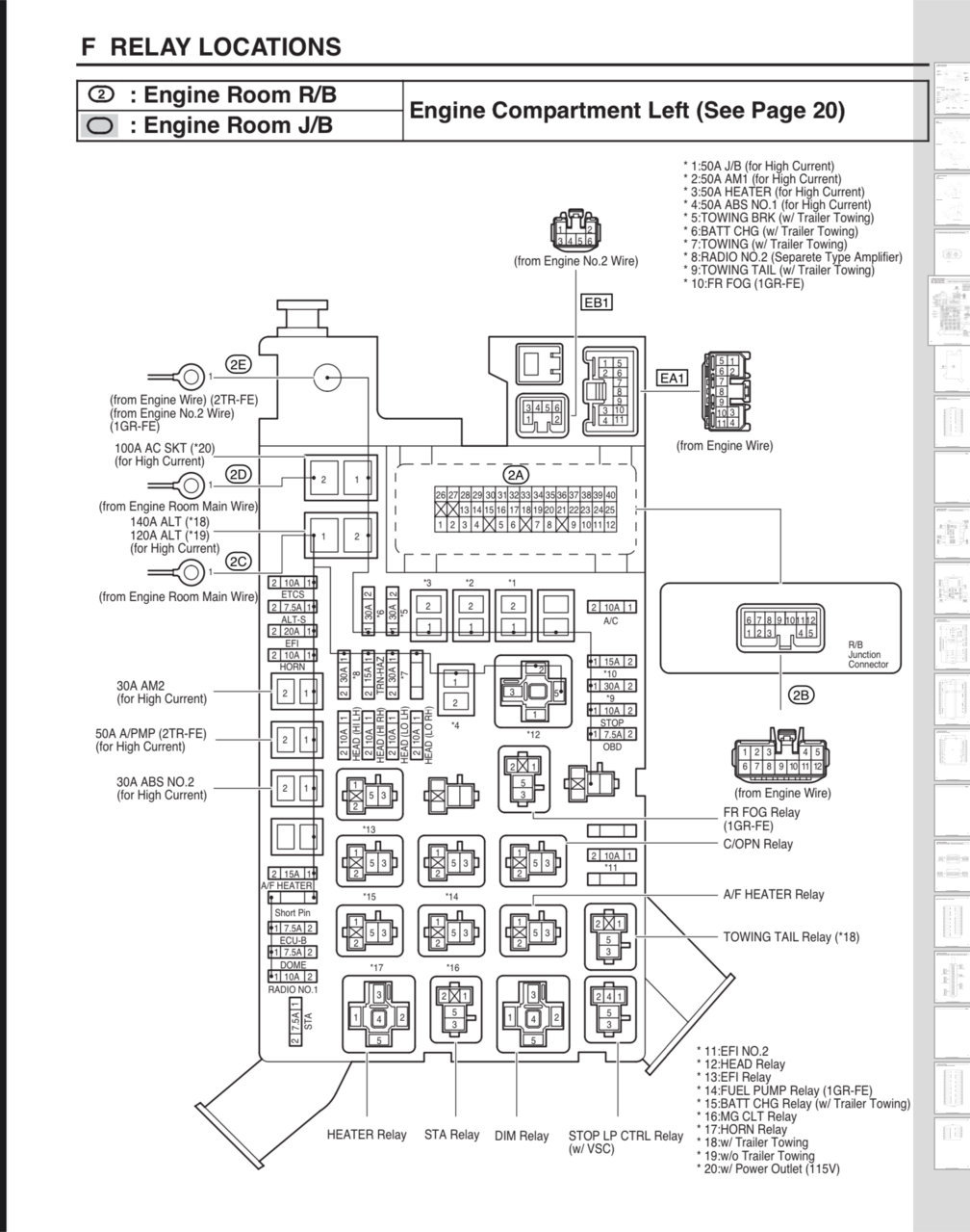

    Ok. Purple wire has power to sta 7.5 to neutral switch This wire has no power does anybody know what color of wire and where is coming from thank u9083643B-87C8-46AA-A1C2-94E698C1107F.jpg25D5074F-E12C-4AB2-82A9-F5605E9F1475.jpg

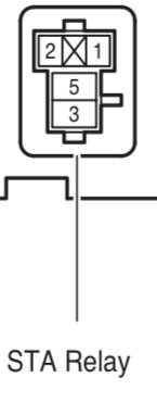

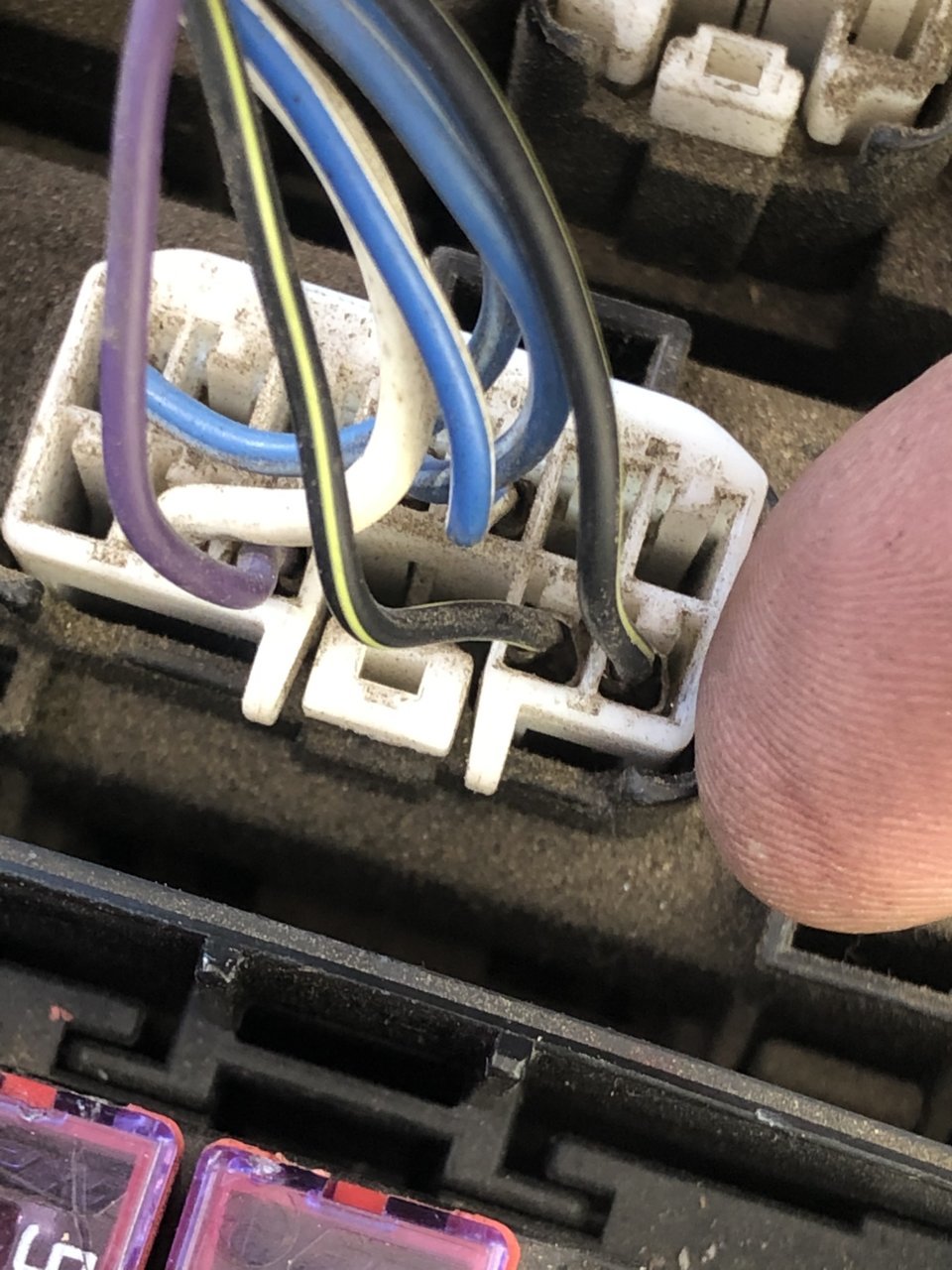

    5941D0D2-821E-45F0-9A0C-69E5BD29FA62.jpg Well narrow it down. No power from this cable from neutral switch to fuse box. Purple wire has power feeding the nuetral switch

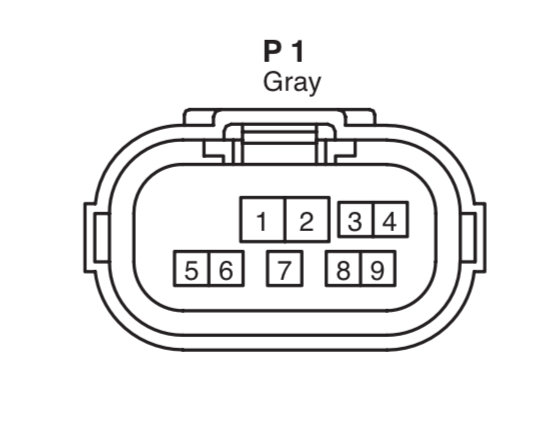

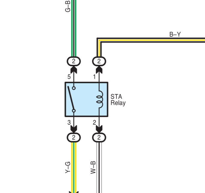

    That should be the Black/Yellow wire coming from the Safety Switch.
    Pins #5 and #1 should have power when cranking.
    #5 is powered by the Ignition Switch. It gets power from the 30AM2 Fuse.
    #1 is powered by the 7.5A STA fuse. But it HAS TO GOT THROUGH THE SAFETY SWITCH FIRST.
    At this point you have a Bad Safety Switch or Bad wiring, or an improperly adjusted Safety Switch.

    Thank you tacomaworld for all the leads. After the leads i received . I found the black/yellow wire coming from neutral switch to Starter relay #1 slot got broken when they removed or installed the transmission. Somehow they forgot to disconnect the harness. Thats what happened. Thanks to all that help out.
