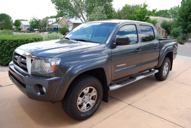

    I thought it was about time to start a build thread since the mods are adding up!
    I have a 2009 Double Cab Short Bed MGM offroad prerunner V6
    I named her Stormshadow because of her MGM color :D

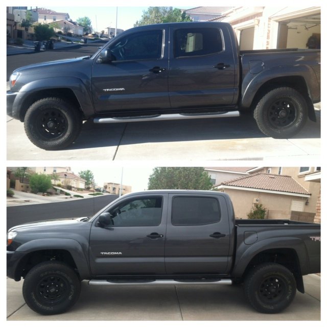

    Before and after my "lift"
    although I have a complete OME kit with 885x coils, trim packer and Dakar springs I dont sit to much higher than a stock tacoma. I'm gonna add top plate spacers later.
    Pre lift numbers were:
    Hub to top of fender
    Driver front 20 1/4 inches
    Passenger front 20 1/2 inches
    passenger rear 22 1/2 inches
    Driver Rear 22 inches
    Post Lift Numbers:
    Driver Front 23 inches
    Passenger Front 23 inches
    Passenger Rear 25 inches
    Driver Rear 24 1/2 inches (with 3/4 full gas tank)

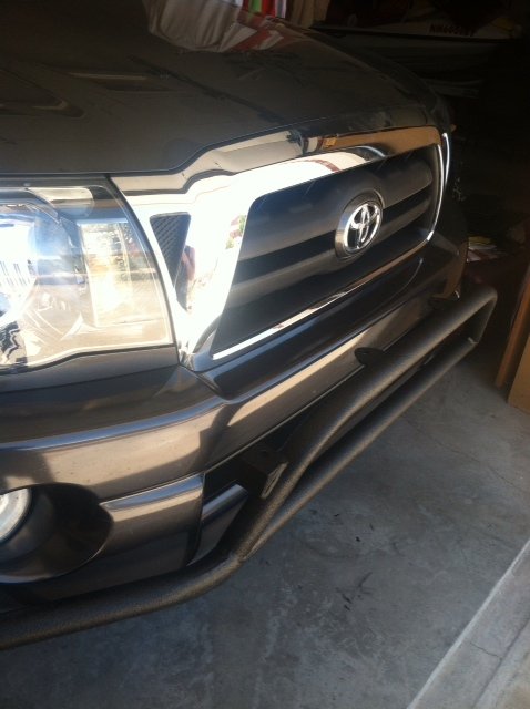

    Avid light bar with line-x
    you can also see the plastidip grille in the photo. I just plastidipped the bars and where the "oval" center is I left stock for a bit of difference (ill get a better picture later)

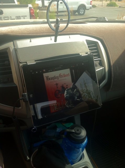

    Jerry-rigged Ipad mount
    I took out my stereo and tied some 550 paracord that i had laying around
    I leave it on the charger so itll turn on when i start the truck and have the audio through the aux port for the stock stereo.
    I am really wanting to get a Soundman Car Audio slider mount to use a Bluetooth wireless 2 channel kit to use my ipad with an aftermarket headunit
