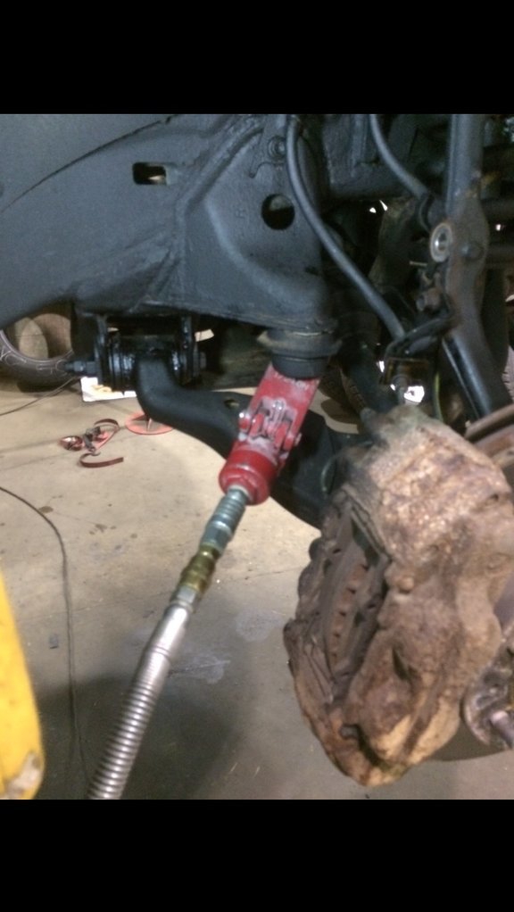

    Loosening the 2 cam bolts on the lower control arm bolts will work and make it alot easier. Just mark the location of the cam bolts.
    I did this when I first installed the 5100s. The biggest problem I had was realigning the cam bolts because of the amount of torque it took to spin them back into place.

    What is the torque rating for those bolts? So basically I put a paint line on the bolt and washer and just loosen the bolts causing the lower control arm to move down... I have a breaker bar but I just want to make sure I don't do any damage to the bushings or bolts. You guys have been very helpful

    ^No. The amount of lift varies depending on the strut model. The one for the Tacoma is fixed at 2" lift.
    The damping is adjustable with the knob at the bottom, though I'm not sure how much of a change it actually gives when driving off-road.
    Make sure the paint line extends to the frame. The washer may very well spin with the bolt when you turn it. Torque spec is 100 ft-lb.

    Careful not to rip your brake lines though

    I used an impact on mine to crack em loose
