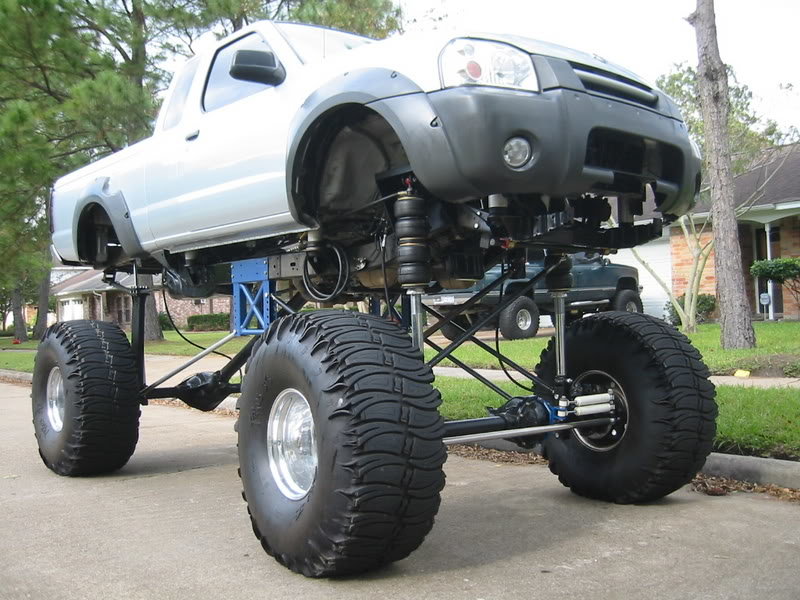

    dont forget that blocks can break

    ^^^Nice jack!^^^
