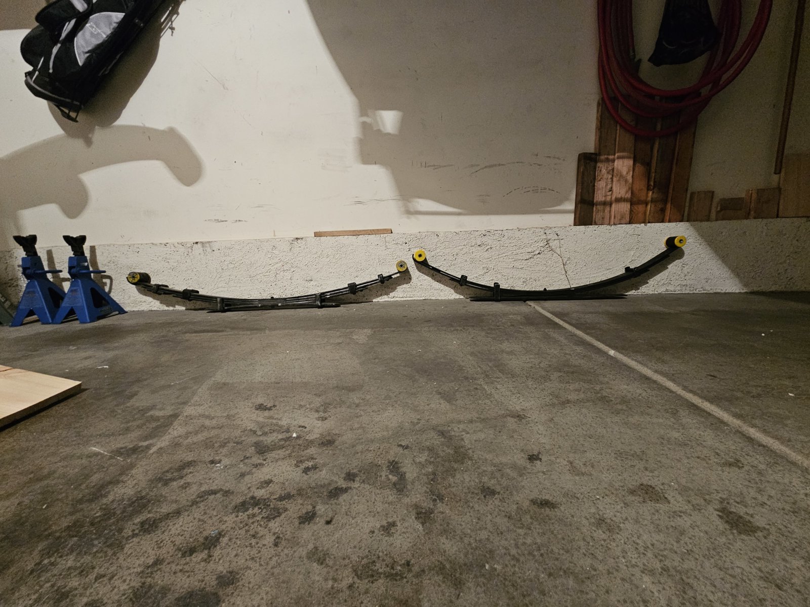

    Further update: I started to notice some minor rear sag and I did not like that the blocks merely served to level across the rear. Also, my drivers rear shock was compressed 3/4" more than the passenger rear shock despite being level across the rear due to the unequal blocks.
    I went radical and installed General Spring HD leaf, reported 1.5" lift, ONLY on the drivers side. I replaced the rubber bushings it comes with, to OME poly bushings. I installed a 1" block on the passenger side to the stock takeoff spring i bought, to balance the rear height across.
    The overall rear height went up over an inch, which will settle some.
    So far, so good and it rides smoother.
    I have a steel gas tank skid, which means a full tank is 200 lbs. more on the drivers rear, so the goal was to get more spring where it was needed.
    A small add a leaf will probably replace the passenger rear block once things settle and I can measure the results.
    Experimentation
  16. Mar 22, 2024 at 8:30 PM
    #16
    Mrcooperou812
    Mrcooperou812 [OP] Well-Known Member
    Nov 26, 2023
    #438257
    460
    Las Vegas NV
    2016 DCSB OR 4WD
    Stock leaf next to Skyjacker 2" rear lift leaf. Both 3+1. Tomorrow I am installing this to the drivers side and relocating the General Spring HD 1.5" lift leaf to the passenger side. No blocks or AAL now. Both GS and SJ let you buy 1 leaf instead of a pair. Thus, adjust rear lean by spring like up front.
  17. Mar 22, 2024 at 8:32 PM
    #17
    boston23
    boston23 Well-Known Member
    Sep 4, 2019
    #304290
    3,752
    Adam
    Eastie
    2019 SR5 DCSB 4x4
    Just try bumping up a perch or 2
  18. Mar 22, 2024 at 8:45 PM
    #18
    Mrcooperou812
    Nov 26, 2023
    #438257
    460
    Las Vegas NV
    2016 DCSB OR 4WD

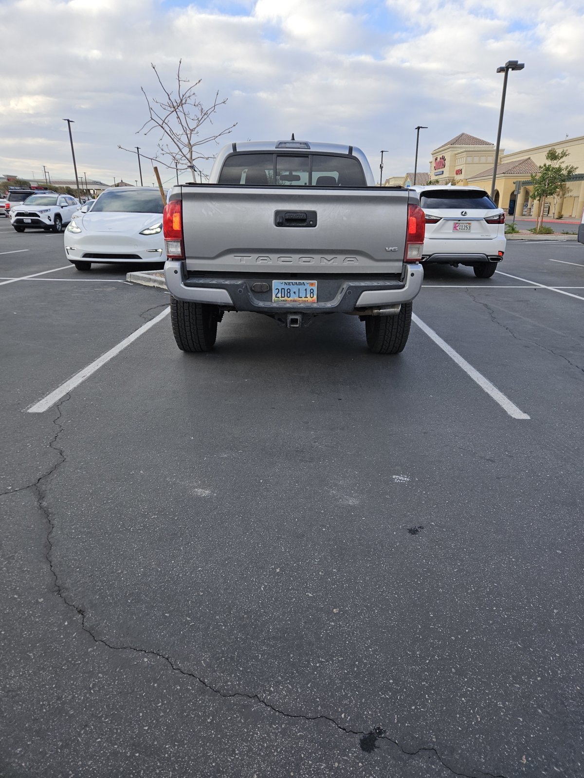

    I tried 2 up front but driver rear still sagged below passenger rear after 2 weeks. A Toyota half inch block in there worked.
    boston23[QUOTED] likes this.
  19. Mar 23, 2024 at 5:51 PM
    #19
    Mrcooperou812
    Nov 26, 2023
    #438257
    460
    Las Vegas NV
    2016 DCSB OR 4WD
    It worked. Less than 1/4" difference across the rear. Will see how it settles over the week.
