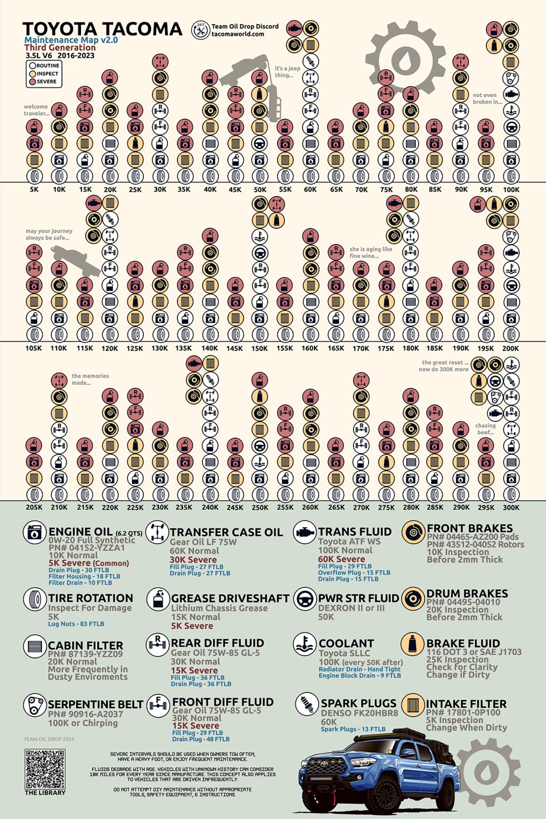

    The intent is for the end-user to laminate it and use a fine-point marker to track DIY tasks. They may opt to jot down mileage for when the task was last completed or when it is next due. If you don't want to deal with printing, or framing, or just want to support what I do, we have it in the channel shop in all the high def colors as well as in fillable digital PDF version. Enjoy!
    Maintenance Maps
    Below are the 0-100k & 100k-300k mileage maps of routine maintenance (for the 3.5 V6) scheduled out in an easy-to-follow format. Within the first PDF version you'll find links to concise videos on how to perform these tasks. If you don't want to deal with printing, or framing, or just want to support what I do, we have it in the channel shop in the version 2 as well as the original style.

    Add the part # for the crush washer under blue triangle

    man I do love me some crush washer PNs. I'll add them for the diffs crush and non crush washers as well in my next round of edits. Add: and transfer case, tansmission pan, etc. I'll make the whole pic a bit bigger by then but worth it.

    Really not looking forward to my 60k here soon. Guess ill be doing it myself. I cant imagine the cost at the dealer for all that.

    Only thing “difficult” is spark plugs. But still super DIY manageable. Sending you a dm.

    nice , isnt pcv valve an overlooked maintenance item as well?

    It is, and it's been on my to-do list to make a diy vid on!

    I know a few TRD-OR engineering execs. I will pass along your outstanding work.
    Consider adding wrench/socket size?
