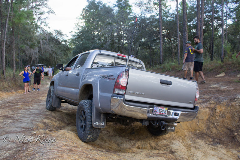

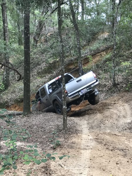

    Haven't damaged mine yet in 2 years downloadfile-8.jpg 30319573331_20bfc6c162_k.jpg
    Edit: to clarify. Pictures are with a 2" aal. Ran a year with a 1 inch block prior. Your stock leafs will droop about an inch further than your shocks from the factory. Don't believe me? Pull your shocks after lifting your truck by the frame. They top out. Which is the same with my billies. The aal didn't change the length of my leafs.
