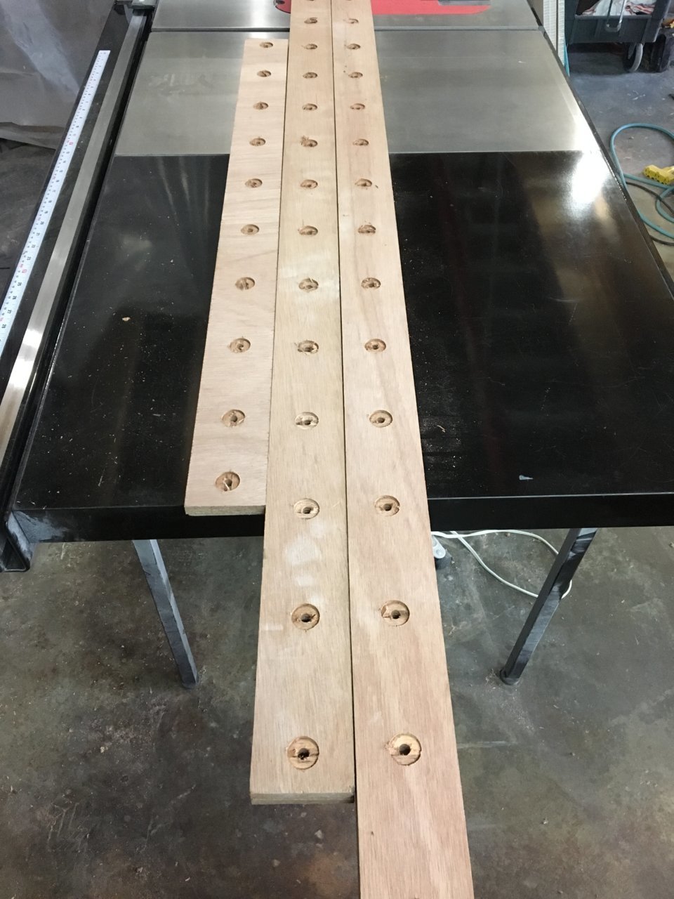

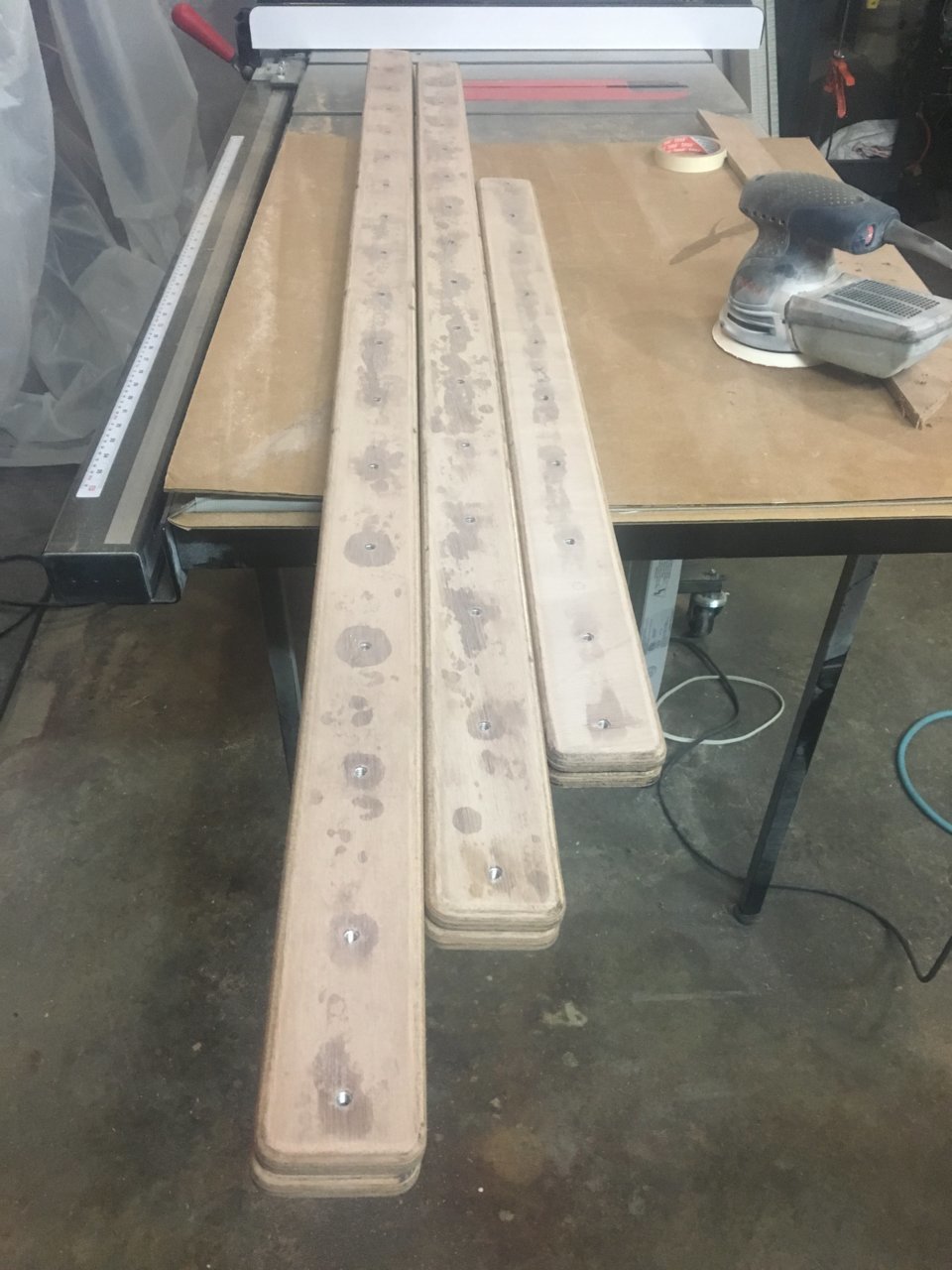

    Got all of the L Track backer plates drilled and ready for t nuts and routing.
    Will probably get on this again tonight...or this weekend. I feel the momentum and I’d like to get these mounted on the camper!

    T nuts in place!
    Who knows, I may actually get a set of these backer boards epoxied in place this weekend! That would be sweet.

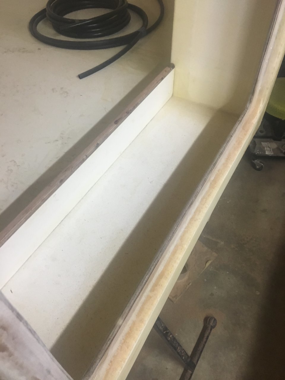

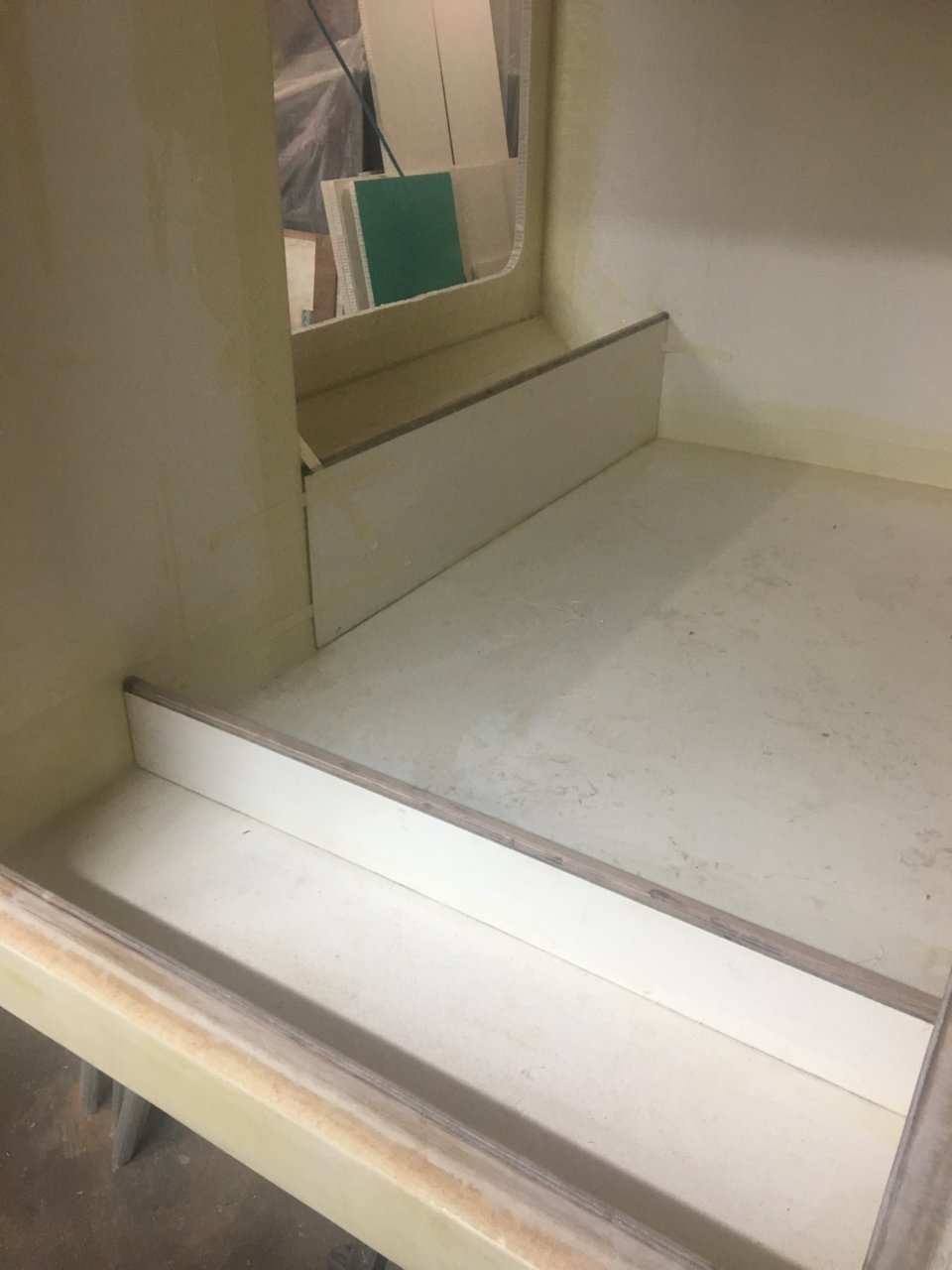

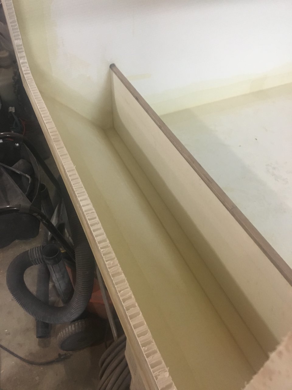

    Got after the ‘ol camper again tonight.
    Both stub walls are epoxied in place.
    This short wall by the side door creates a nice sealed area for shoes and keeps mud/water/dirt/sand away from the mattress. At least that’s the hope!
    This taller wall by the back window is just a ‘space’ for ‘stuff’. This is likely where our backpacks and jackets will be tossed. I thought about enclosing this with a hatch or two on top but decided that would greatly reduce the utility. As I said way back, “As soon as you define an enclosed space, you want to put something in it that’s too big”. Now I don’t really have to worry much about that.
    I also sanded the backer plates for the L Track. Routed the top edges as well.
    I’m trying to be efficient with what I’m working on but I seem to sort of float around doing various bits here and there. I REALLY need to get on finishing the door and mounting the camper mount blocks to the flatbed. I want to get that last one done before it turns rainy next week. I’d at least like to get all the holes drilled. That feels a little more realistic. Haha.

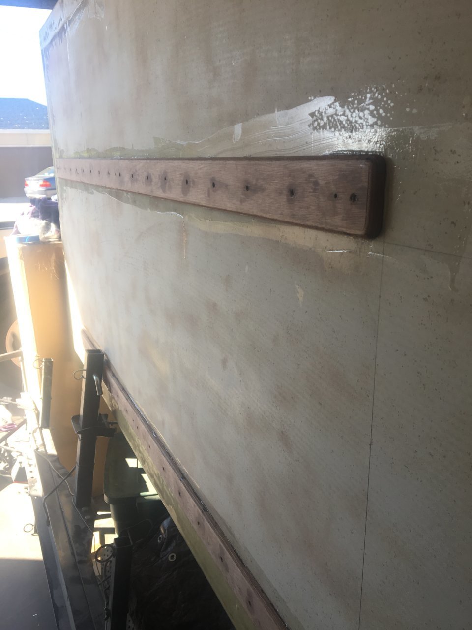

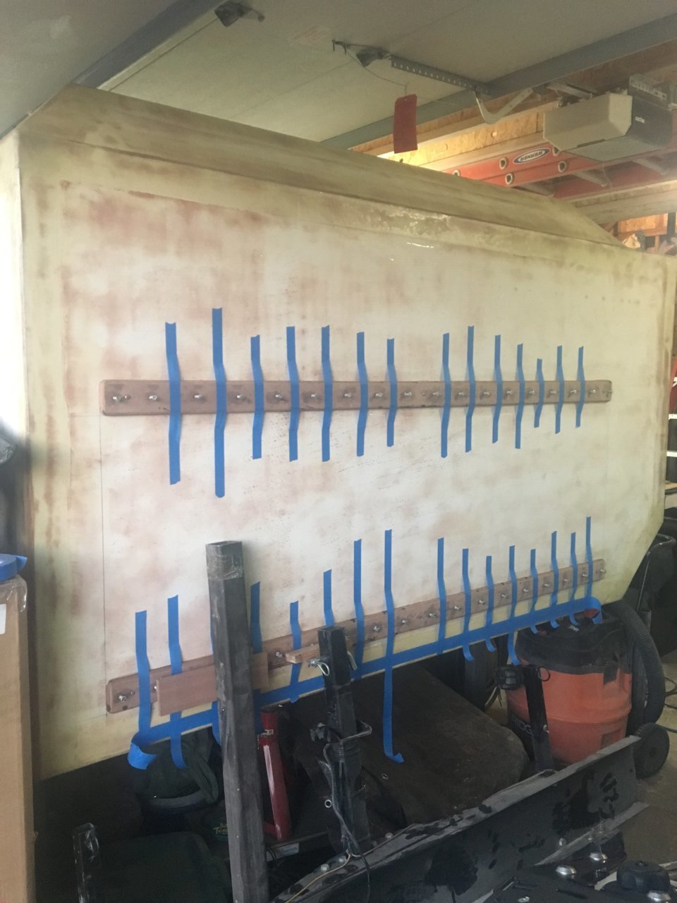

    Bit by bit...
    First set of mounting boards for the L Track are epoxied on the camper. Process was pretty easy. I might be able to get the other two sets on tonight unless we decide to go to a movie.
    Lots of cleaning/sanding then I’ll fillets the edges and start glassing them in.

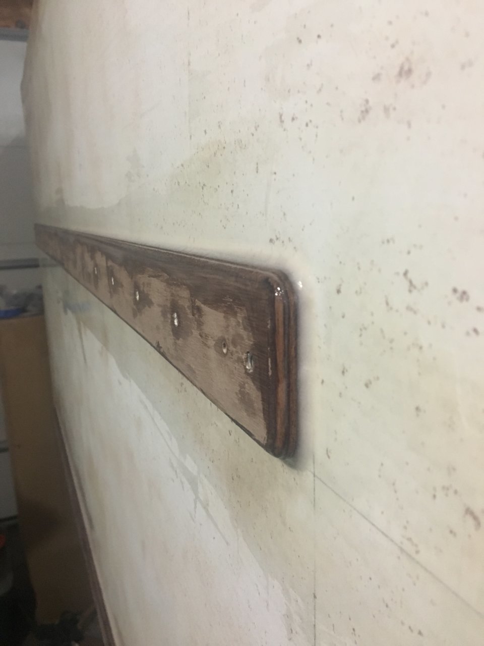

    Another tiny trickle of progress.

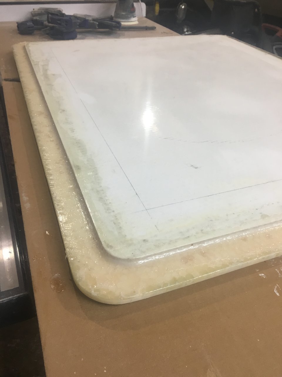

    I never spent too much time considering how much squish is ideal for a bulb seal. Turns out 50% is a good max squish to shoot for. Well, I didn’t have enough clearance so I made some. I routed out the back of the door and epoxy filled the core material. I’ll glass over this soon.
    I also laid in the epoxy fillets around the two L Track mounting plates. Glass coming for those as well.
    Sloooooowly but surely.
