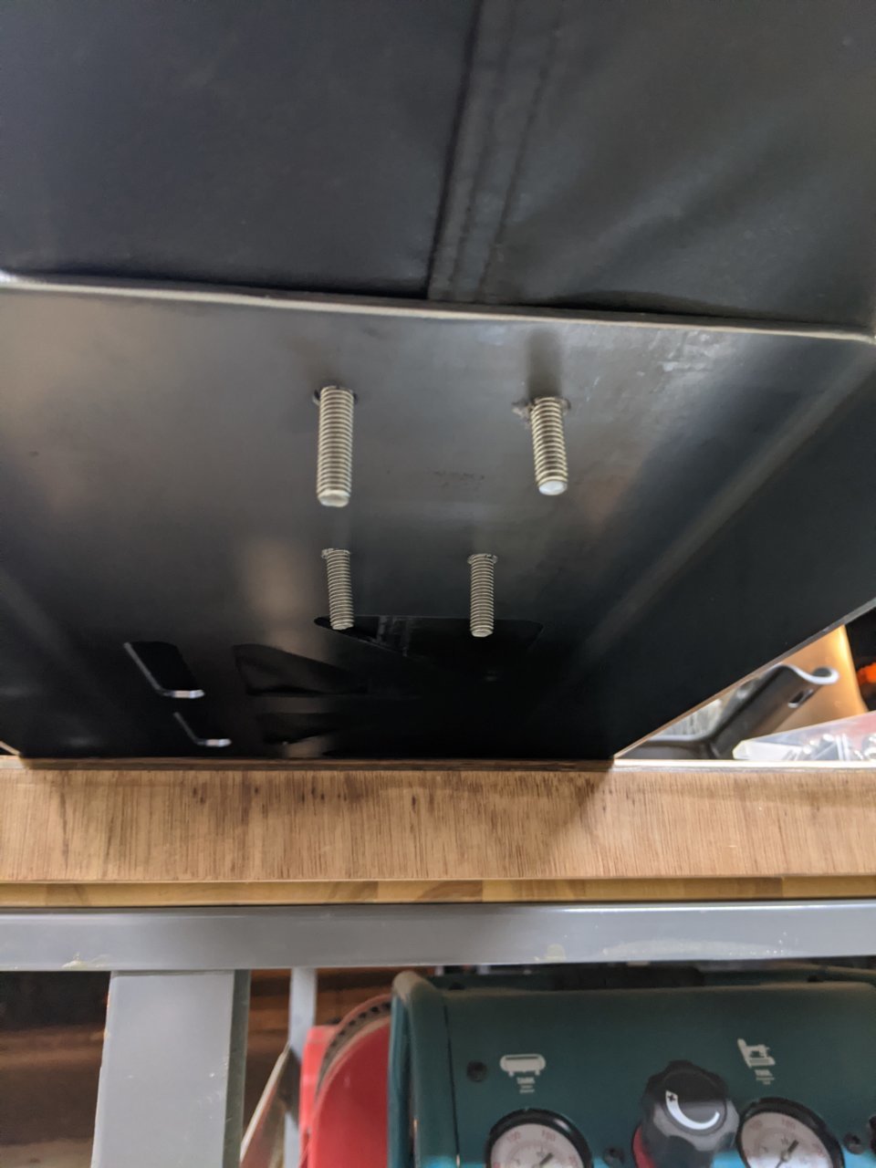

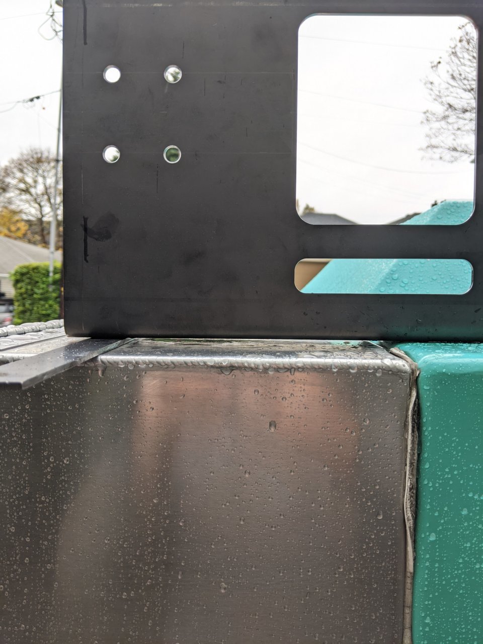

    So, I was sitting around watching people work really hard (AKA, crossfit games), and decided that I was bored. So I came out into the garage and knocked out a tiny part of the awning project that I was micro stressing about.
    I drilled the mounting holes in the cover and dropped the awning onto the mount. Miraculously, all the holes line up! And these bolts are a tight fit in the holes. :thumbsup: I definitely overthink stuff like this. It's going to be hard to do it right and not have the cover all twisted and janky and none of the holes are going to line up...:sadviolin: Yeah, no, this is 1BC were talking about! That shits lining up fo sho! :rofl:
    Took all of about 10 minutes. Nice to have that done. Next dry day when I'm home, I'll finish up all the test fit and mockup then get it out for powdercoat! I'm planning to do some more weight reduction on this giant awning mount this weekend. It's always going to be much heavier than it needs to be but it doesn't need to be this out of hand.

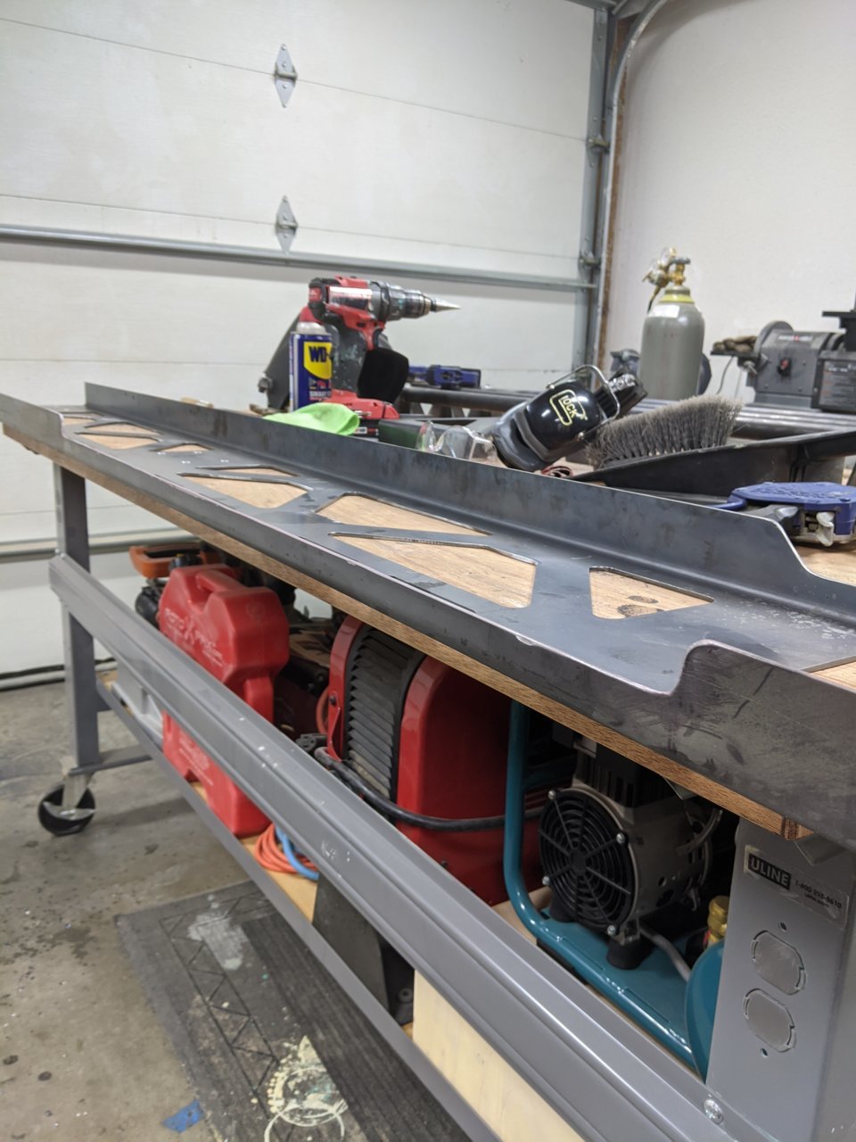

    Another good morning. Slow to start as usual when it's cold and wet outside but that's okay.

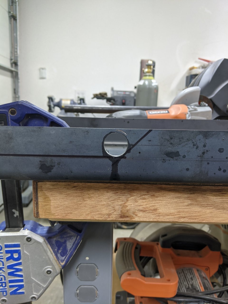

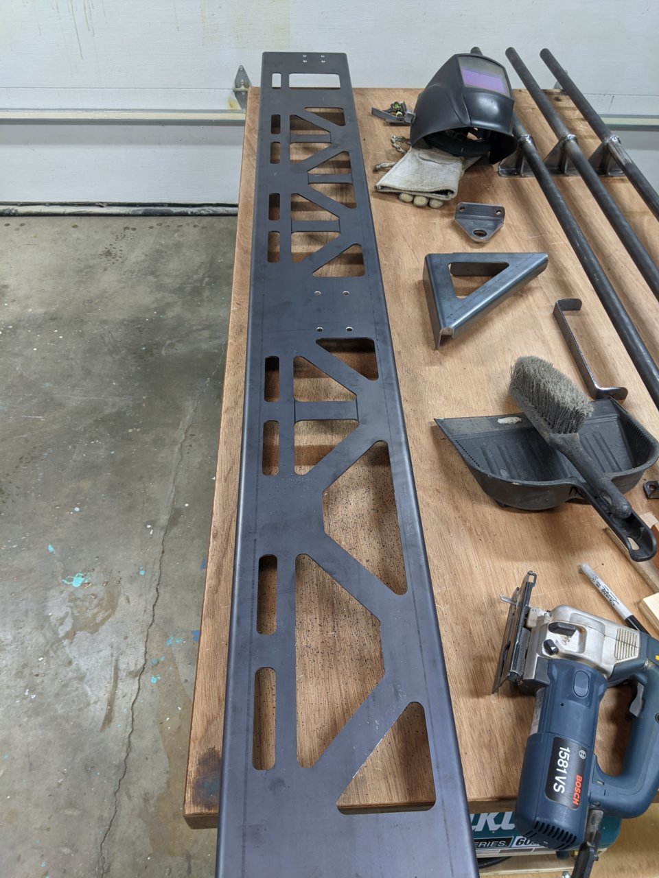

    Cut out all of the vertical braces on the awning mount. Here the closest one is cut out and the others are marked.

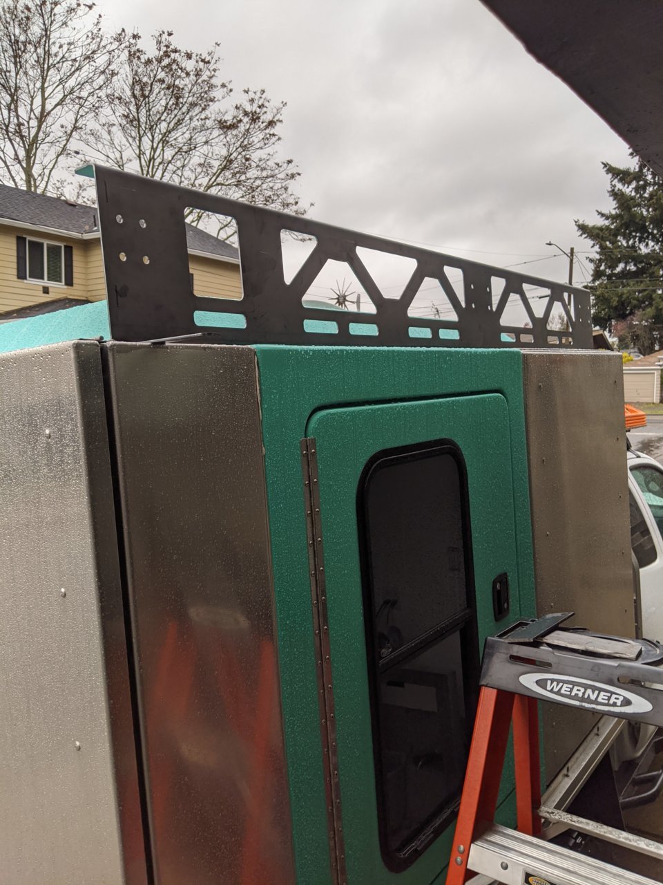

    Test fit it on the camper again.
    Figured out how much of a spacer I'll need on top of the rear box. 1/8" will allow the awning mount to just barely clear the painted part of the camper and bridge to the front box. Since all the bolts will be in the aluminum boxes, this is perfect. I'll put sealant under the entire length of the awning mount to both keep water out of the aluminum boxes and form a seal between the fiberglass part of the camper and the awning mount to act as a rain gutter above the door when the awning is deployed. :thumbsup: The only issue with this design is snow buildup behind the awning. It could be quite heavy and hard to remove if it's wet or has a lot of freezing rain mixed in.
    Use a step drill (aka the greatest invention of mankind) to create a nice radius in all of the inside corners. Then an angle grinder or jigsaw to cut the straights. I used an angle grinder as I don't care to put that much stress on my jigsaw. These trims are areas where I don't need the full flange for bolting purposes. Take some weight out where it's not needed. In fact, I bet I could remove all of the diagonals and have big open areas between each set of bolt holes and be fine. :sawzall: Or just stop thinking about this stuff and get it done!

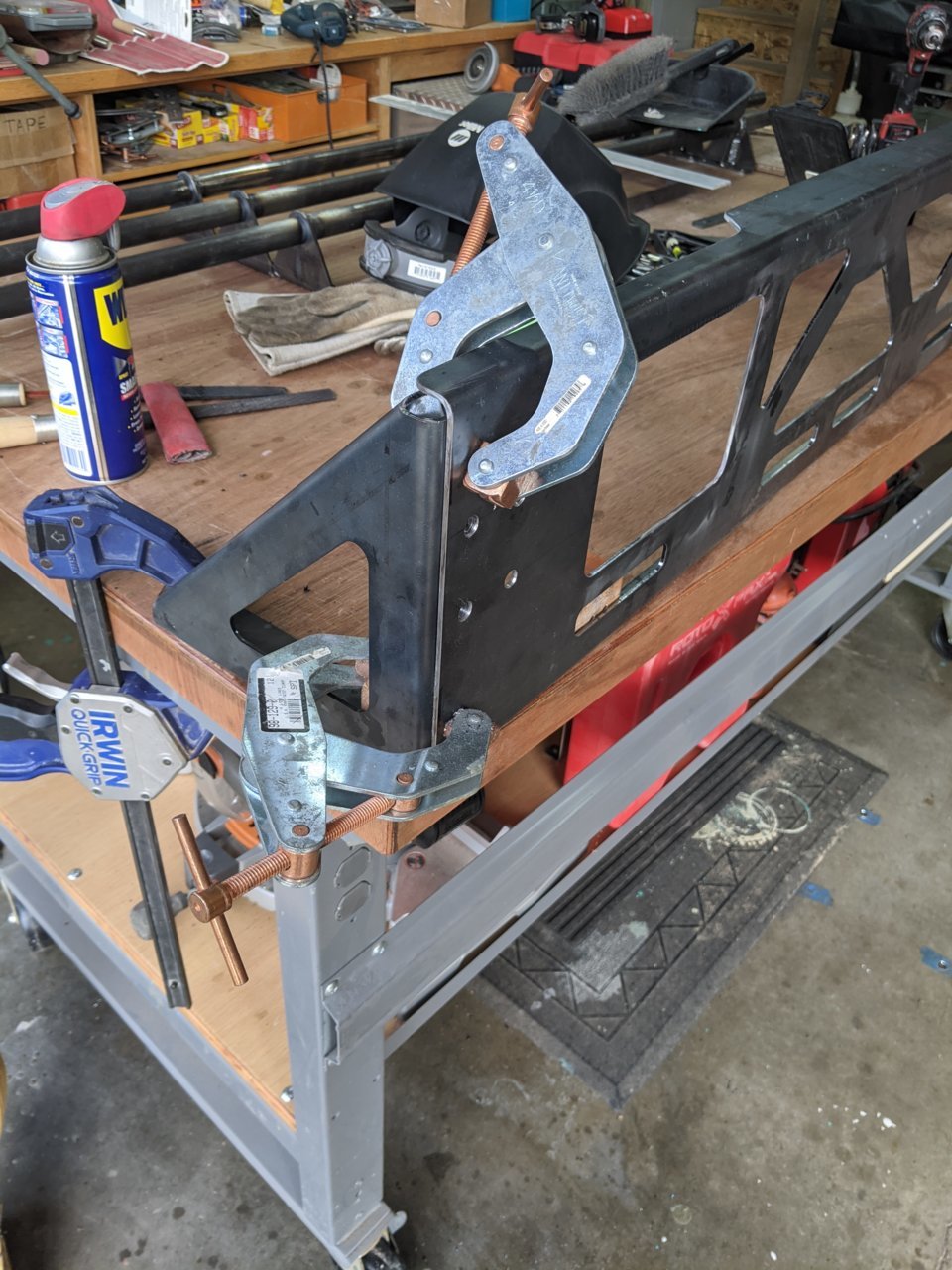

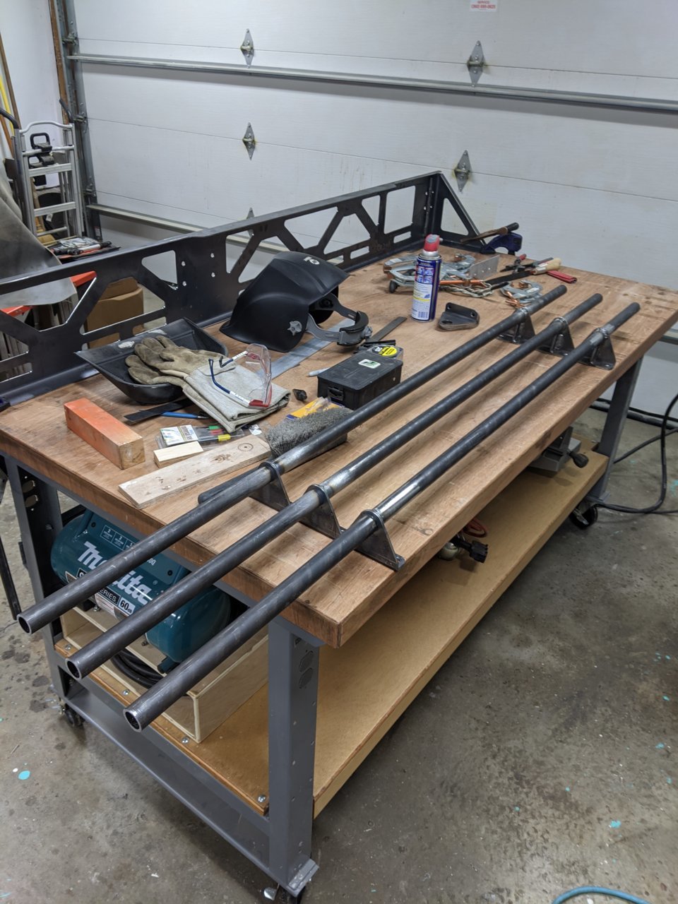

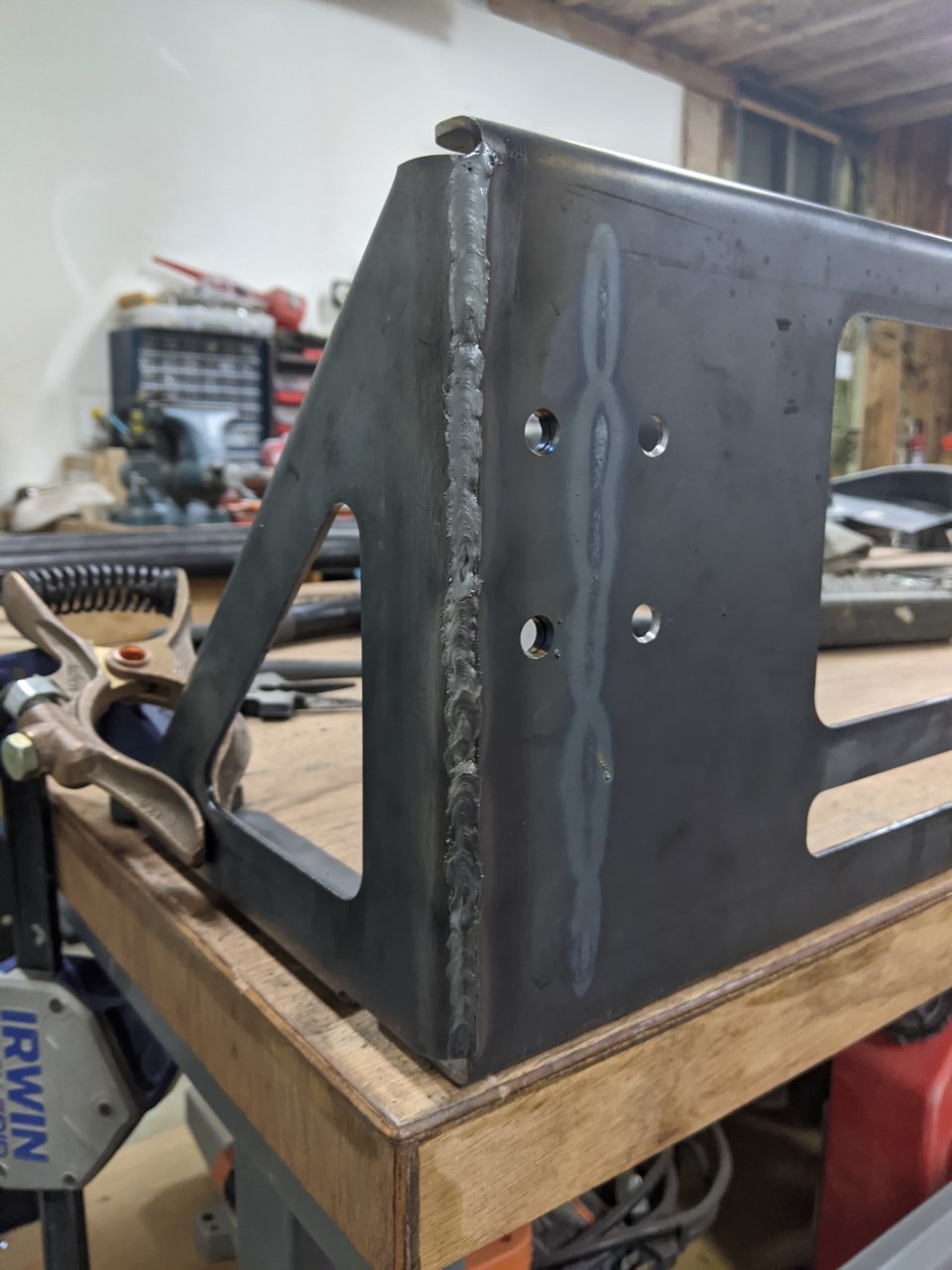

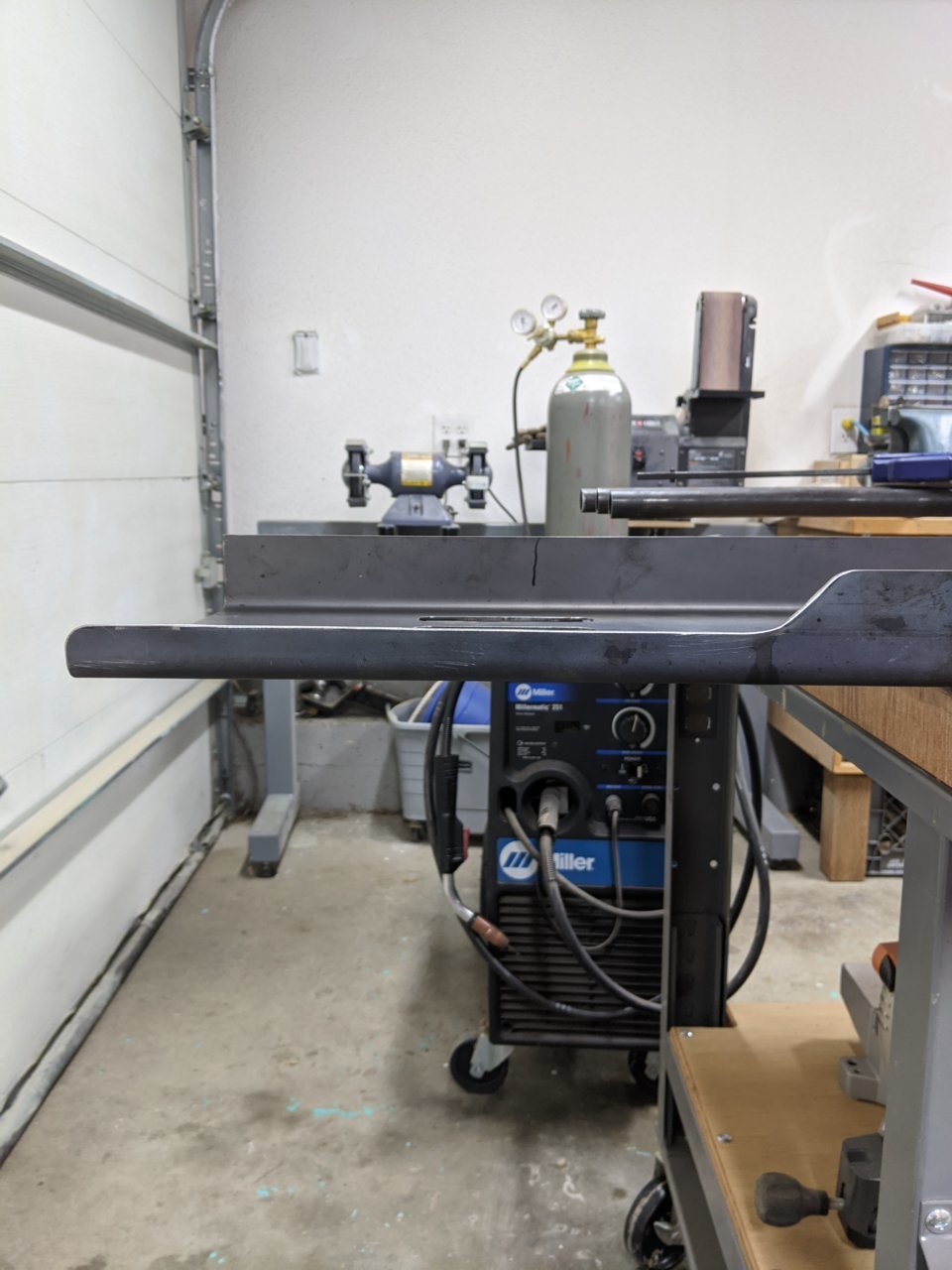

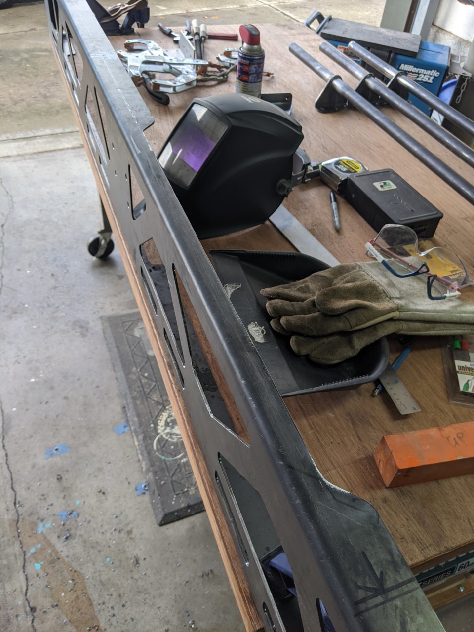

    What am I doing this Sunday? Working on the camper, of course! Took the dry morning to do a full test fit of the awning mount and all three rack crossbars. This gave me a chance to figure out how much of the cross bars I want to chop off to properly meet up with the awning mount. Didn't take pics of that. Was working quickly in case rain moved in.
    Then I clamped up the corner brace and match drilled the mounting holes.
    Did a little trimming then welded the corner brace on for good.

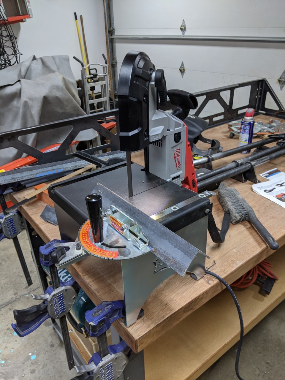

    Then hauled out the Milwaukee Porta Band and cut the crossbars to length. I'll end up welding a piece of angle steel to the end that allows me to bolt the end of the crossbar to the awning mount. I think that will give all the support I could possibly need.
    I also trimmed back a long section of upper flange. This lines up with the roof vent fan. Can't put crossbars there so no need for mounting flange. I'm very close to getting this out for powder coat. Just need more dry hours and energy.

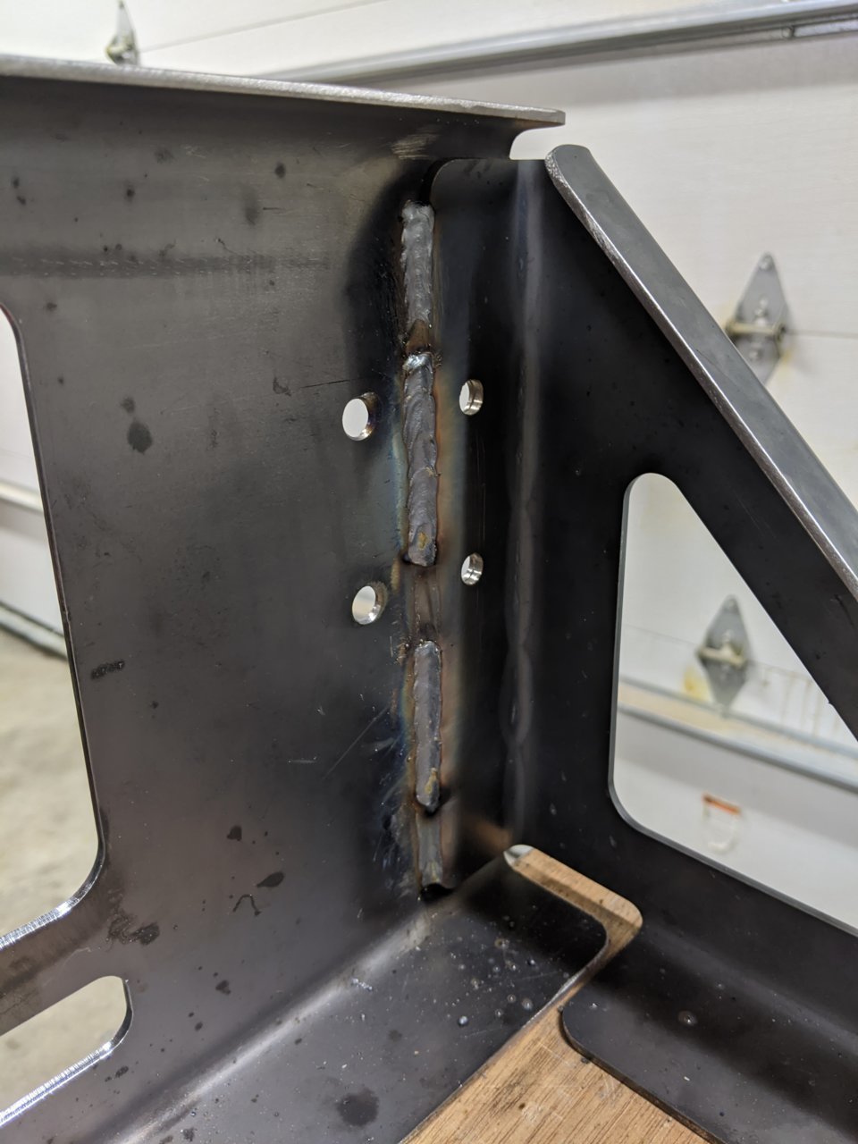

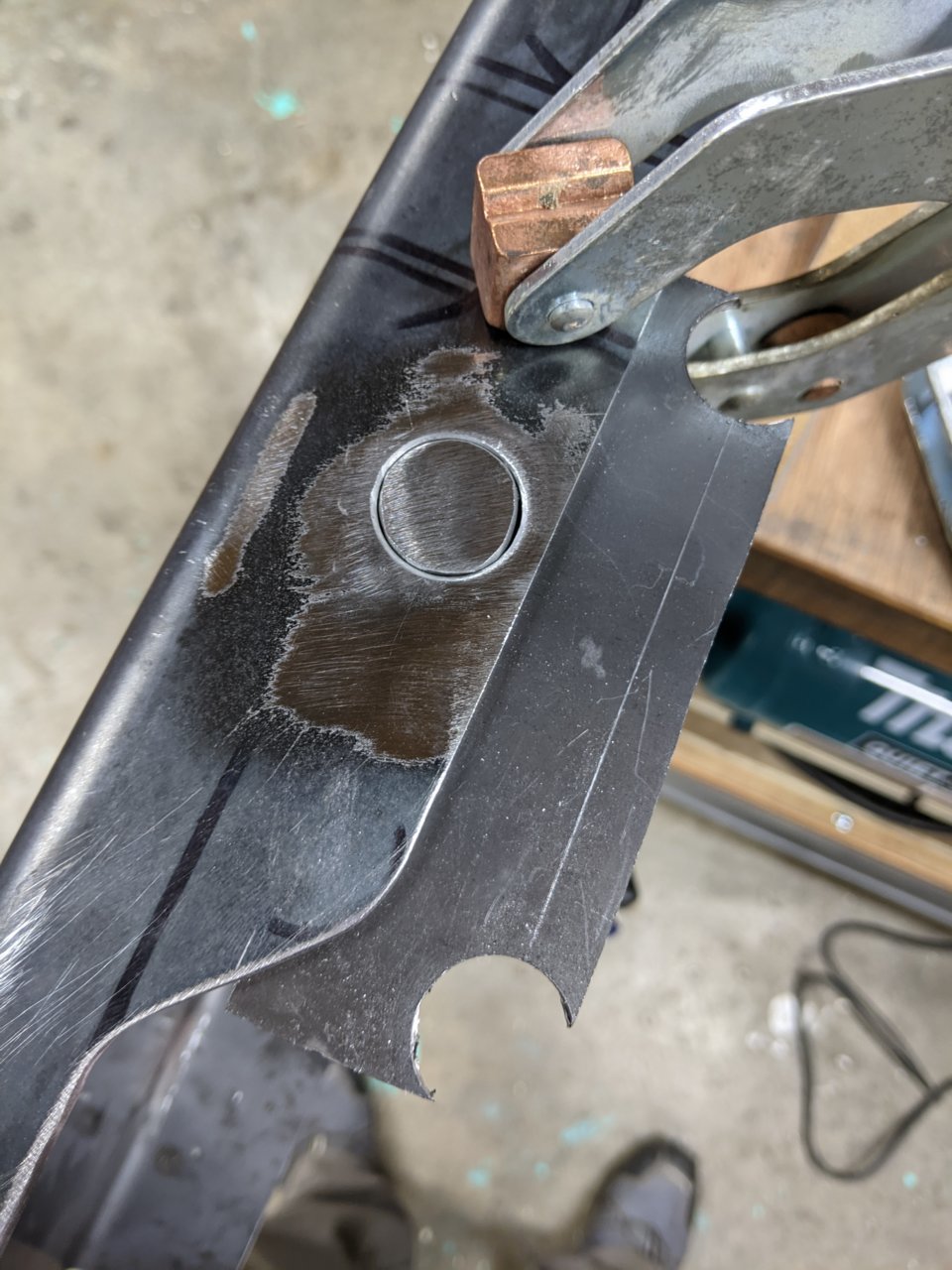

    Just wrapped up my day.
    Set up my SWAG Off-road Porta Band table and foot pedal. After some fiddling with the setup, it's awesome! Way faster and more accurate than a hacksaw. I may end up finding a home somewhere in the garage to leave this set up. The portal band is nice to use on its own so I'm not sure...

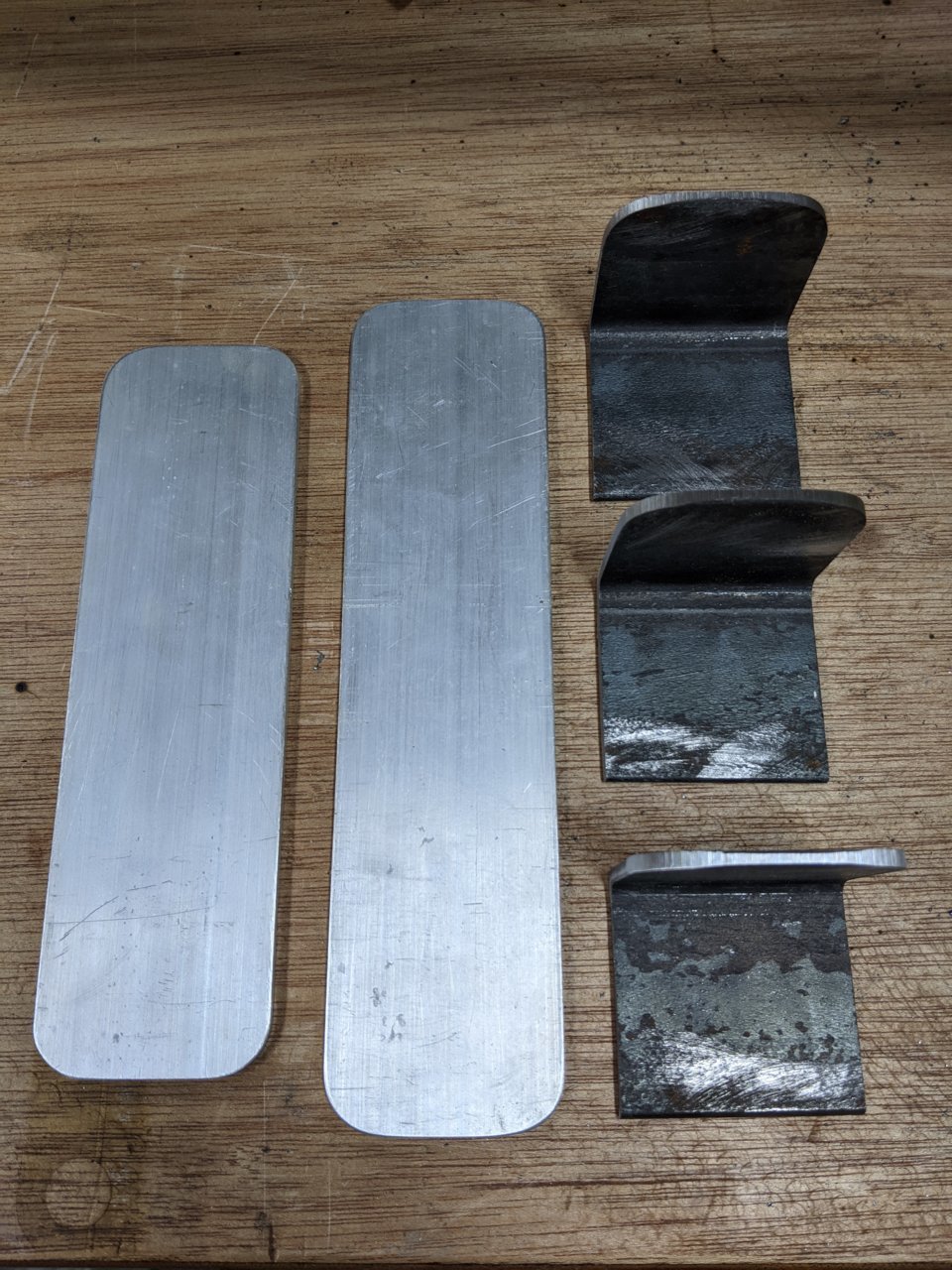

    I used the bandsaw to cut the roof rack crossbars to size, cut these aluminum spacers for under the back of the awning mount, and cut the angle brackets for the cross bar to awning mount connection. Did some work on the combination sander to put some nice corners on while I was at it.

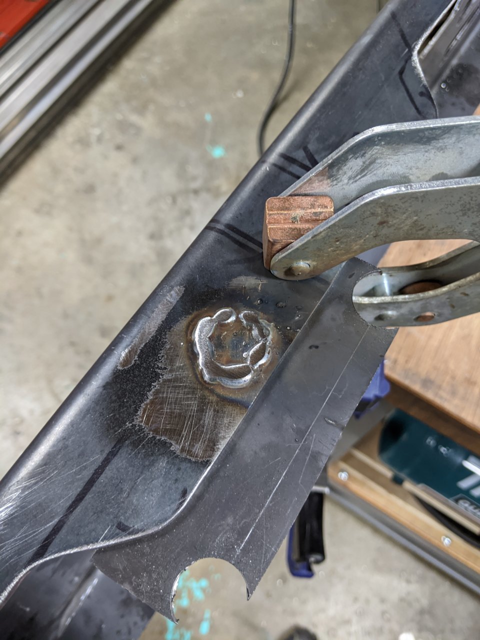

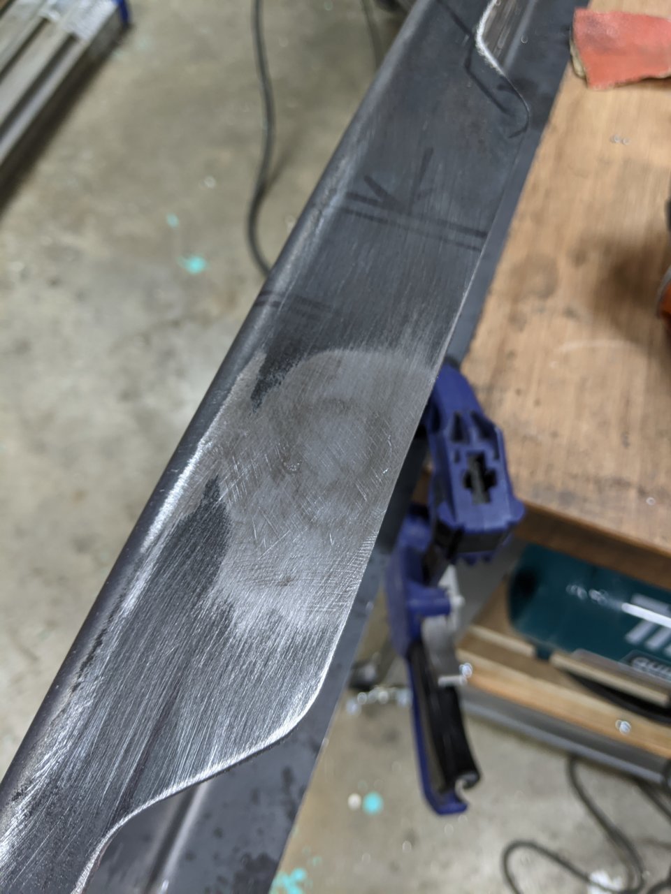

    Shhhh...don't tell anyone but I made a mistake that needed fixing. I got all stupid with the measuring tape and the uni bit and made a mess. So I cut a disc of steel and fit it in the hole.
    Weld it up.
    Grind it down. Do the same on the other side and call it done. It's not perfect but neither am I. :D
    Next steps before powdercoat are to mock everything up on the roof again so I can properly mark the angle brackets so I can weld them to the crossbars. Then back up on the roof to drill the three holes to bolt it all together. After that, drill the holes in the awning mount where they'll go through the aluminum boxes. Clean it all up then send it off for powder coat. So, basically another dry morning should do it.
