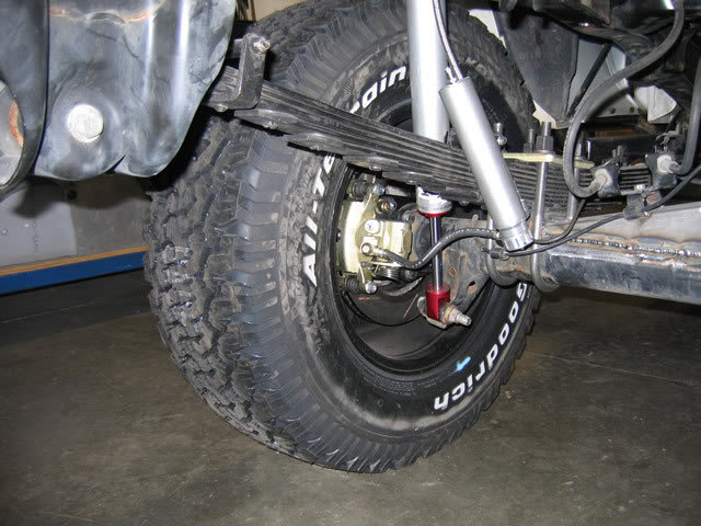

    AllPro is running a special on their springs this month. 3" lift springs for the 05+ Tacomas are $369 a pair. :cool:
    I'm running them on my truck with their u-bolt flip kit:
    (ignore the dangling shock reservoir...)

    Realistically, *anything* is possible if your shop is good enough. Most people are looking for bolt-on upgrades, and UPS generally doesn't ship custom fabrication work. :p
    That link you provided is intriguing! How much cutting and welding is required to install that shackle flip?
    Without modifying the suspension design, longer shackles will lower the new Tacomas as the attachment point for the leaf spring is above the stationary end of the shackle. I assumed that altering the suspension design was out of the question if swapping out the leaf packs was not an option.
