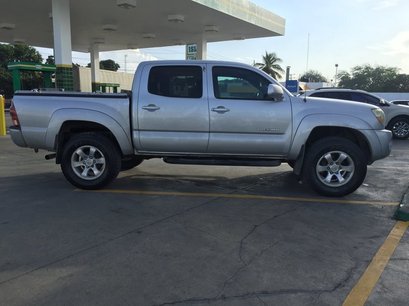

    With federal 265/70 R17. Huge difference with prior 265/65 R17.image.jpg

    You may notice the front will sag a little over time. I put my 5100's in at .85 and got a bit over an inch of lift initially. It's settled a bit and now I think I'm just under an inch which is where they were supposed to be anyhow. I've got stock replacement springs in the rear (3 leaf) with a 7/8" block and it sits about perfect. Just ordered some 265/75/16's for it last night.
