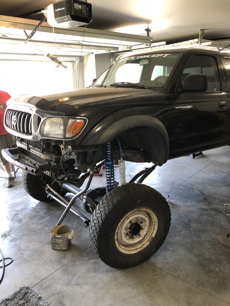

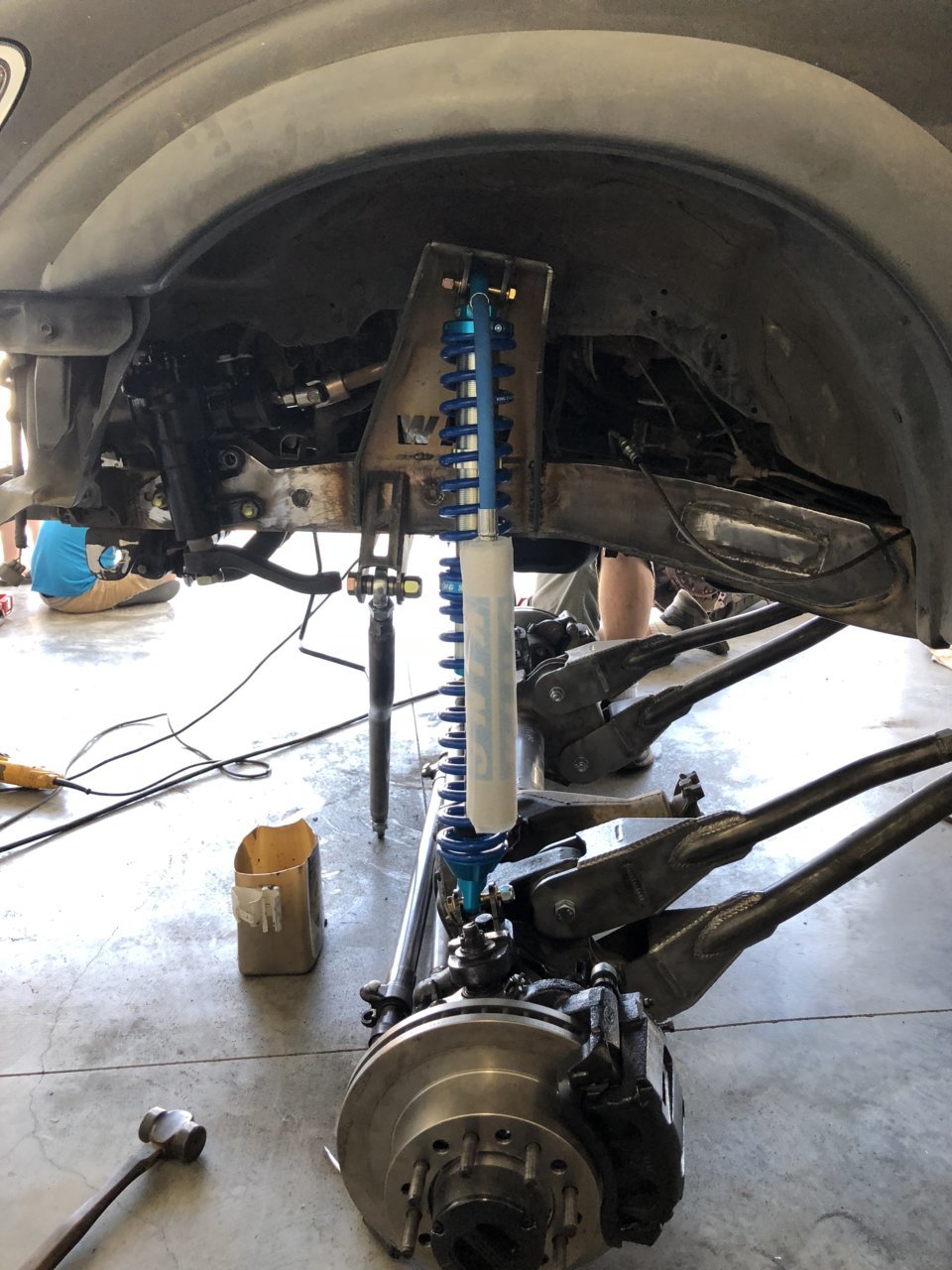

    Your truck would be allot lower if you would of used the original shock mounts I made the mistake to buying the ruff stuff coil mounts for my axle my truck was 10 inch lift status then I was told from WFO to use stock shock mounts and it ended up like I have it I’ll show you a picture of my trial and error wish the coil mounts on top of axle

  4. Sep 9, 2020 at 7:38 PM
    #104
    Potter1ton coma
    Potter1ton coma [OP] Well-Known Member
    Sep 7, 2020
    #340098
    345
    Jason
    1 ton double cab
    Bigdaddy4760 likes this.
  5. Sep 9, 2020 at 7:40 PM
    #105
    Potter1ton coma
    Sep 7, 2020
    #340098
    345
    Jason
    1 ton double cab
    With not wish
  6. Sep 9, 2020 at 7:42 PM
    #106
    Potter1ton coma
    Sep 7, 2020
    #340098
    345
    Jason
    1 ton double cab
    Unless you like 10 inches of lift I was shooting for low and wide WFO makes spacers to make your coils a perfect fit in the stock shock mounts on f350 axle 05 and up

    That was a big fuck up on me and had to buy new coilover shock towers cause where they were with the top axle mount was way off but everyone makes mistake I’m far from perfect
