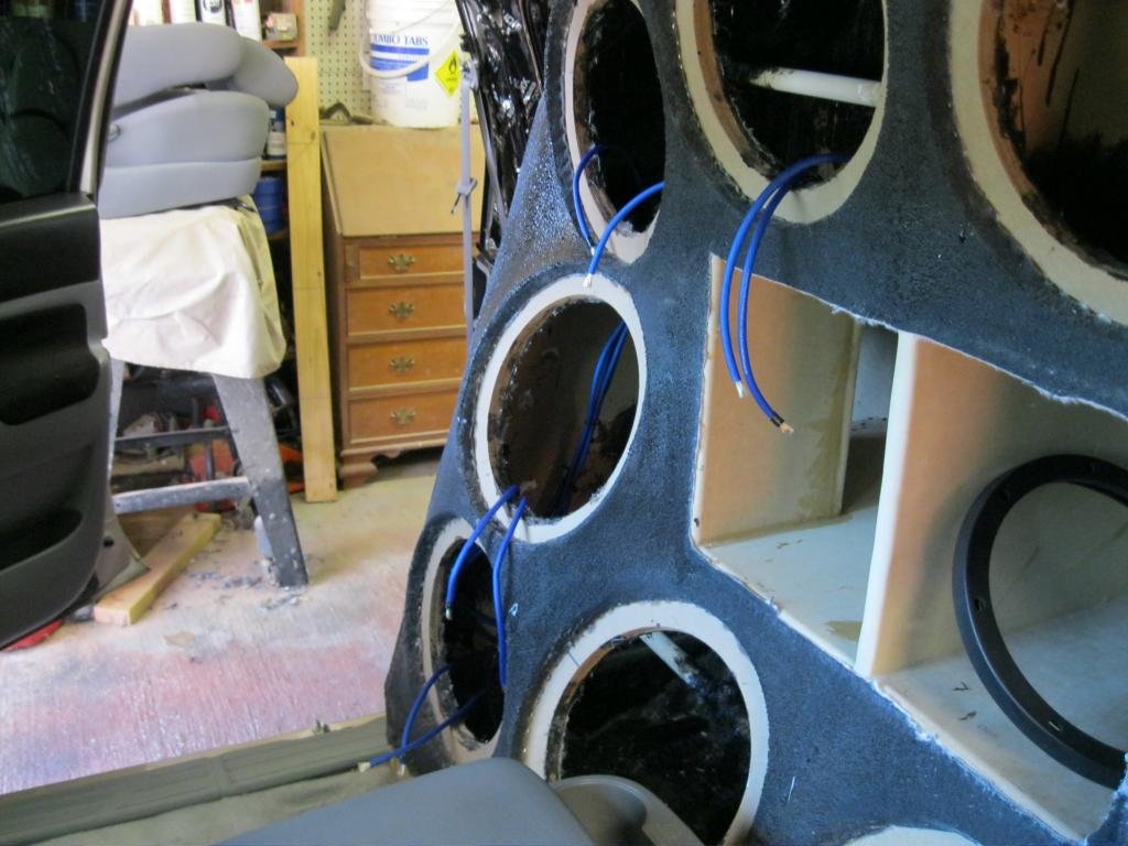

    I worked on it for a good bit today. Wiring up the subs was pretty time consuming since I soldered everything. Like I said earlier I am only doing this just to test everything and see how the box sounds and performs. I only have one amp now so I will wire it up halfway temporary and see what it does. If I'm satisfied with everything then I'll move on to making everything look good and hooking up the alt and batteries. Still a ways to go but it feels good to have gotten this far.

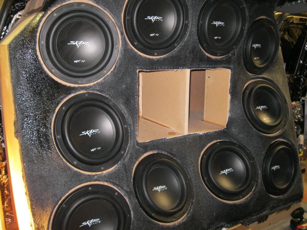

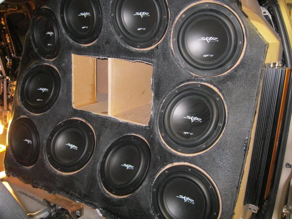

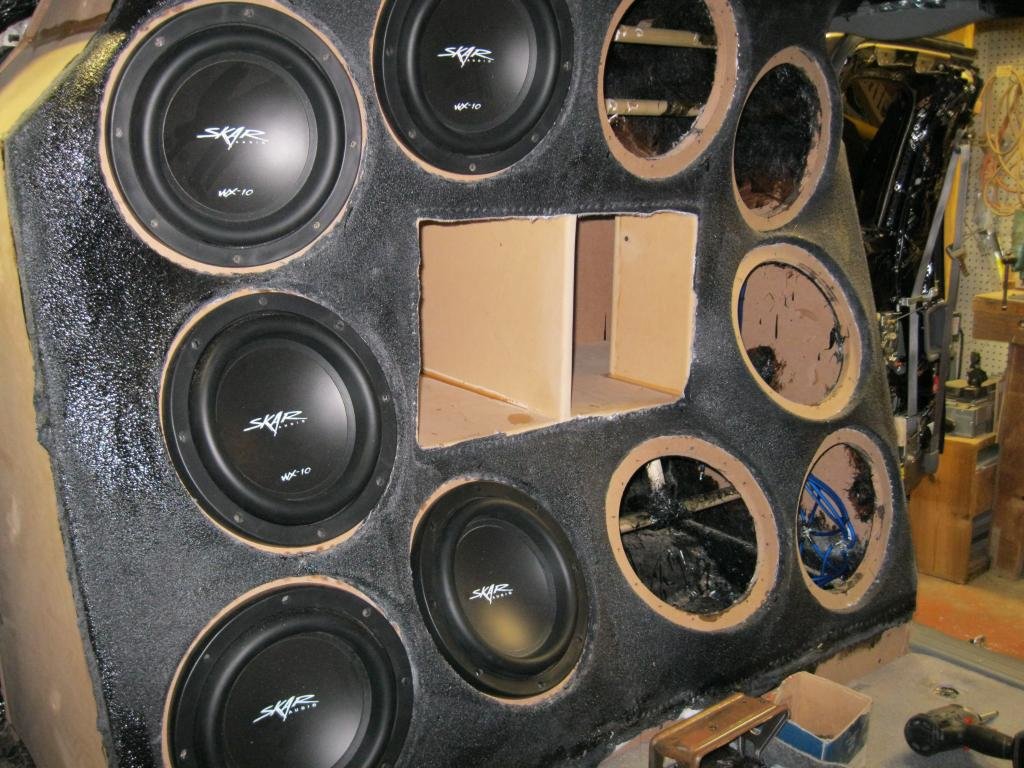

    You may have already stated it, but what are your plans for the middle holes?

    I think those are the ports for the airflow behind the subs.

    I figured that is what they were. Just unsure considering how big the ports were. But with that many subs that size hole is probably sufficient :p

    Yes those are the ports in the center. For a box this large it is about accurate for how big they are. They come out to be around 99sq in of port area per side and about 13.5in/cubic ft. It is bigger than average but with these subs and how I wanted the box to play it works well according to the design programs I used.

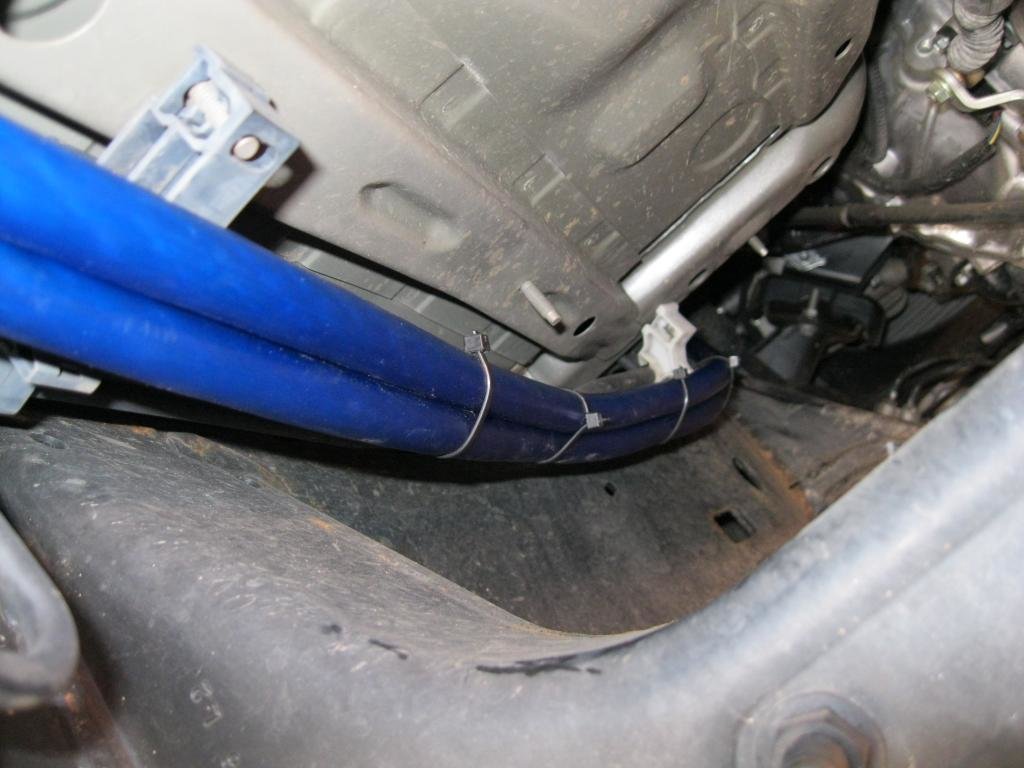

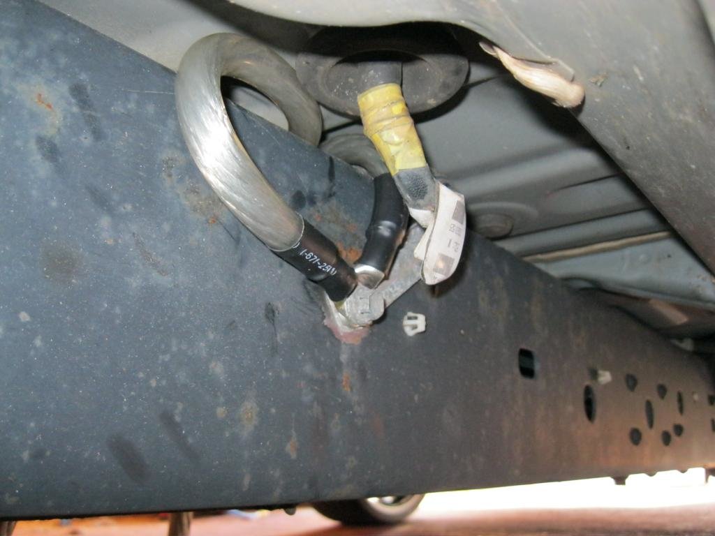

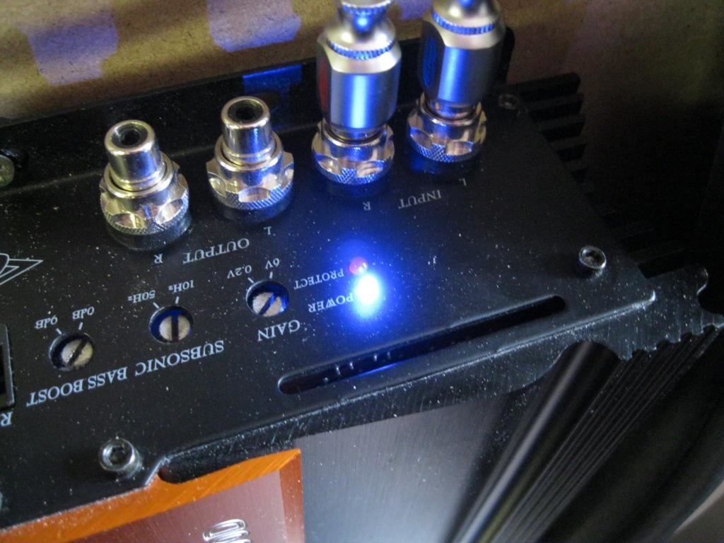

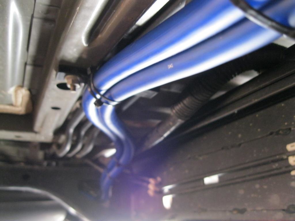

    Well I got the amp wired and playing today. I ran the two runs of 1/0 to the battery under the truck and the two runs of 1/0 that are grounded to the frame. I feel bad for this poor battery for the time being. I am surprised with how loud it is with only one amp. Even when I only had five of the ten's hooked up at 2ohms it was louder than the four 15's I had in here before. Right now I have all ten of them hooked up and around 1-1.5ohm. Everything sounds great though. I am really happy with how the box performs and now I need to do a lot more to get closer to finishing. I soldered every lug and used techflex and heat shrink for every visible cable.
