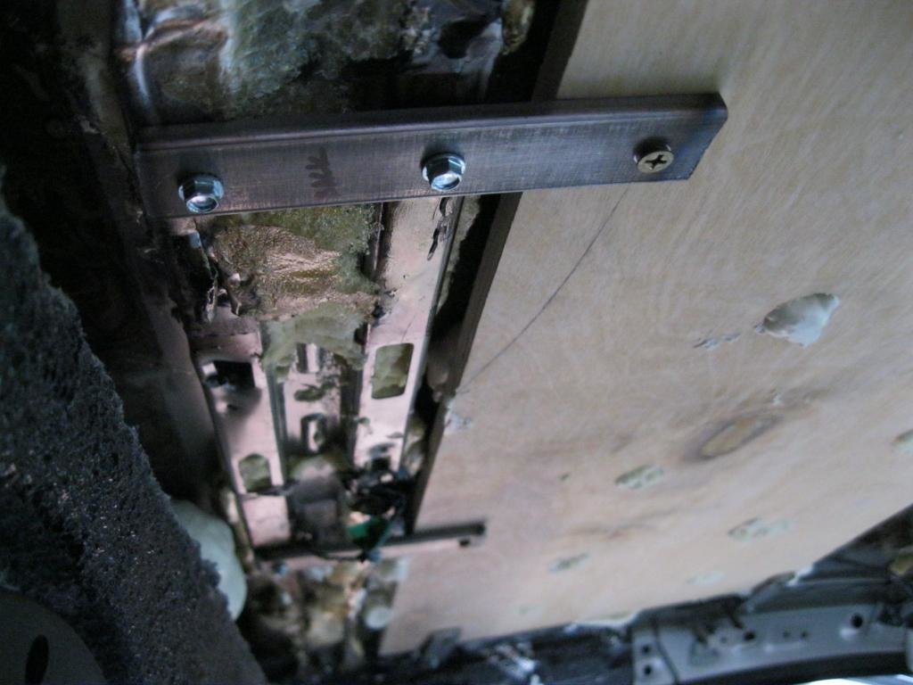

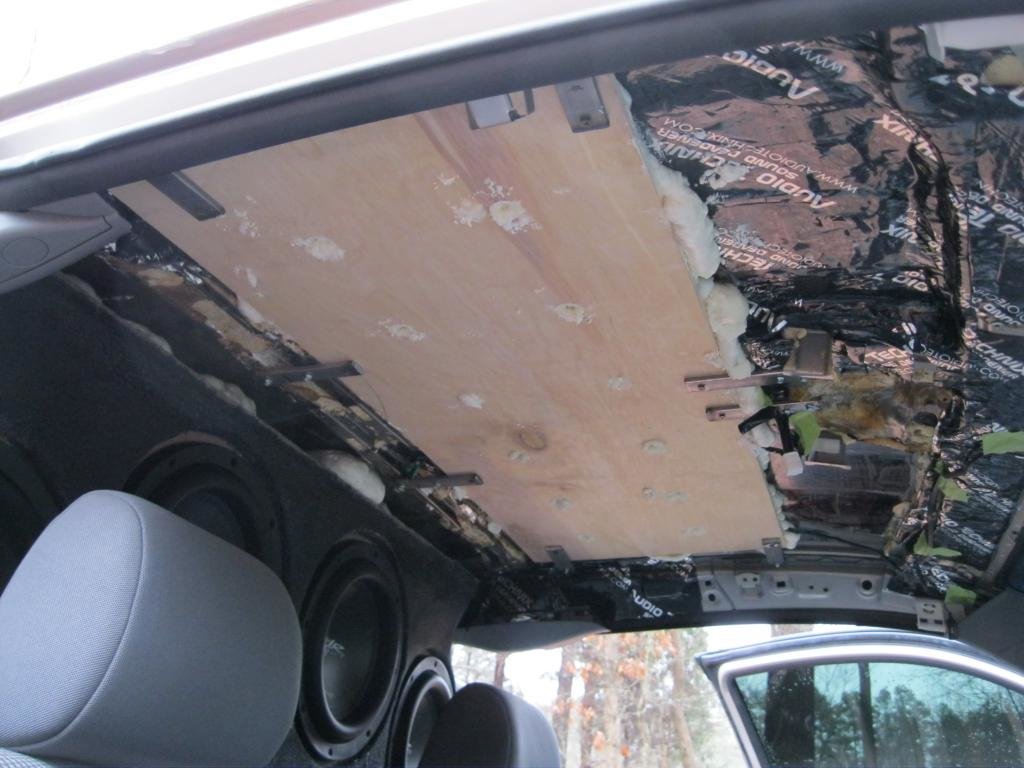

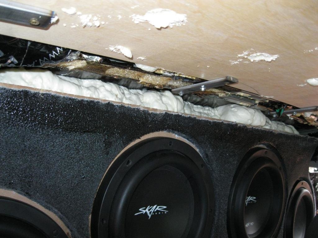

    I managed to get some work done on the roof to help strengthen it up some. I used 1/2" birch and 1/4" steel. Cut the wood to size and secured it with the steel brackets then spray three cans of great stuff in-between the birch and roof and also the box and roof. Definitely better than before but I am still going to put deadener over everything.

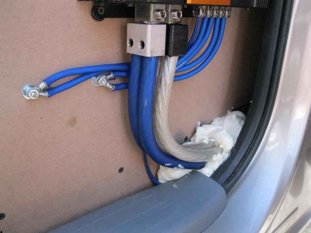

    Not much of an update but I just wanted to show how the wiring will look for the amp. Once I get the second amp on the other side it will be the same.
    Also I should go ahead and say that it might be a few weeks before I make anymore progress on this. I am going to be moving in a couple weeks and need to focus on that. Also I really need to start trying to get a job. I have been out of work for over a month now so the sooner I start bringing in money again the better.

    I love these threads. Was subb'd to the previous one too. Never heard of structurally reinforcing the roof that's nuts! But makes sense. I guess the windshield can take a fair amount before it pops out?

    Thanks. I am just trying to cut down on how much the roof is flexing. I was loosing output with the roof doing that plus it was causing some annoying noises. I still need to do more to make it better though.
