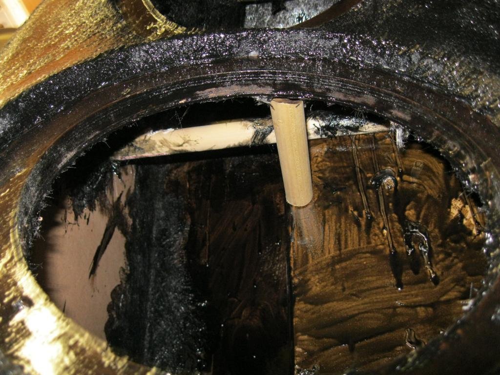

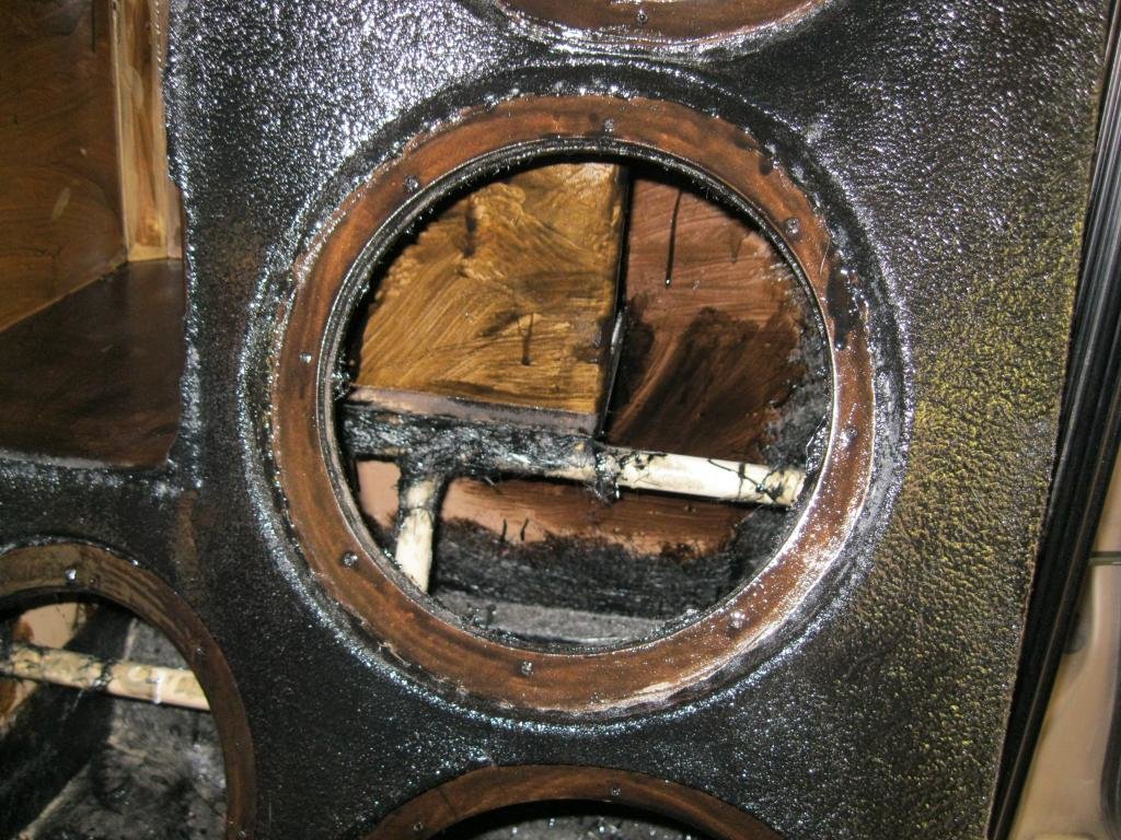

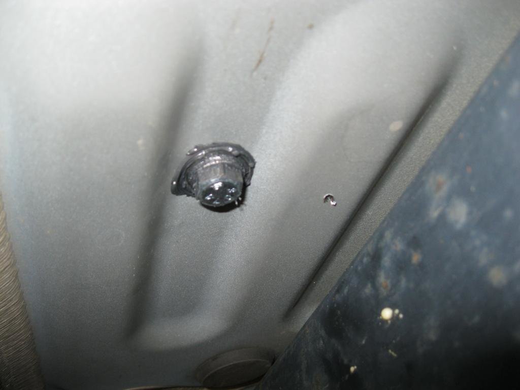

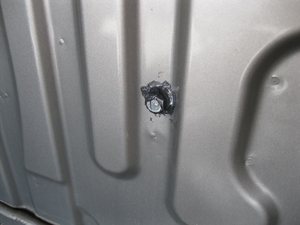

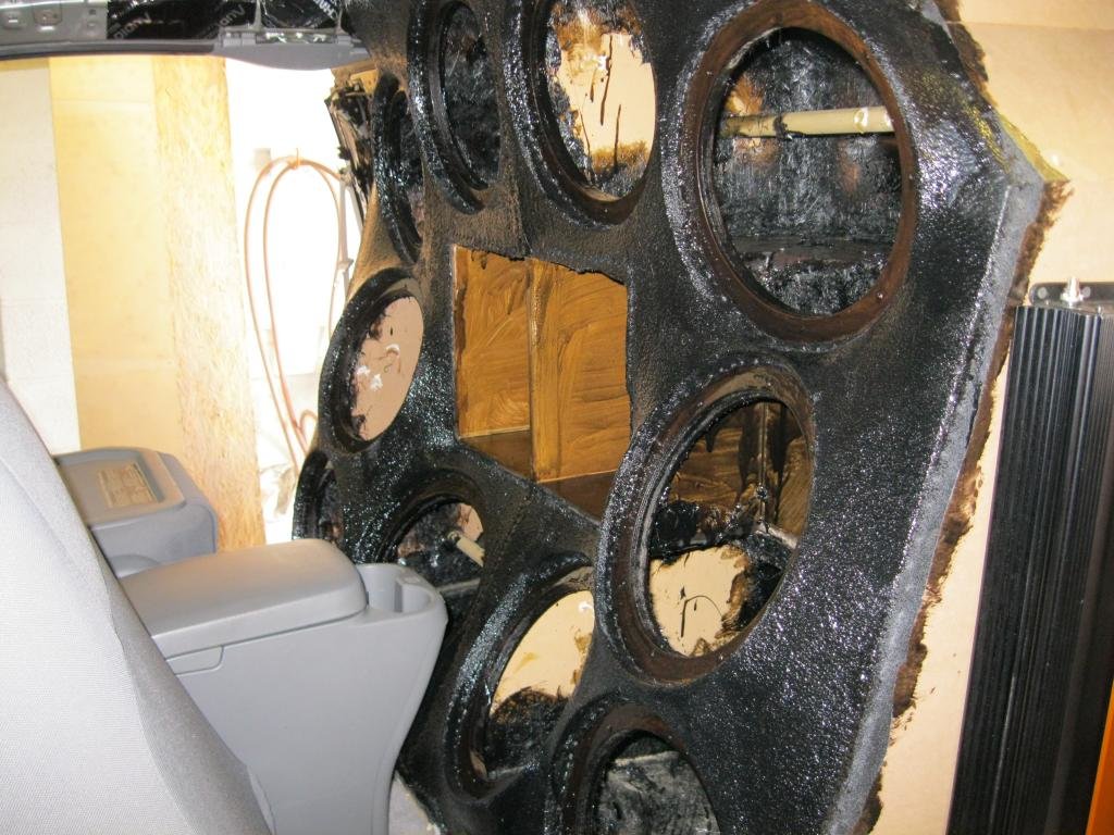

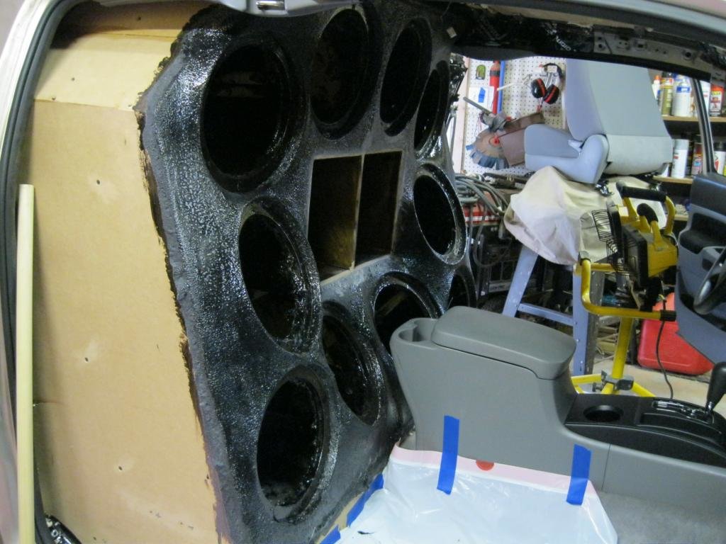

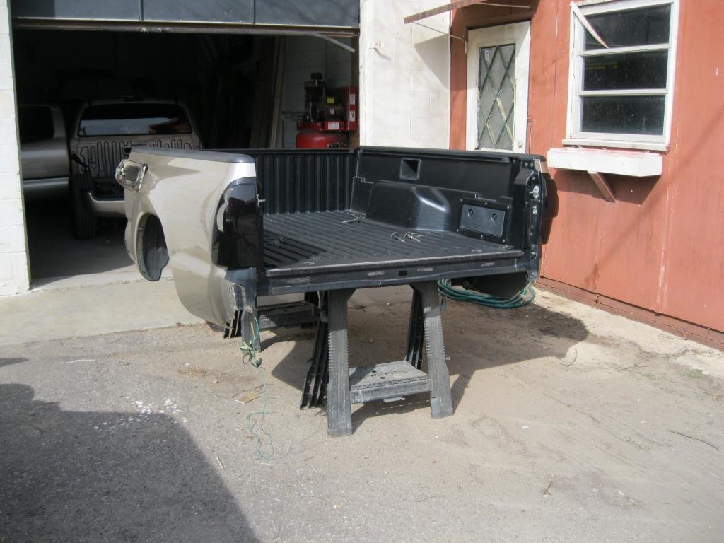

    Well I did get some work done. I had a buddy help me take off the bed so that I could bolt the box to the back of the cab. I put two bolts on the back and two through the floorboard up front. I also got some more resin on the baffle, ports, and rings. I'm going to glass more and add more bracing next. I am also going to try and start redoing the roof again. It still flexes too much so I am going to try something I've seen before.

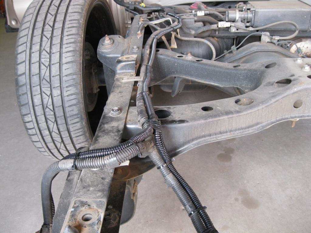

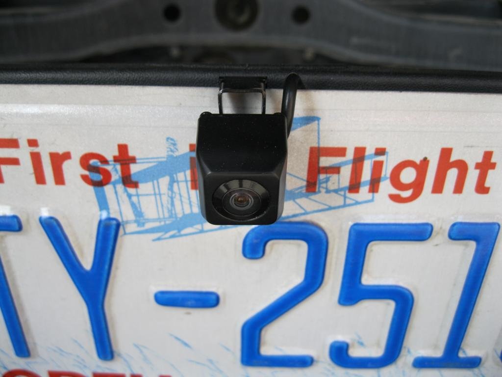

    While I had the bed off I went ahead and ran the wires for the back up camera. I'll actually hook it up when I put my new deck in.

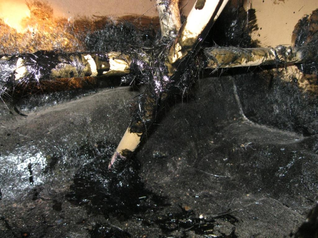

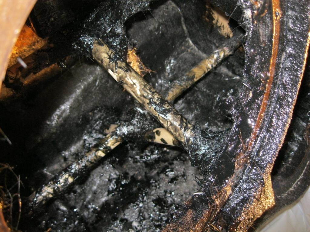

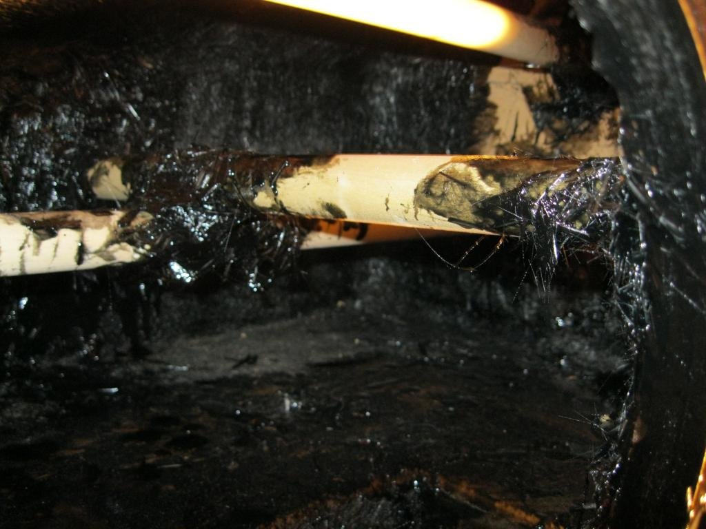

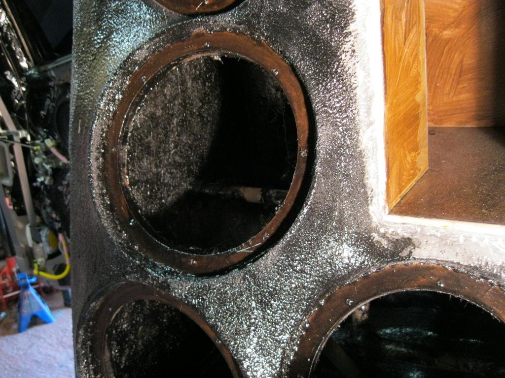

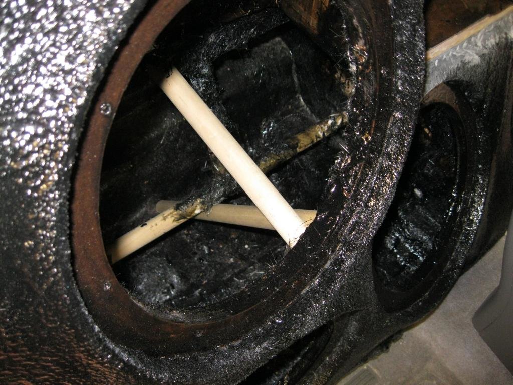

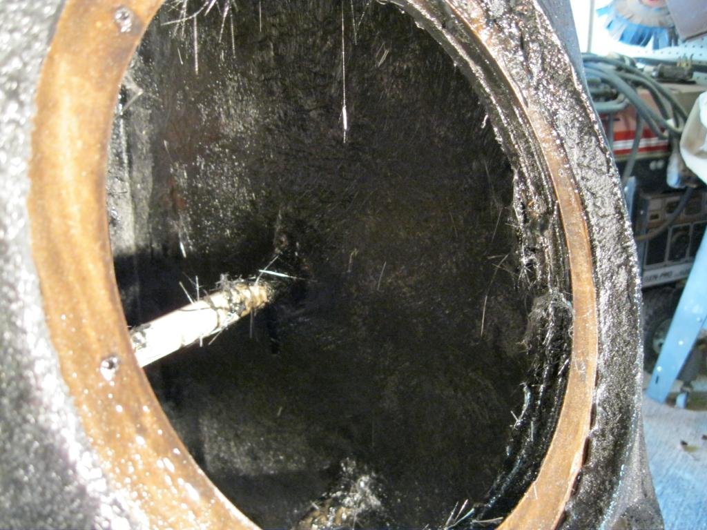

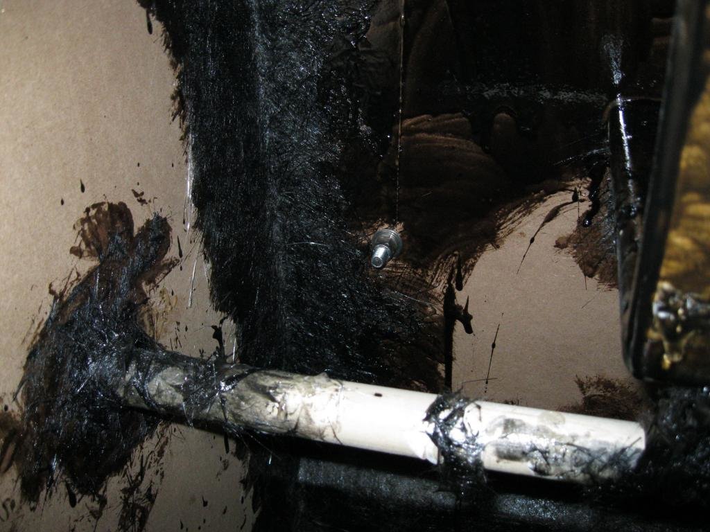

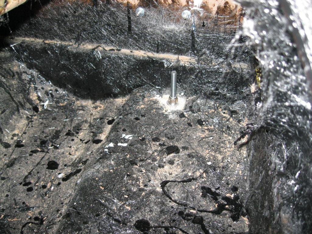

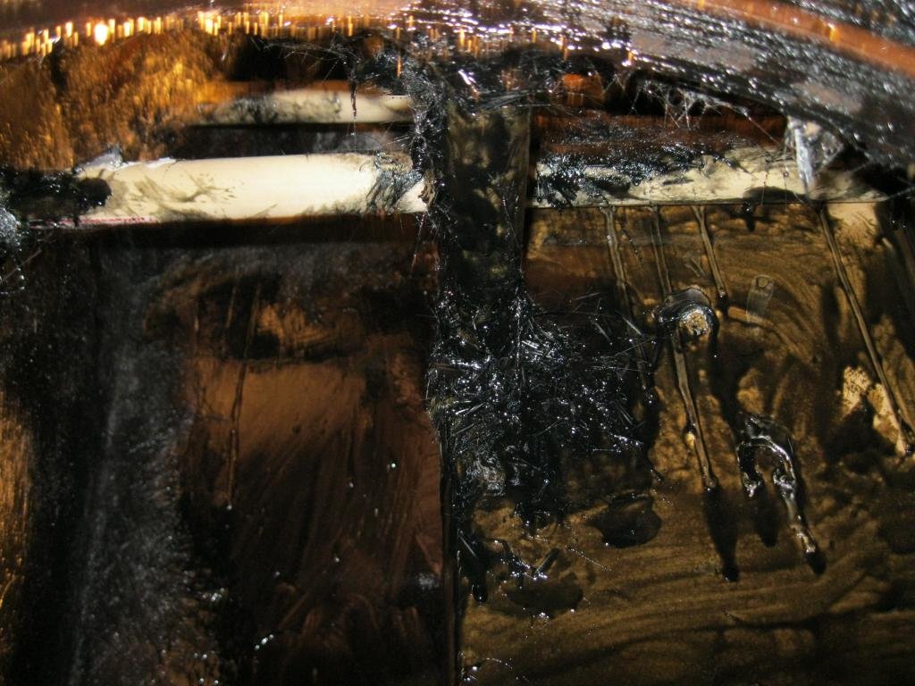

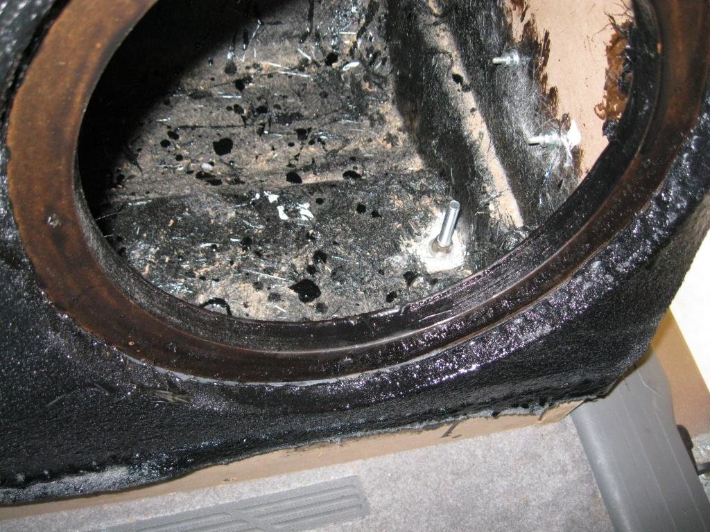

    Another seemingly small update but it did take some time. I finished all the bracing. I added more dowels from front to back. I added four more braces per side and glassed them in. Also I put a layer on glass on the sides to help strengthen it for when the amps are mounted there.
