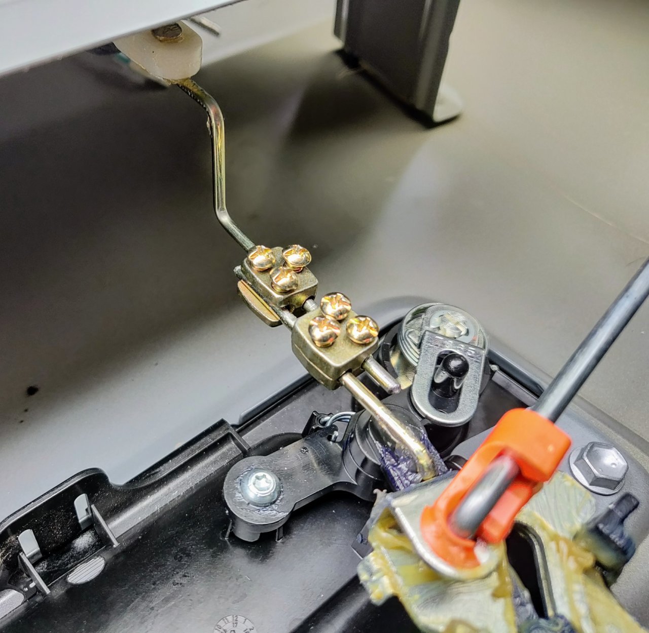

    MESO
    MESO [OP] Major Modder Vendor
    Feb 16, 2015
    #148809
    16,295
    State of Jefferson
    2016 DCLB TRD HELLCAT SWAP
    The reason why I offset the actuator to be the same level as the factory latch is the closer you can get straight on the better. Bending the actuator rod in a “L” too drastic can sometimes cause binding and puts unwanted pressure in the wrong direction on the factory plastic mouthing tab. Yes it will work, but I always try and keep the rod as straight as possible. Also, make sure you loctite those little set screws holding the rods together. Those are the first to get loose after multiple lock/unlock actions.
    C41n, RobP62 and helix66 like this.
  2. Oct 20, 2018 at 5:17 PM
    #182
    maybeme
    maybeme Well-Known Member
    Sep 18, 2018
    #266690
    83
    Thanks for the feedback!
    I agree that there will be some torque...but I checked to make sure there is no binding, although I have no idea how much of an issue the bending could potentially be. Should the actuator fail, however, it will take me 5 min. at most to replace it. And yes, normally I would use CA - but in this case, I scored the surface of the pushrods to make sure the screws have something to grab onto (just in case I need to replace the actuator).

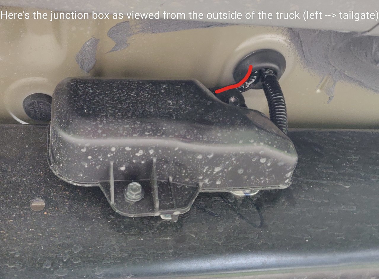

  5. Oct 21, 2018 at 7:51 PM
    #185
    norcalXninja
    norcalXninja Well-Known Member
    Jul 22, 2018
    #260169
    171
    Evan
    2018 TRD Sport DCLB
    Attempted this mod today. Ran out of daylight but I got to the point of running wiring. Is there any chance that someone took pictures of the wiring route? I am not the most mechanically inclined and had a difficult time locating the path from the path from the tailgate to the B post wiring harness. I tried using some of the pictures in the thread as reference but still couldnt quite find it. I appreciate anything anyone has.

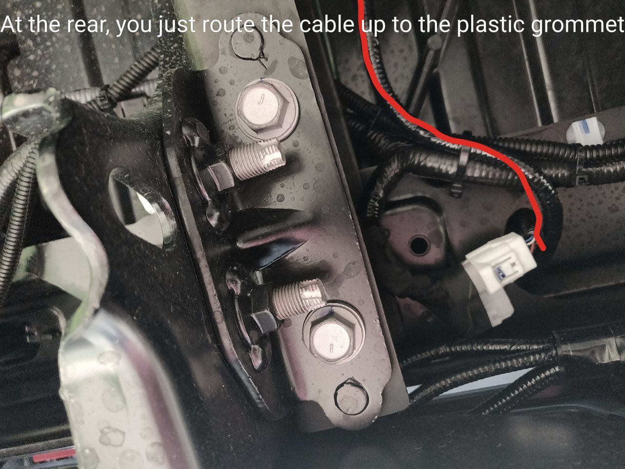

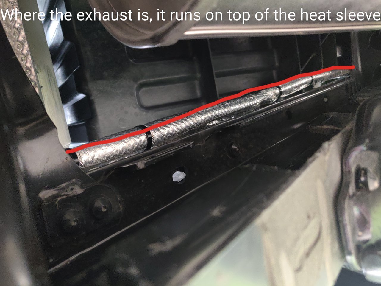

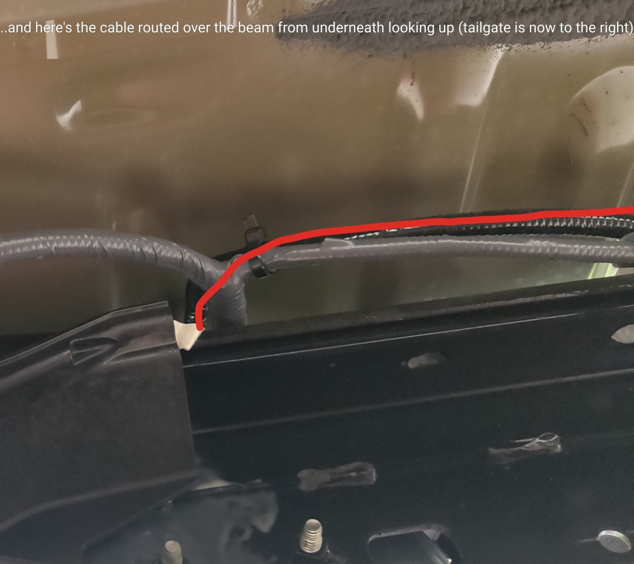

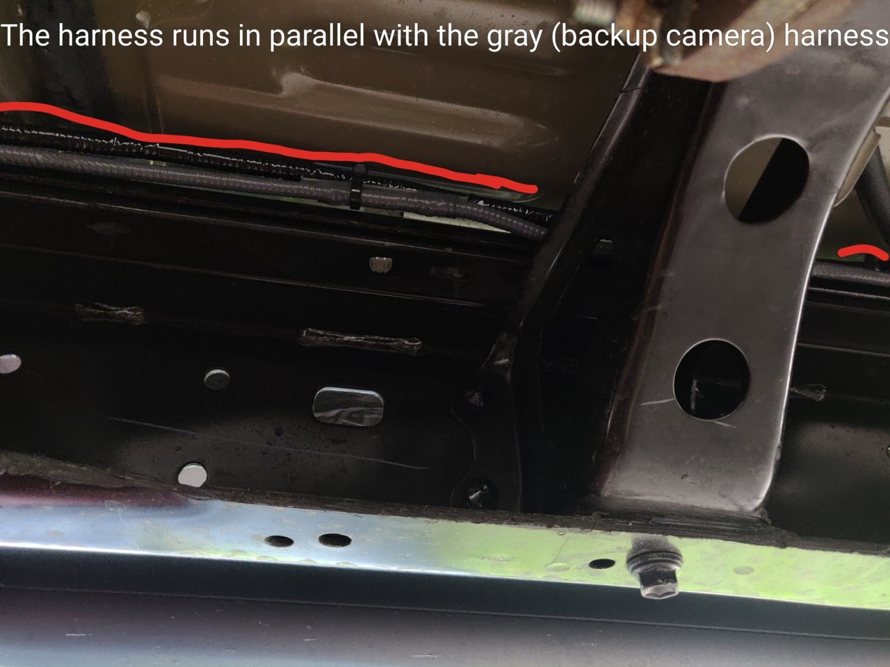

  6. Oct 22, 2018 at 7:10 AM
    #186
    maybeme
    Sep 18, 2018
    #266690
    83
    Hi, I just ran outside and snapped a few pics with the cellphone - sorry for the crappy quality and editing. I'd start at the junction box because it's easy to locate and work my way backwards. Note that I used a 1/4" split wire loom which I wrapped in electrical tape.
    Hope this helps...
    Bernie
    dryfly208 and C41n like this.
  7. Oct 22, 2018 at 3:30 PM
    #187
    norcalXninja
    Jul 22, 2018
    #260169
    171
    Evan
    2018 TRD Sport DCLB
    Awesome that definitely helped. When I looked originally I believe I was looking down the drivers side. Off I go wish me luck. (Edit: just completed it and it works great. Couldn’t be more excited)
