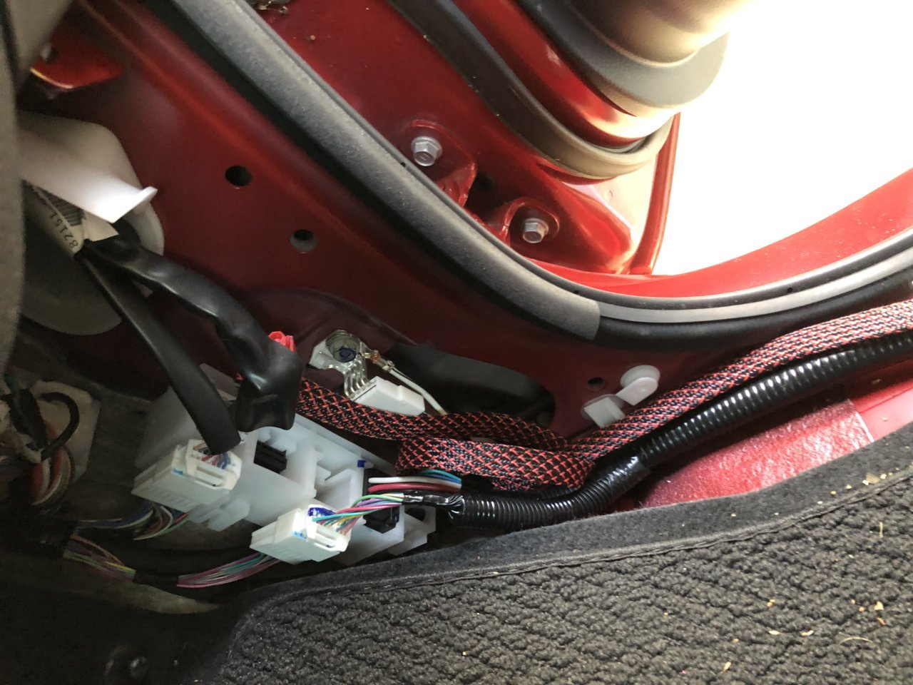

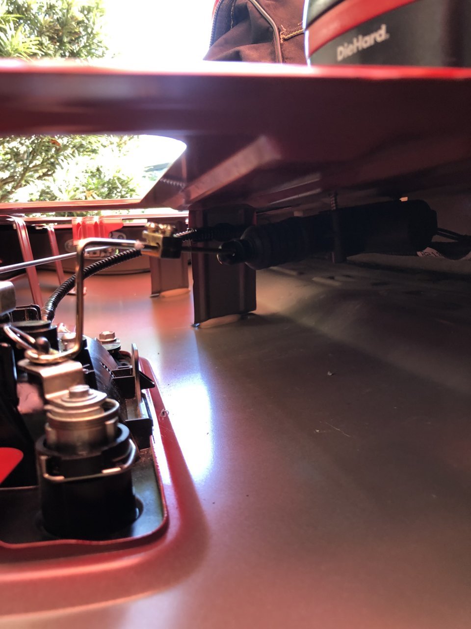

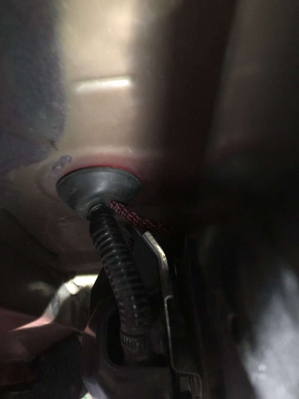

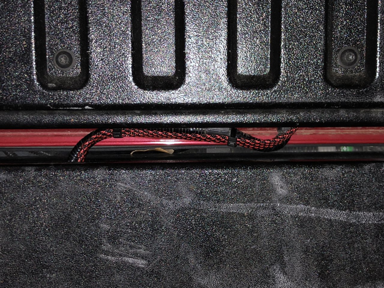

    Thanks to all who have posted here. This is a better, cheaper, and better documented fix for this obvious Toyota omission than either PnL DIY or dealer (also PnL), imho. I finished mine this morning, just under the 1-year mark from new purchase. I “personalized” mine a bit, with all Amazon parts, of course, so thought these photos might be useful...429DA0F2-7916-4446-89D9-2921DD8EC8A9.jpgD986D156-3874-412A-BBAA-A0FC19334AD4.jpg24D79218-3E5C-4969-A36F-143D3DD0D4D8.jpg1615155E-2D1E-402B-9D76-98462B697F98.jpg

    Love that wire loom. Just be careful with the connecting rod having that much bend and elevation change..it could lead to binding.

    Yeah the sleeving looks great color matched! Makes me want to build another PC!

    I did worry about the angle. Thought about a spacer bracket, but I think the linkage flex makes it viable.
    As to the loom, I’d never spend for that on a PC, but to “match” my truck, anything!
    For those considering this, there are 2 concerns I’ve seen in other threads:
    The lock wiring is exposed, so reduces the lock system security, and the tailgate has no open sensor, so there’s risk of locking the fob in the bed. Both identical to the PnL/dealer solution.
