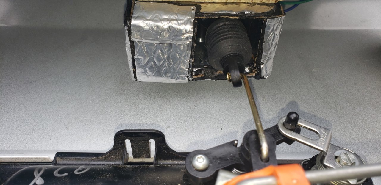

    Did mine today. Took a little longer than I wanted but had nothing better to do. Made a box that I wrapped in sound deadening material and added a plug in case I need to remove the tailgate. The actuator seems to push and pull a little harder than would like. I'm wondering if I elongate the hole a little in both directions if it would eliminate how hard it locks and unlocks. Anyone ever try anything like that?20200330_154323.jpg 20200330_144513.jpg

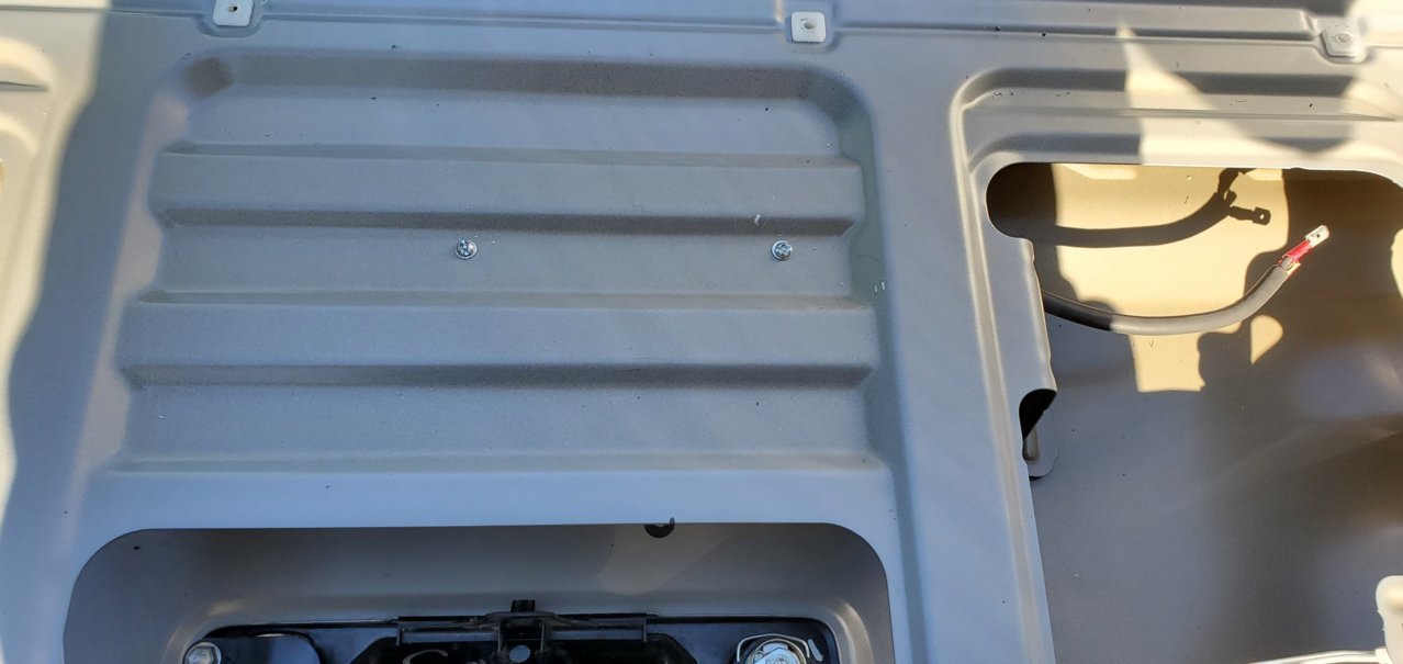

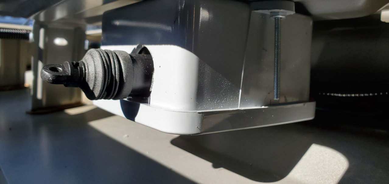

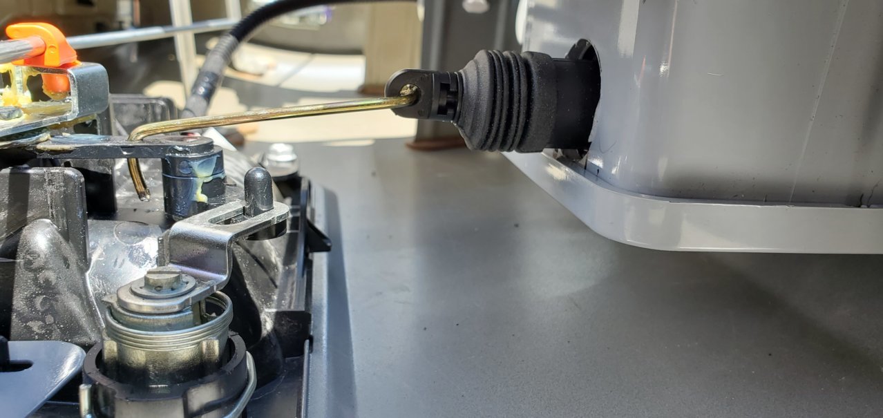

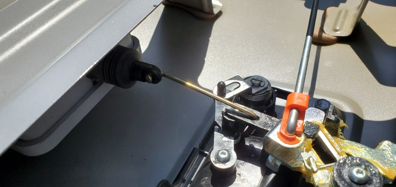

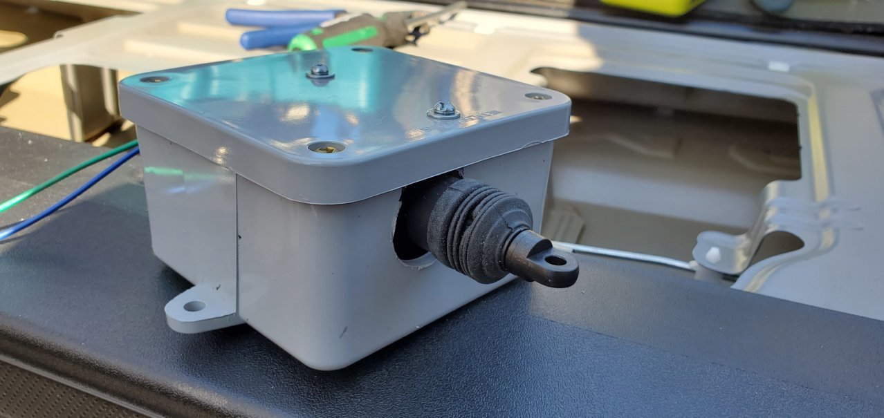

    I did mine today and this is what I came up with. This 4x4x2 PVC junction box was perfect. I drilled a 1 1/8" hole for the piston and a 1/4" hole at the back for the wires. I lined the extra space with 1/2 foam (old workout room floor mat) and this thing is built like a tank! That box cost me $12 CDN at Home Depot. And it matches the Cement color perfectly!!!
    Thanks to this forum and the constant improvements on the design by everyone I was able to get this done. Couldn't be hapier!!!
    Only thing I'll modify is adding a 1/4 rubber mat cut to the size of the box, between the box and the metal of the tailgate. I think that will make the set up more level for the mechanism.20200514_120116.jpg

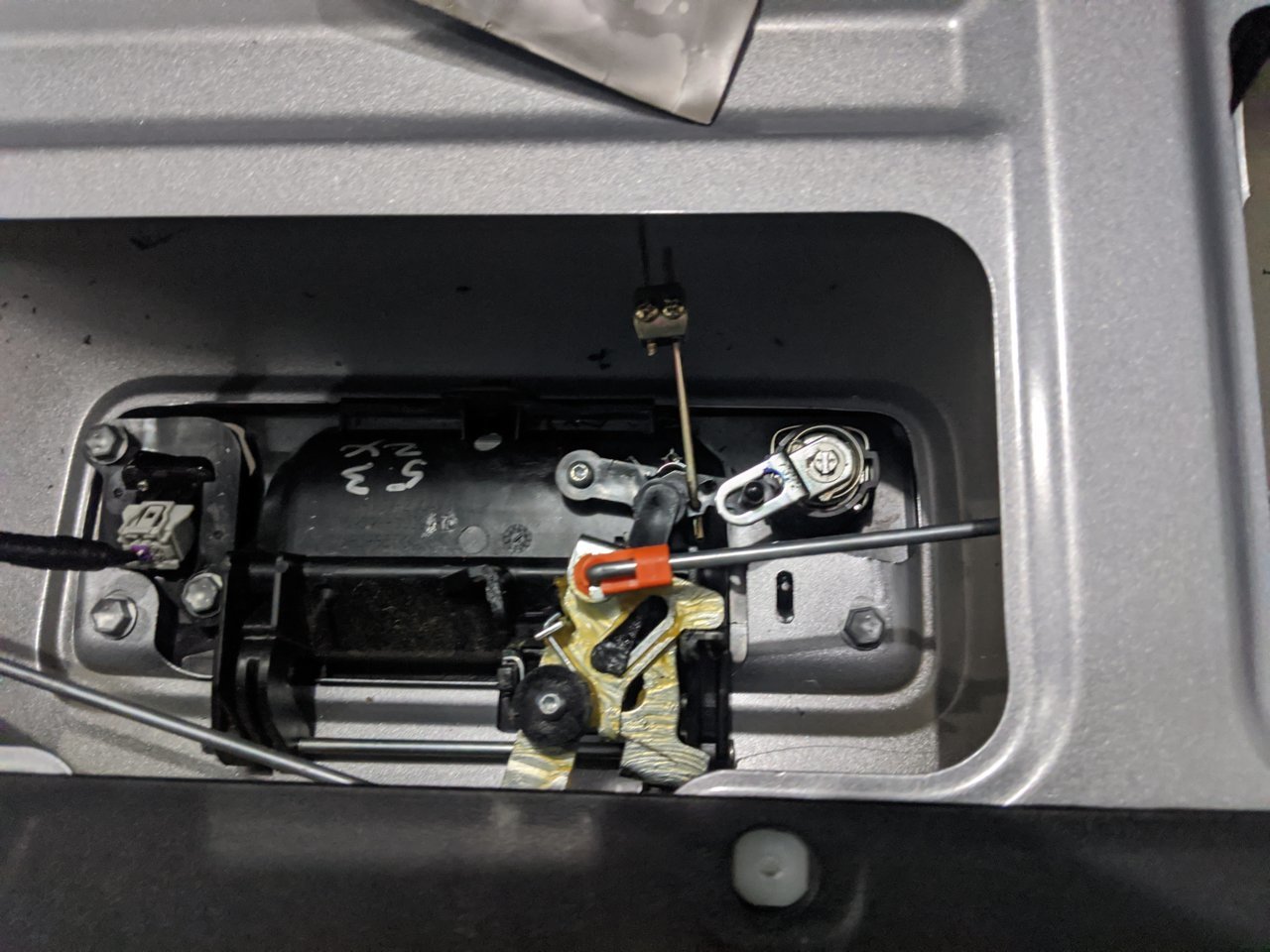

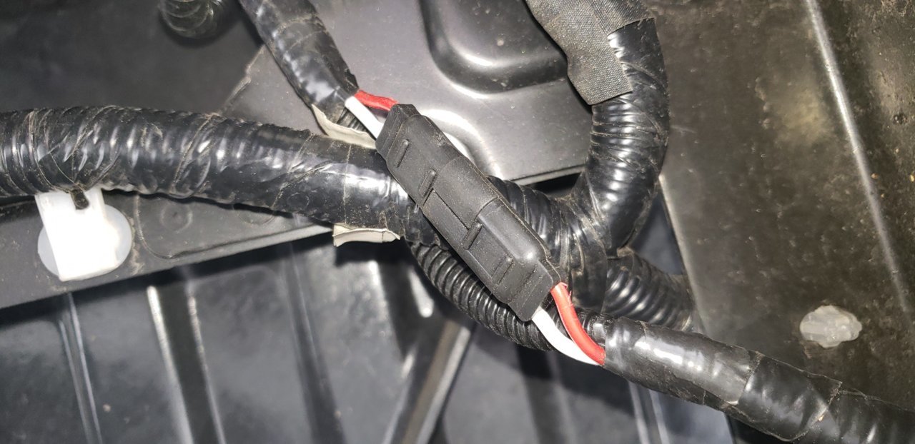

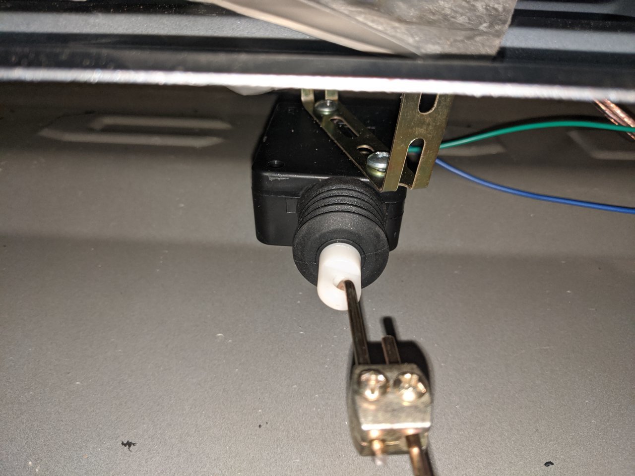

    Installed it today. Great idea meso.
    12 dollars for the actuator on eBay
