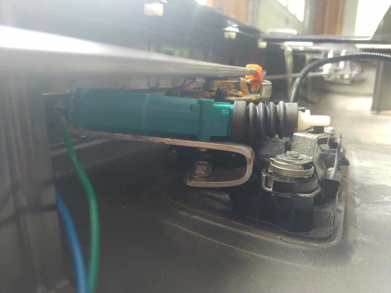

    I did this over the weekend but didn’t install the actuator in any kind of box or sound deadening. I’m thinking about finding something to put the actuator in now since it is pretty loud even with my tonneau cover on.

    i might go in and wrap the box with some sound deadening but its a minor issue.

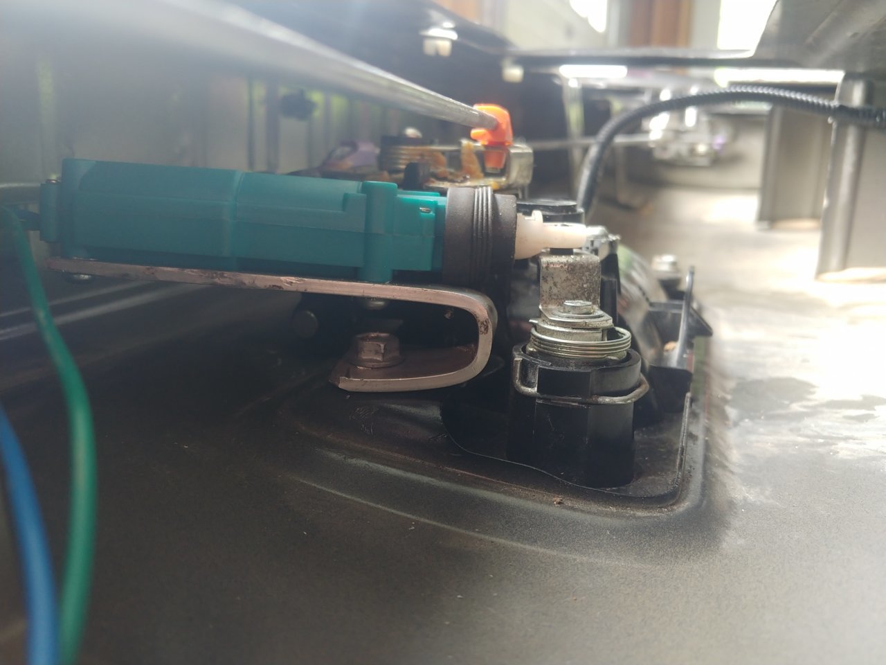

    Got um done today gang. Took me 2 hours because I wasn’t prepared and was anxious to get it on. If I were to do it again which I am since I bought a 2pk I would get the right screws for the actual size of the actuator hole I drilled mine out slightly to avoid splitting. Happy with the mod and have piece of mind that my tailgate is secure. Thanks @MESO for the post. I ordered my key fob tonight to celebrate. Cheeehu! :woot:

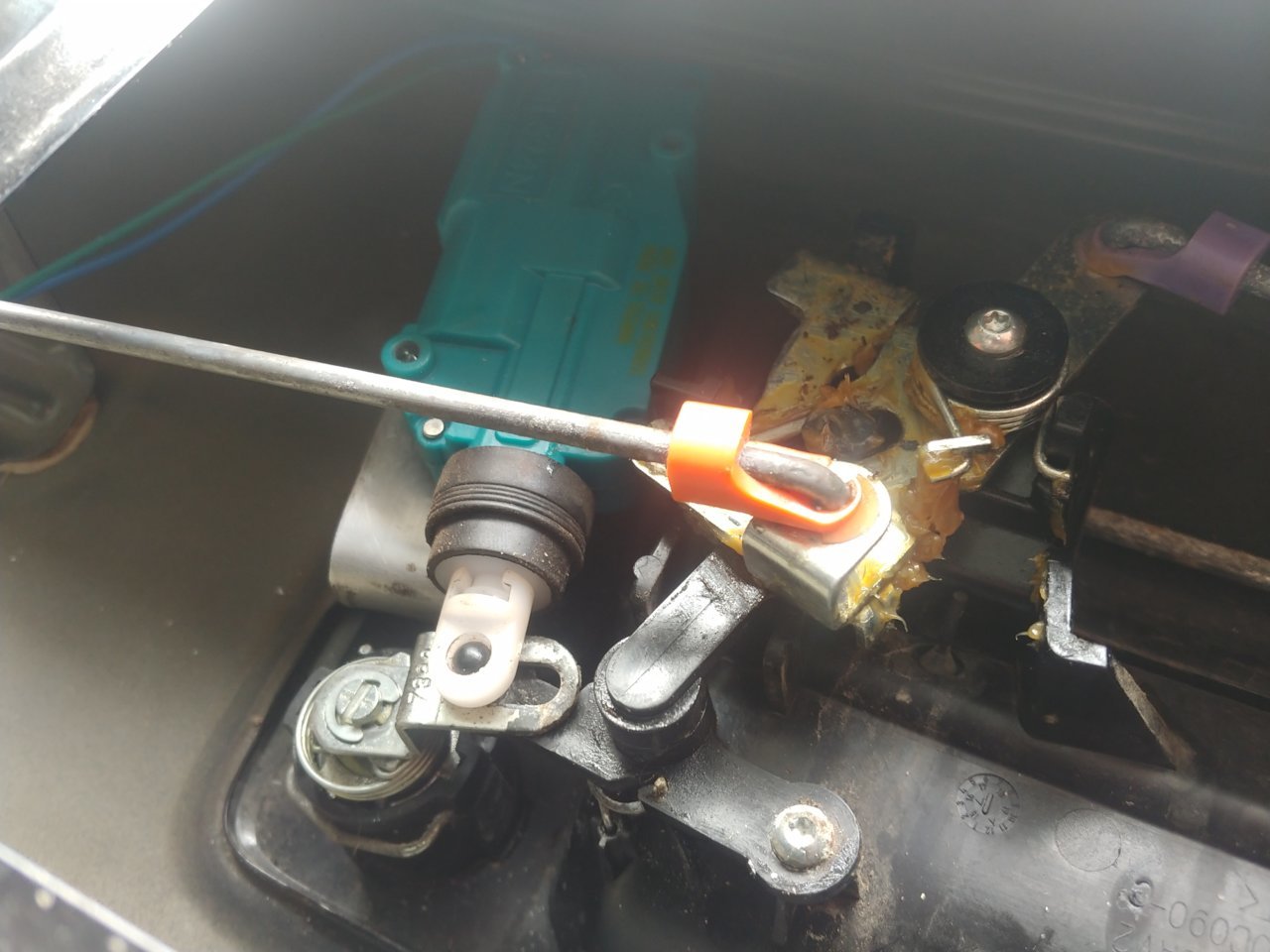

    I just completed this and am super happy with the results. Into this for approximately $25!
    Big thanks to @MESO for posting this and @Tacotoast for posting the the install instructions Toyota provides as it was my inspiration for the mounting location.
    I used https://www.amazon.com/gp/product/B0009SWLE6/ref=ppx_yo_dt_b_asin_title_o04_s00?ie=UTF8&psc=1 as it included everything needed for the install... I did find I needed to add about 5" to the wires but the actuator is quiet and fits well. I had flat aluminum stock from a prior project and picked up some wire loom to protect the wires. I tapped into the passenger side harness in the foot well with t-taps.
    One other thing to note with this is that the actuator end needed to be opened up slightly in order to fit over the pin. It is a good fit and the stiffness of the aluminum stock prevents it from moving and popping off the pin.
