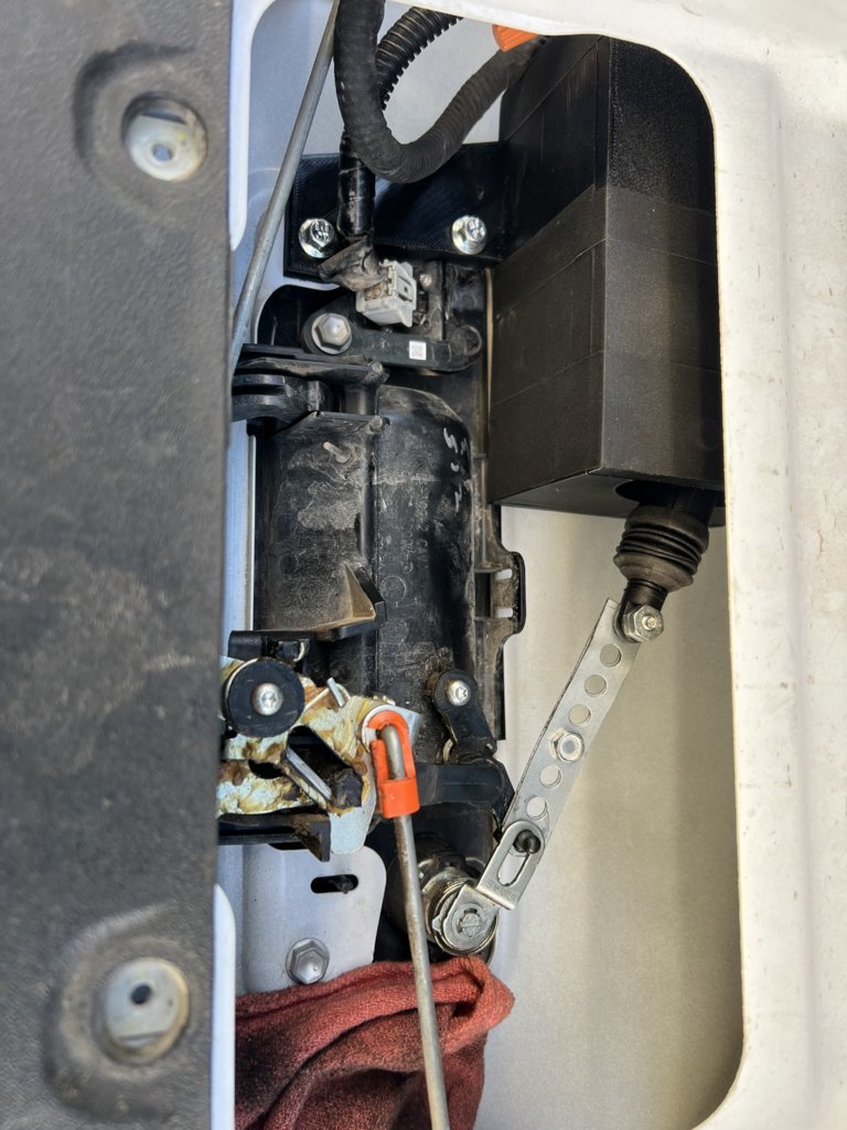

  11. Mar 17, 2024 at 8:58 AM
    #351
    Devilfan
    Devilfan Well-Known Member
    Jan 7, 2024
    #441133
    62
    Will this mod work on a 2nd gen?
  12. Mar 18, 2024 at 6:53 AM
    #352
    Tunngavik
    Tunngavik Well-Known Member
    Oct 14, 2009
    #24328
    3,144
    Alberta, Canada
    2018 TRD Off-Road Access Cab 6 speed manual
    KC-HiLites Fog Lamps, Kicker speaker and tweeter upgrade, USB in center console, Power tailgate lock, Soundproofing, 32" lightbar
    Thought I would post that I did this mod on my 2018 and it's still going strong.

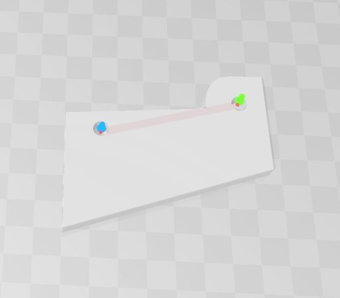

    Thanks for the design. Not sure if its bug in the file or something with cura. what is the size of the box? 100% shows 5.75/3.75/2.25 which judging by the size of the actuator is too small. Also do you mind sharing the actuator that you fit in your Tacoma!

    What scale did you print @Afilao design? When loaded in its original size in cura or prusa it's way too small. Just trying to avoid reprinting it multiple times! TIA

    I've measured the distance between the two screws on my handle. I get 53.28mm. If I measure the distance in the STL, I get 20.85 mm... so the ratio is around 2.55 which is very close to the conversion between imperial and metric.
    But if I open it in Orca Slicer.. I get a warning that the model is too small and it rescales it to the right size.
    I will print it and test it.

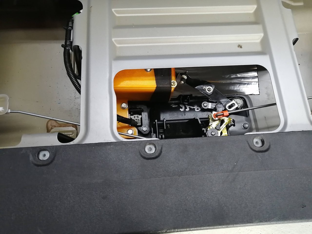

    I went another way. I decided to take the oem mount points and placement (I don't care about the noise and elements). Designed it with Fusion. Spent a half of PLA roll on trial and errors. I've used a cheap actuator from Addison, local Montreal (1.99 CAD) but you can find it anywhere online. I've 3d printed an axle nut (use a M6 from a Princess Auto Axle nut kit), with a tight fit. You might want to glue it if you use the printed one.
    Let me know if you have better ideas.
    Grab the STLs: https://www.thingiverse.com/thing:6988882
