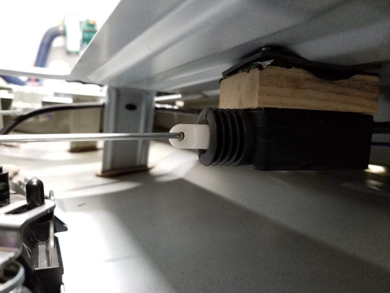

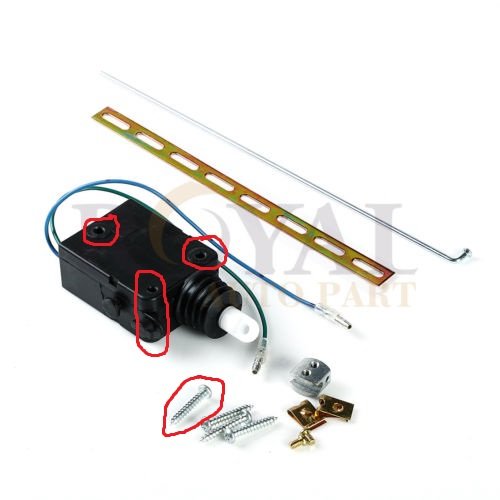

    I used long screws. Anybody who owns a saw or a drill probably had some 2inch wood screws laying around.

    I had to drill out the mounting holes on my actuator as they were too small for a drywall screw. Didn't want to take a chance cracking them.

    I used two 2 inch #12 sheet metal screws. I just made oversizedd holes in the wood block and the screws self-tapped into the actuator.

    Did mine last week. I isolated the motor from the metal and it's pretty quiet. Sounds like a door unlocking in a regular door.
