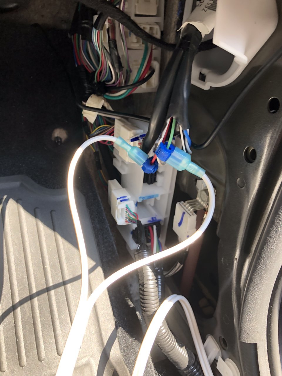

    I have a couple of questions for you and @mesojdm - I have the smart key entry where I just place my hand near the driver side door handle and it unlocks every door (I programmed it that way)...so my questions are 1) Would it unlock the tailgate as well (after I install the actuator)? 2) And so which side should I run the wires along and splice into (driver's or passenger's)? Does it make a difference? *Note - I previously went into the driver's side to tap into wires there for a switch to some LEDs for the side step bars...well my neighbor did the labor actually LOL. Thanks for any advice and thanks for the great and informative posts with pics!

    That wire would work, but it is designed as speaker wire. I personally would opt for something with a little thicker insulation because this will be running under your truck.
    I ran my wire up the passenger side. I wanted it on a door other than the drivers door, and the passenger kick panel is easy to get to.
    But it will unlock with whatever door you splice into. So yes, it will unlock the tailgate with the touch-unlock (whatever Toyota calls it)
    Edit* the reason I went passenger instead of driver is so that if I ever change it back to only unlock the drivers door, I won’t have to redo my wiring, keep it simple and plan long term :thumbsup:

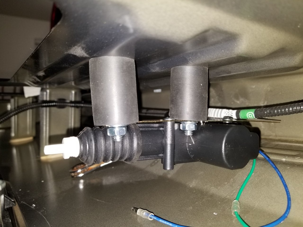

    Thanks to all that blazed a trail on this project. I went a slightly different route. I noticed we were needing a 1-1/2" thick offset for the actuator. I decided to buy a set of rubber 1-1/2" long spacers to mount the actuator to. This helped with the offset and isolated the noise. Also seems to add a little give for the actuator so lock and unlock isn't as violent.

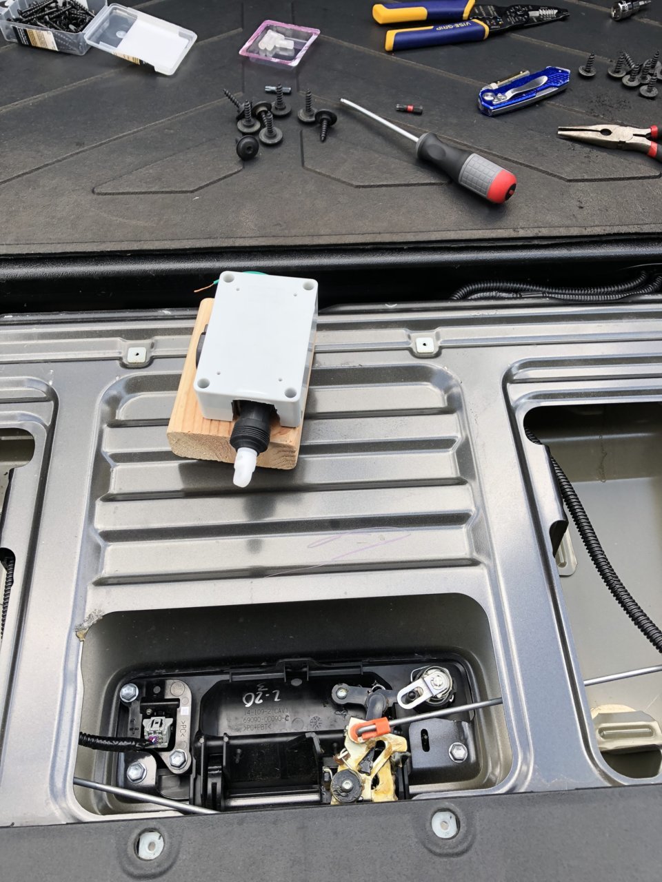

    did this mod this weekend as well! I had a spare electrical outlet box laying around and decided to have some fun and try it. Worked out perfectly as a holder for the actuator. Dremel the hole, screws in, then wrapped the whole thing in Dynamat I had laying around (not pictured) and y'all know the rest as far as wiring and installing goes. IMG_0073.jpg IMG_0080.jpg IMG_0076.jpg
