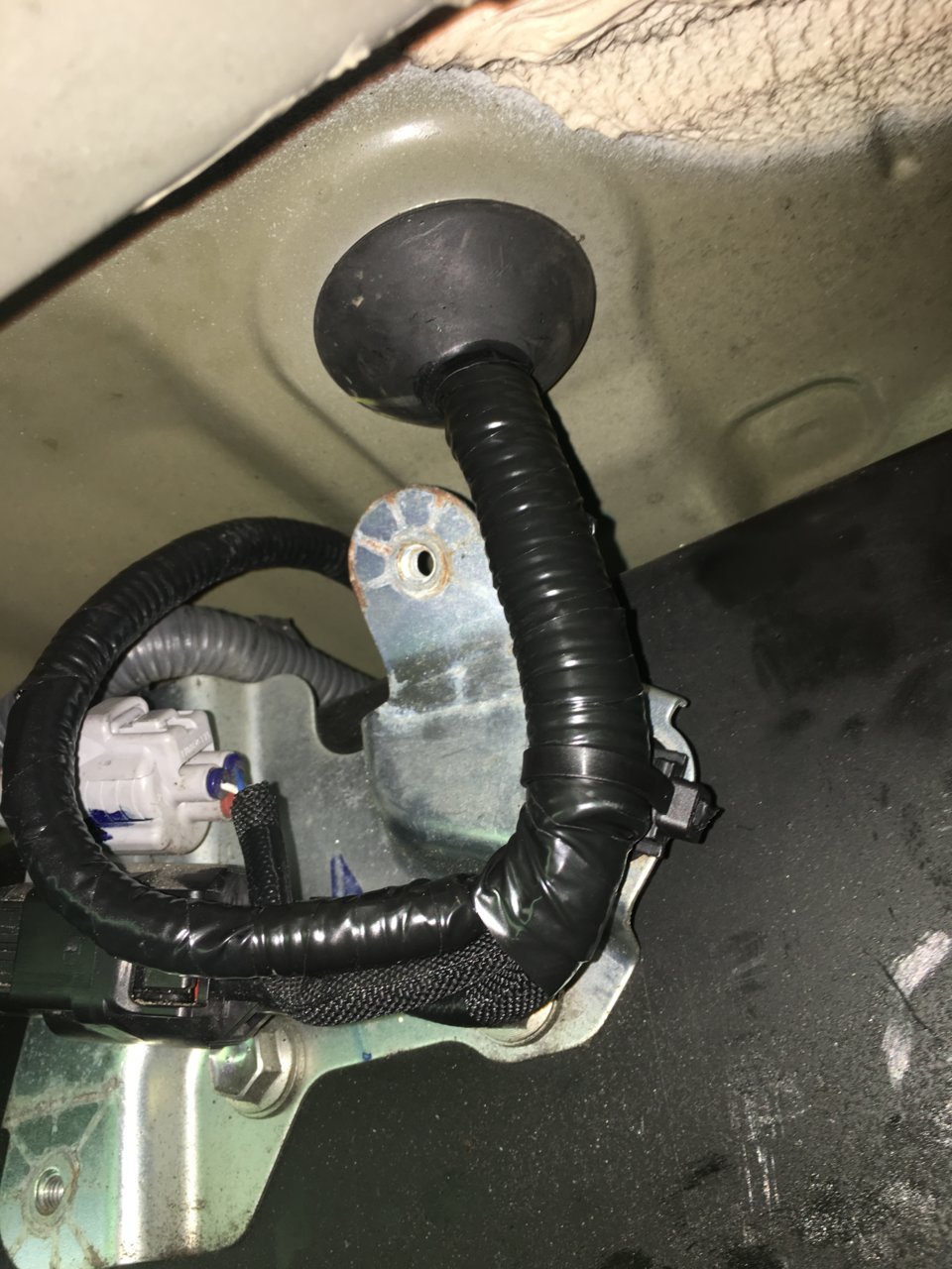

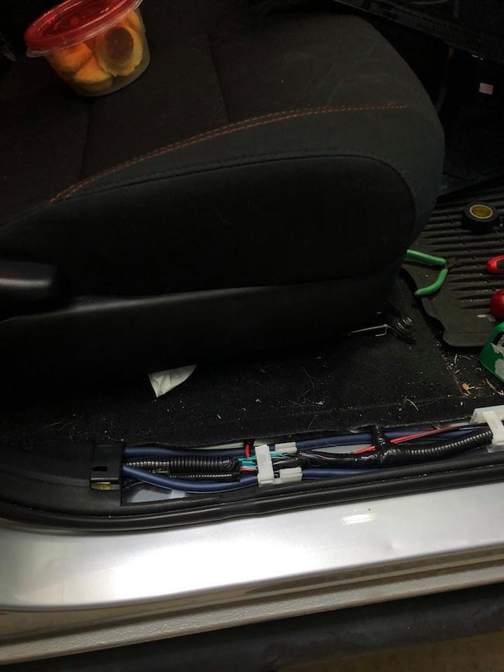

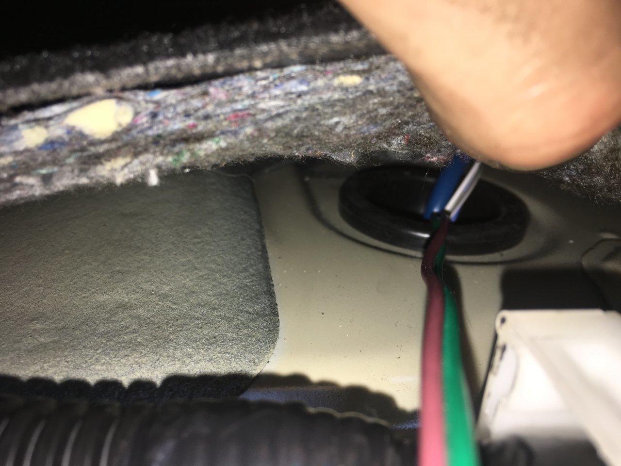

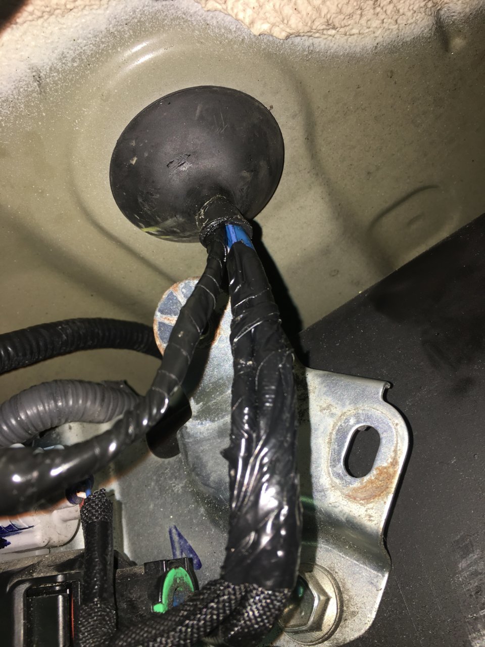

    Thanks @destin_meeks for suggesting the passenger side wiring route. It makes it a lot cleaner to reuse the factory grommet. Ran all my wiring just haven’t finished everything else.

    Glad it worked for you! Keep it clean!

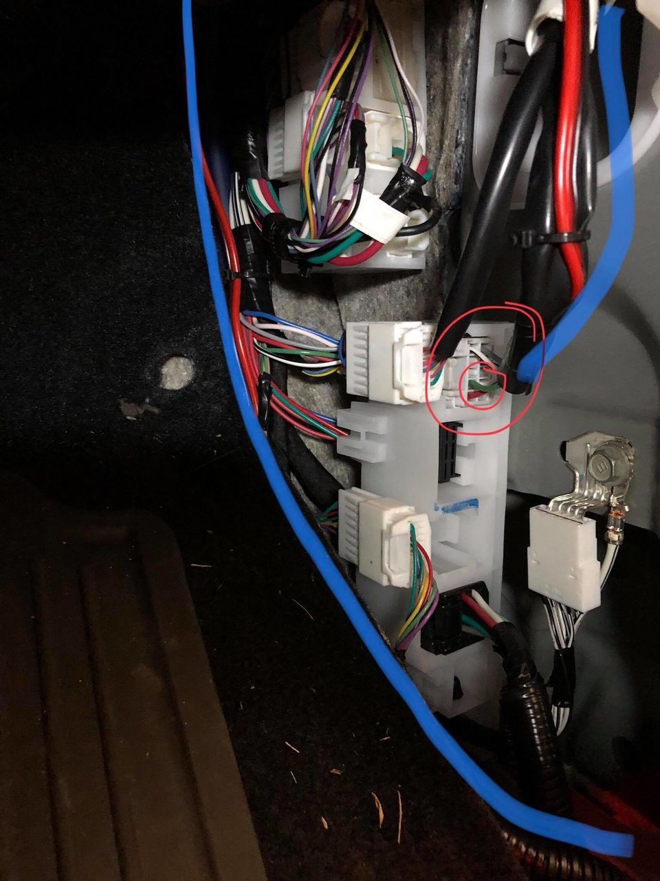

    Thanks for the pictures! I used them, and I even guessed the wiring right the first time!

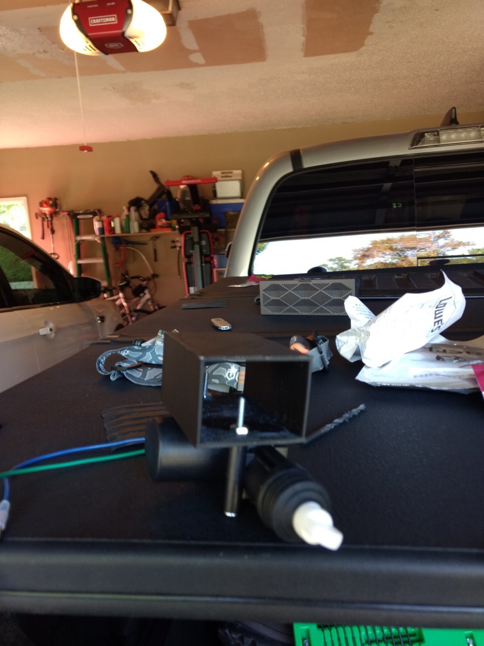

    Thanks to everyone in this thread. I will be doing this mod next week (barring anything coming up) when I'm off work for a while. I, too, will be attempting a different mounting method. I intend on 3D printing a spacer/box for the actuator and lining it with some thick rubber matting I have. Will update one I do. Thanks again!

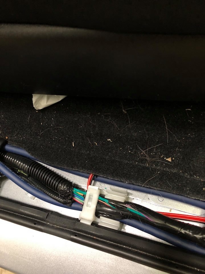

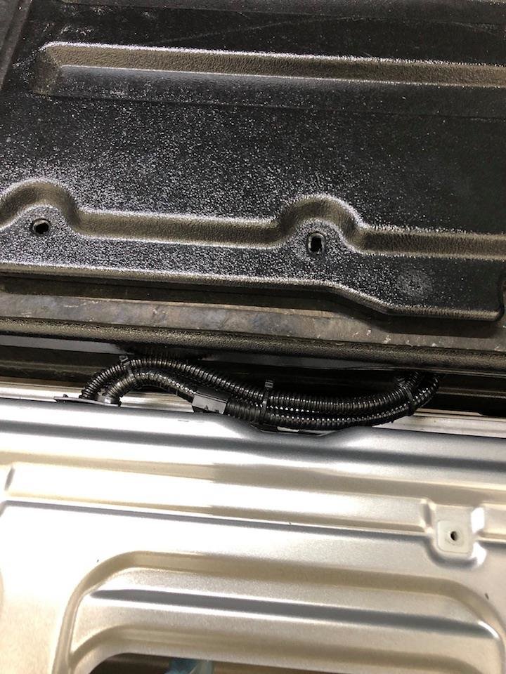

    So I finally got time to do this thing. Thanks Meso and @destin_meeks as I used a combo of both your advice. I did print a hollow box, placed a piece of rubber between it and the metal when mounting, and did go up under front seat and tied to front passenger door. Got lucky on my first combo. I also placed some quick disconnects between tailgate and truck in case I need to remove tailgate. This is my second (maybe first) favorite mod I've done behind my Clazzios! Thanks again y'all!

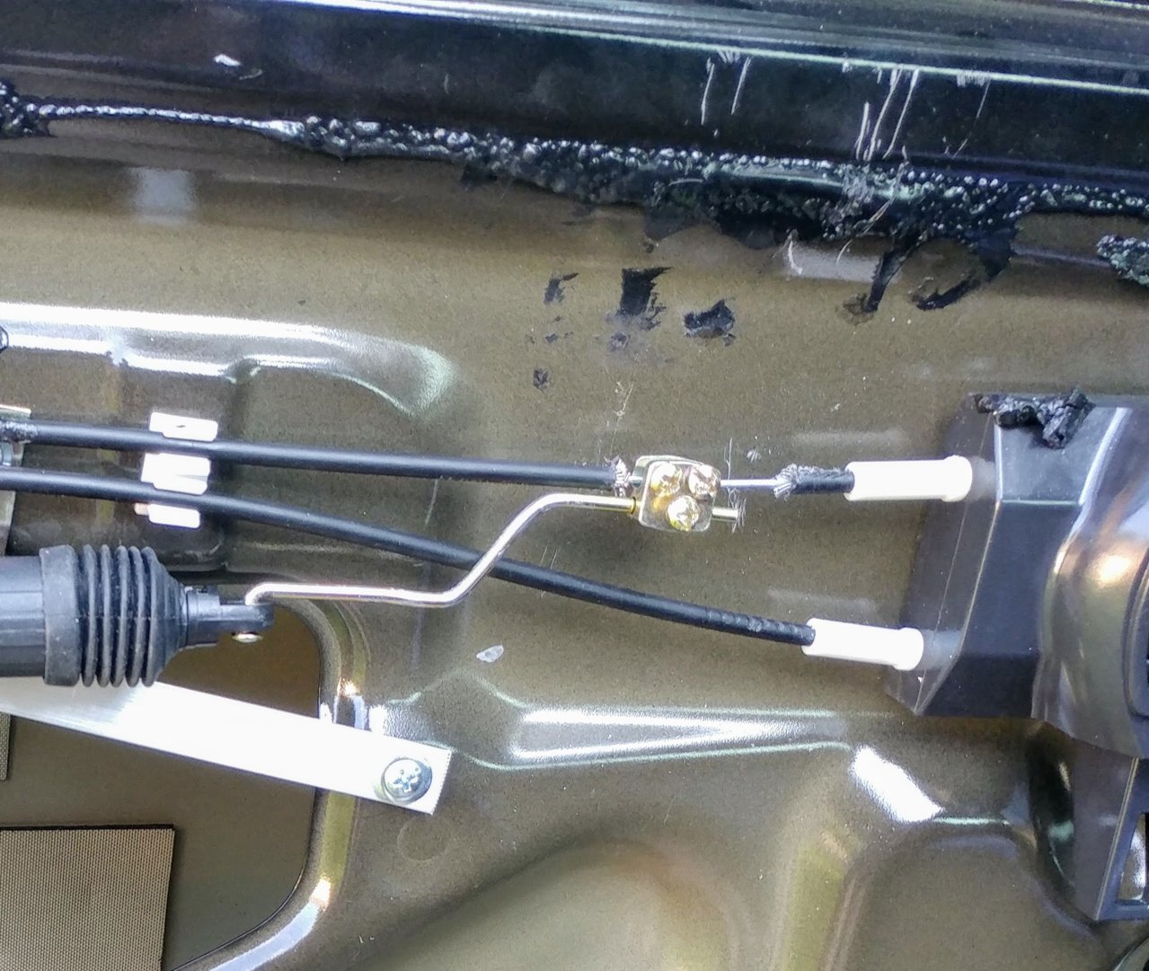

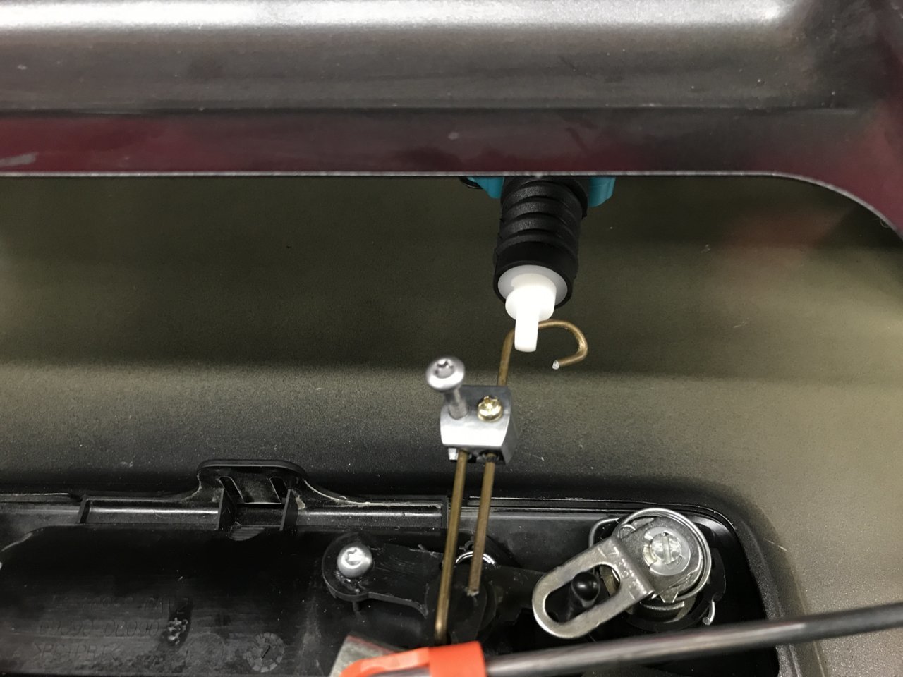

    Resurrecting this to say thank you to everyone that left behind information I needed for my install and to offer a little help myself. I used this actuator https://www.amazon.com/gp/product/B0009SWLE6/ref=oh_aui_detailpage_o04_s00?ie=UTF8&psc=1 as per someone's recommendation. I found at lock that it was pulling harder than I liked on the linkage but at unlock it was pushing harder than I liked. I spent a long time trying different rod lengths, changing the angle of the actuator etc. Eventually I bent a loop into one end of my rod set up and that allowed it to slide as needed to become longer or shorter reliving pressure, while still actuating. And yes, I used a metal hanger from my work uniform because I was hesitant to bend/cut the one supplied. iPhone_75129_IMG_5829.jpg

    OK - I'm planning on doing this on my truck but I have question: why is everyone so worried about using spacers to mount the actuator lower? I did a door lock install on my son's Nissan Versa (BTW - that's a royal pain ;-)) and simply bent the linkage when I found that I wasn't quite in line. Why would that not do the same thing as mounting the actuator on a spacer?

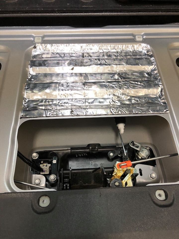

    For what it's worth - here's what my install looks like. And yes, I could've used a single linkage - but I'm lazy and used two in parallel, so I wouldn't have to try and tweak the bending much (you have quite a range of possible positions that way, so it doesn't matter if your bends are off).
