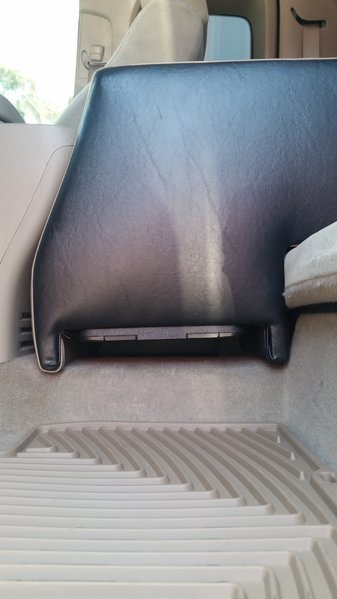

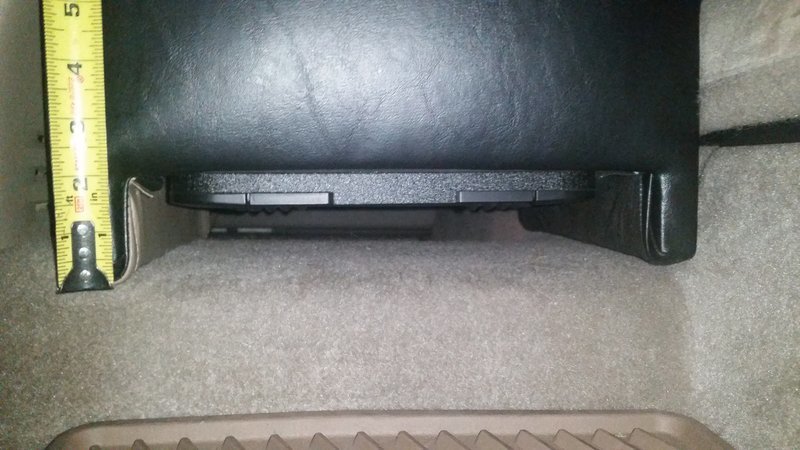

    Ding ding we have a winner. Every sub will have different excursion, what Jim has won't be the same as George, and nobody will match Caitlyn's setup :stirthepot:
    I built a box almost identical to that, my mounting surface is 2" up off the floor and I can still get a finger down there safely at obscene volumes. This is with a Kicker 8" S8L7 square woofer, your mileage will vary.

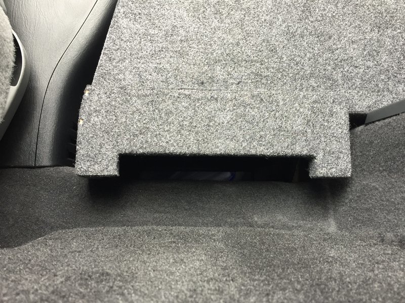

    Clearance issue should be the same on any 12-15'. Through talking with them IIRC they built the box off a 2011 Tacoma. You can order that box and it will work fine but just expect it to fit extremely snuggly, the legs don't reach the floor and you won't be able to keep your rear seat belts. Functionally, the box works great.
    This shows the legs obviously not reaching the floor. And you can already tell by the photo how tight the top part of the box and the back of the center console is just by the angles. I have more pictures if you'd like to see. Just let me know.
