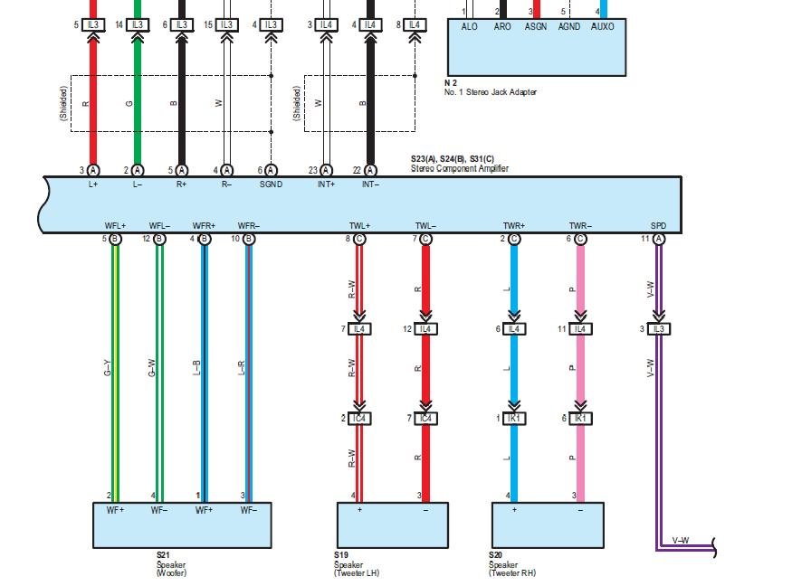

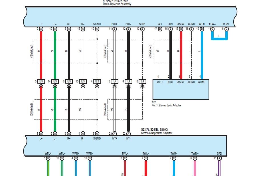

    Heres a JBL amp wiring diagram , since few ppl have PM'ed me asking. I Found this on the 4runner forum, but all the wires matched my amp. I assume the head unit should be the same but you know once you check.
    The PDF of the full diagram
    https://www.dropbox.com/s/1ugwqxzximlux6o/Separate amp wiring diagram tacoma.pdf
    heres a pic below of the amp diagram , but the PDF have more details .
    I pulled my amp remote wire from a 12v piggy back fuse just used this for my high level input. ( not in this diagram)

    did this on xmas, followed the specs exactly and it worked like a charm. thank you OP!
