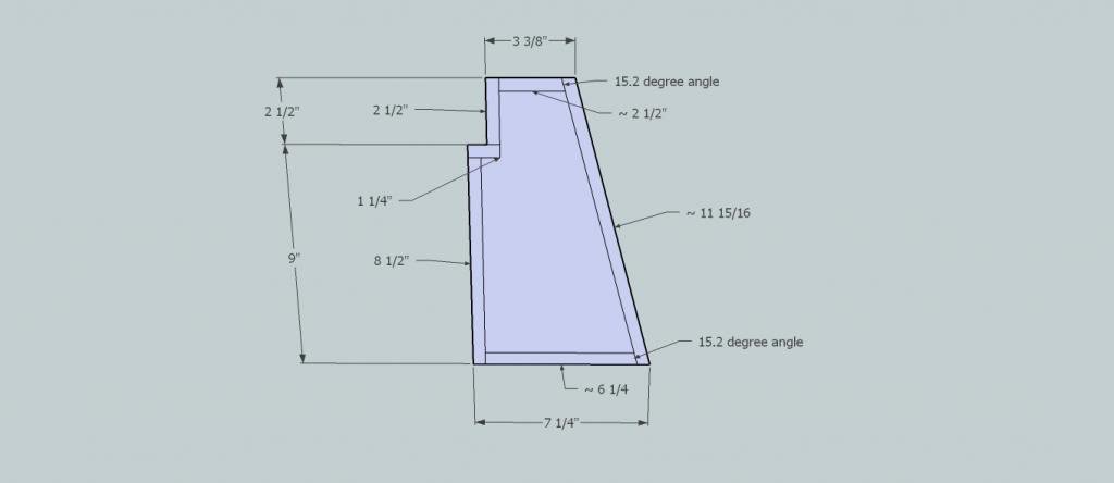

    Thank you so much for posting the pic of the dimensions.

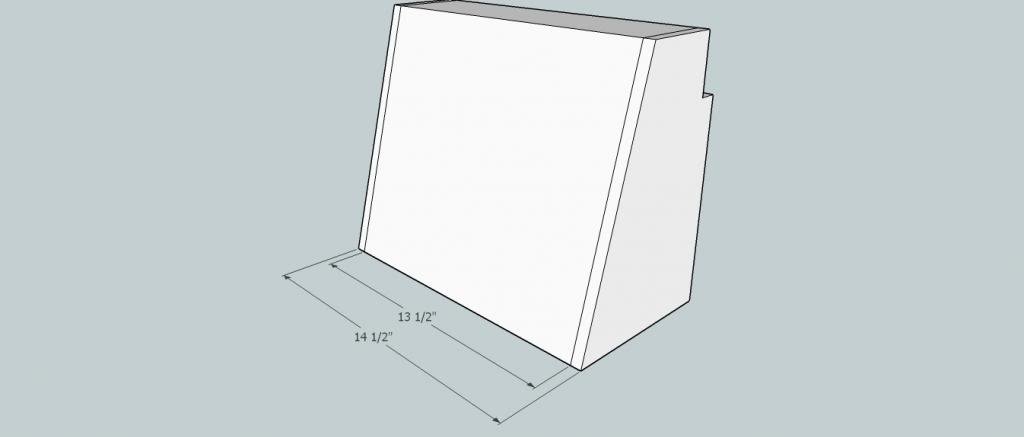

    Thanks for posting the dimensions, I’ve been looking everywhere for those. The box looks great.
    I’d like to get a JL 10TW1 which needs 0.35 cubic ft of space in a sealed box. If I’m doing the math right, (h x w x d)/1728=cubic ft. 0.35*1768=605 total inches. 605”/ 8.5” h / 13.5” w = ~5” d? So without measuring the indent, this box would work, i think. Does anyone know the exact geometry to get the cubic ft from this diagram? Any help would be appreciated.
    Also, whats that hook above the speaker used for? Thanks

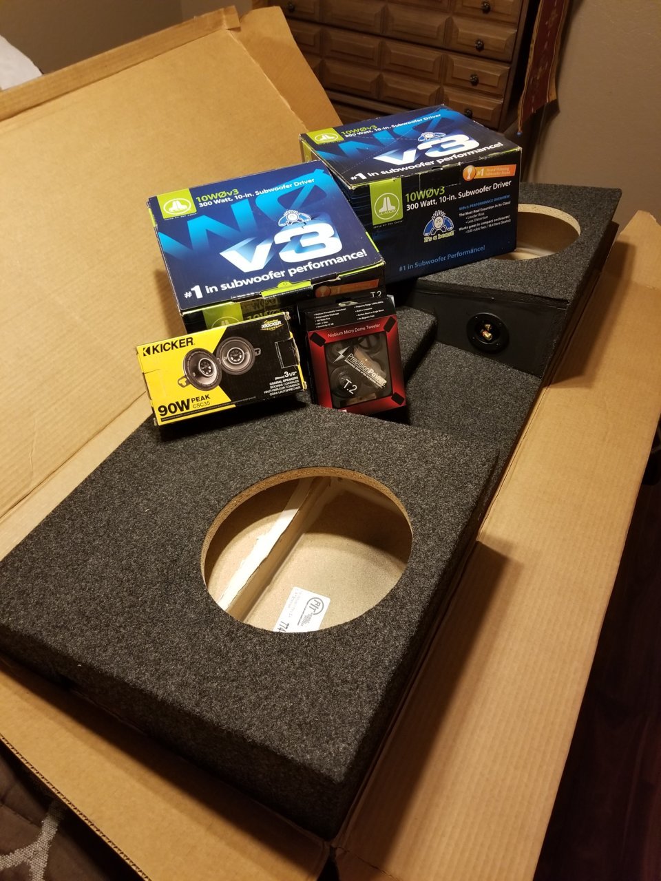

    lightning78
    lightning78 Active Member
    Dec 29, 2008
    #11988
    29
    HB, CA
    07 Prerunner TRD
