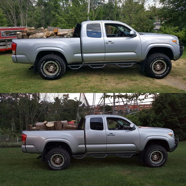

    Firestone ride rite air bags are the best investment you'll ever make if your hauling weight in the bed! I'm running them with dakar leafs but I'll show you a before and after picture of the bags!
    So the top photo is with the Dakar leafs and no air bags and the bottom one is with the dakars and the air bags with 50 psi in them!

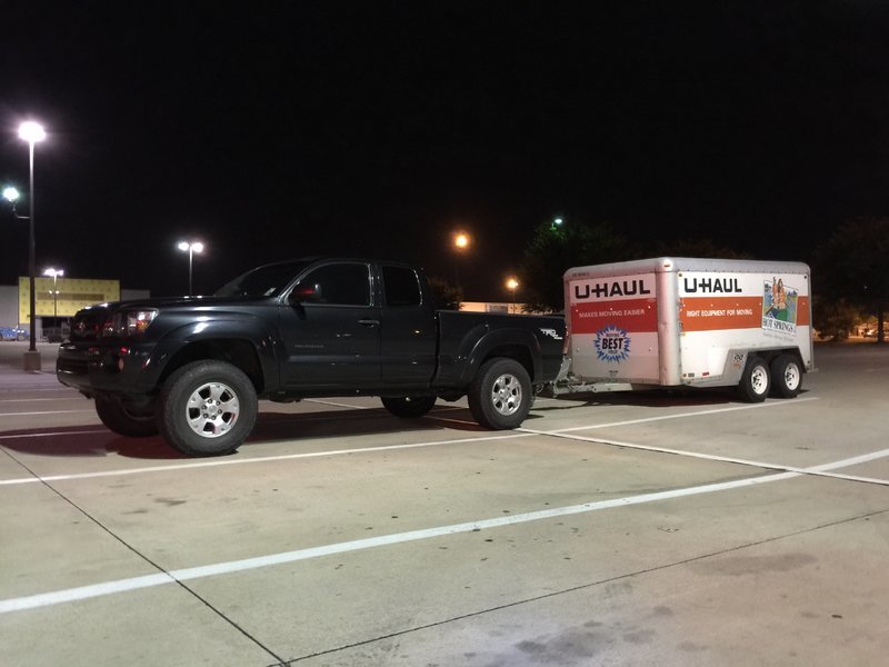

    After considering everyone's advice I ended up renting a 6x12 uhaul trailer. I'm very happy with this decision.
    Stock suspension no add a leaf and about 1100-1300lbs on the trailer.
    One side note for anyone using this setup in the future: check your tire pressure. I went from 32 psi up to 40 psi and it made a world of a difference. The truck and trailer feel much more solid and "together" at this tire pressure

    This is invalid.
    When you add a load, you MUST increase tire pressure, otherwise you run the risk of overheating your tires, causing them to "pop".
    The pressures listed on the door frame are for no load to small load.
    OP: You've got some serious "bro-lean" there. Think you may have loaded the trailer too far forward, the weight is all on your truck.

    Oh I have some bro lean going on for sure haha
    I think the angle of the pic accentuates the lean. We played around with the placement of the weight and ended up moving it back a touch from the pic above. Although, we did move it back a little too much at one point and had a nasty sway at 70mph.
    In the end our best set up was slightly farther back than what is pictured but a combo of saggy leafs and bilsteins set on highest notch does make for a bro lean.

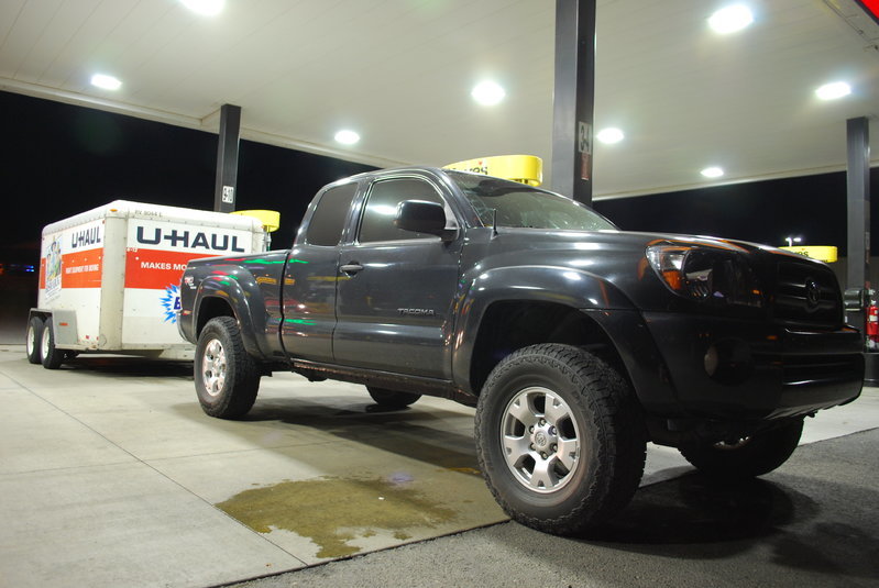

    Just for a final wrap up on this topic: Here is a picture with the load positioned best as far as ride/sway. Some bro lean but I'm more than happy with the way it performed.
