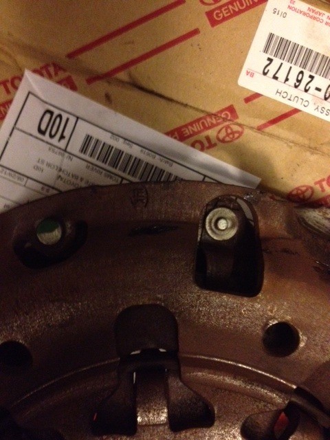

    Alwaysat8k, I have 2012 Access Cab 2.7L 4WD manual that I use for commuting and hunting, and the clutch started slipping at about 10k miles. The dealer first told me that there was nothing that they can do because it is a wear item and there isn't a TSB for 2012 (YET), so the stink I laid down was so furious and they are fixing it at a loss for them, mainly to save a customer. Here is the email I sent to the Service Manager:
    Mr. Cortis,
    First off thank you for reading my (long) email, I know you and your Service Team are always busy. The reason for me contacting you unfortunately is about a major problem I am having with my new truck and I figured you were the guy to talk to (I did contact Jason Cartin last week and he said he would get back, but it was Thanksgiving and all). I purchased a '12 4 cylinder 4WD manual Tacoma the beginning of June this year from your dealership and it now has 10372 miles on it. I have driven from Charleston to Norfolk, Va about 4 times now, so most of the miles are on I-95. I bought the truck new and in the powertrain configuration because being in the Navy, my next 5 years will involve a lot of driving from Groton to Maine to Norfolk, I am also renting out my house in Charleston so trips to the Lowcountry is also inevitable. I also purchased my first Toyota because I did not want to have any major problems with my vehicle (I also bought the Hendrick 100k mile bumper to bumper warranty) for at least the next 5 years or so. About 3 weeks ago I noticed that in 3rd, 4th, and 5th gear the clutch slips under acceleration, so I started asking around about what was going on because I have never (out of owning 4 manual transmission vehicles in the last 15 years) experienced a slipping clutch. My friend has basically the same truck as me but a 2010 at 12k. He had the same problem, and his clutch was fixed under warranty/ TSB 0066-11. Evidently there was a problem with quality control with the LUK company friction plates and they wore out fast (about 10K miles) and they were subsequently replaced by the TSB with a type B (Aisin) clutch. I learned that the TSB only covers 2005-2011 Tacomas, which has me a little confused because my truck is having the SAME symptoms noted in the TSB 0066-11! I can say with absolute certainty that am very proficient at driving a manual transmission (I will go on a test drive with anyone to prove my proficiency), have been since 1997. My first vehicle was a 1971 GMC Sierra with a 3-on-the-tree! I have had a Jeep and 2 Mustangs with manuals as well. I have NEVER replaced a clutch in a vehicle I bought used and drove for years thereafter. My mother-in-law has PT Cruiser with 83k with the original clutch! So you can see I am a little perturbed, why is my truck's clutch failing? I find it a little too coincidental that the entire 2nd gen Tacoma 2.7L with manuals (except for 2012) are covered by a TSB for clutch failure, whose symptoms my truck is having. I have not had the truck broken down to have the clutch replaced yet, mainly because I am furious that a brand new Toyota is having a major problem at 10K! I know for a TSB to be developed a number of complaints have to be made, and I have no intention being a $1600 precedent (with out reimbursement). I know of a handful of people with the '12 Tacoma from my forum (TacomaWorld) that are having the same symptoms as me, and guys that have 2005-2011 Tacomas are telling us they had the same problem and it was fixed by the TSB, which only covers the models the have. So I know there are '12 Tacomas out there in my same boat. I also know the 2.7L manual is a rare model, with most chosing an automatic or V6, so complaints will be slow and not frequent until next year. But I refuse to give up (my nature) when I know I am right. I know clutches are like brakes and are not covered by warranties unless faulty, which I am sure my clutch is. I am dreading taking it in to the Toyota Dealer here in Norfolk because it is not a Hendrick dealer and their reputation is low due to the high volume of service. I do not want a quick evaluation by a technician, I would like a definitive evaluation on the clutch. Basically I do not want anyone else to have the same problem as me, maybe even nip a bad supplier in the bud to prevent future problems. I want my truck fixed, but also I would like to help y'all out in correcting a problem. If I need to come down to Charleston to your dealership I will, or I can go to Fayetteville, NC. I will gladly drive to get my truck fixed. I would also like my clutch replaced with the Aisin clutch components to prevent further premature wearing. I hate to say it, but if the clutch is deemed to be worn due to the operator then I will be getting rid of the truck with a bad taste in my mouth. I will not spend $1600 every 10K miles to get a clutch replaced with experienced operation.
  18. Dec 2, 2012 at 11:07 AM
