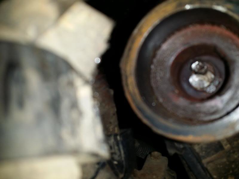

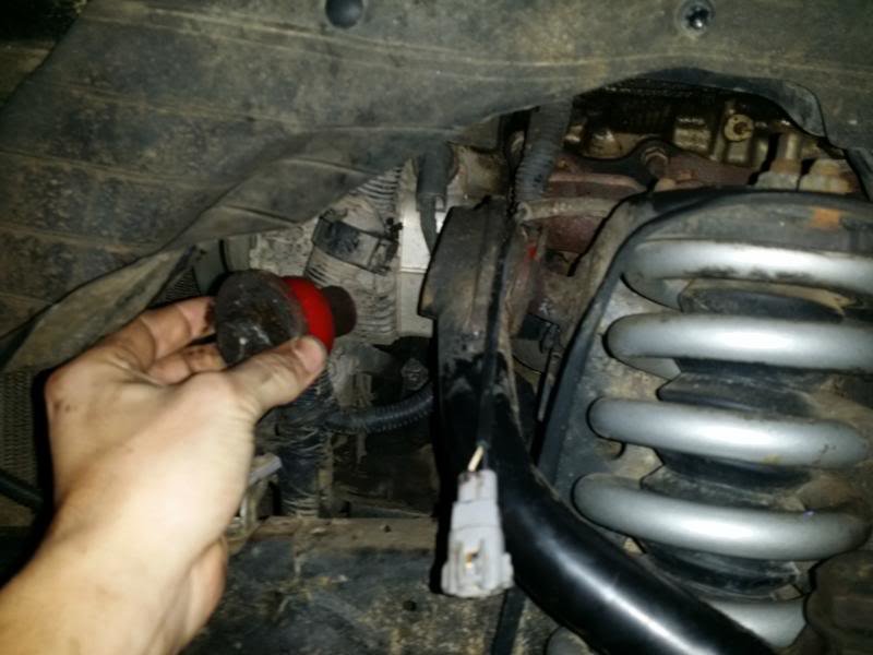

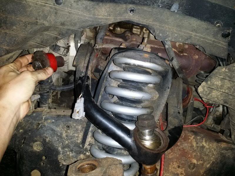

    Decided to replace the Allpro UCA's bushings and new uniballs. Passenger side went great no complaints. Now the driver side... the long 12" or so bolt that holds the control arm to the frame via the coil bucket, has broken off.
    Pics if your not familiar.
    Any insight or help would be great guys, kinda at a loss at the moment.

    Can't you just pound out the remainder of the bolt with a drift punch, etc? Install the new bushings and needed replacement bolt and call it fixed

    Trying to use a punch, no go, then tried an air hammer, no go. Most of it is "rust welded" together. Guess it'll just be a lot of pounding and praying.
