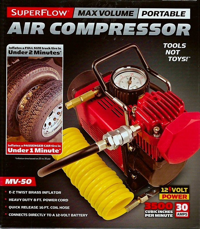

    I acquired an MV-50 SuperFlow pump and it was perhaps a tad slower but the wires did not overheat and it fit into a smaller, canvas carrying case. It gave me years of good service until my last use, last year, just south of Gonzaga Bay, when I was refilling my tires and when moving the fill hose to reach the last tire, accidently pinchedd the tube (while the pump was running)... and that blew out an internal check valve and ended its life!
    That was not the pump's fault! But, TURN OFF the pump between tires, just in case!
    Well, for Father's Day, my kids got me a new MV-50 along with some of those automatic deflator devices you screw onto the tire stems. I did an in garage test, using a stop watch... Here are my findings:
    Using a precision dial pressure gauge, I deflated my tire to 20 psi then timed how long to add 15 psi (back to 35 psi). The answer was 2.5 minutes for a 265/75-16 all terrain tire.
    1 min = 6 psi ADDED
    2 min = 12 psi
    3 min = 18 psi
    4 min = 24 psi
    5 min = 30 psi
    The gauge on the pump was pretty accurate when the pump was not running, but jumps almost 10 psi when on and filling. So, to know when to remove the fill hose, I ran the pump until the gauge was just below the 45 psi line (for 35 psi in the tire). You can toggle the on off switch to see the more accurate pressure.
    Under 2 minutes???
    In 2 minutes, it will add 12 psi to a truck tire, if the tire is flat, you may need closer to 6 minutes if your tire needs around 35 psi for the highway. Obviously more time if you have a higher pressure tire.
    A footnote, the automatic EZ Deflators were pretty easy to set up (they are adjustable). You manually deflate the pressure to the desired reduction (in my case 20 psi for dirt roads... and I can quickly let more air out for sand if needed). With the cap and lock ring turned all the way clockwise, attach it to the tire stem and then turn the cap counter-clockwise until air escapes, then clockwise to it again doesn't. Now, bring up the lock ring to hold the cap in that spot. After I refilled the tire, I placed the deflator on the stem, and it let air out... It took a long time, I didn't clock it, and as the pressure got lower, the rate also diminished... when it was coming out real slow, I removed it and checked the pressure... it was 22 psi. The kit comes with 4 deflators, so I will put them on all four tires and after a beer, will finish the job with a pen or similar tool to depress the valve stem.
