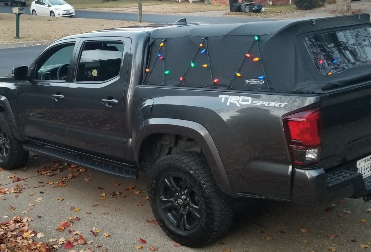

    PNWTacoAdventures
    PNWTacoAdventures Well-Known Member
    Jul 28, 2020
    #335857
    262
    Washington
    2020 Super White Tacoma TRD OffRoad

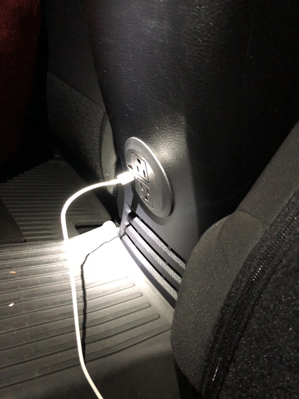

    Gutentight
    Gutentight Well-Known Member
    Nov 8, 2020
    #346218
    269
    IL
    2021 Cement Off-Road 4x4 DCSB 3.5L AT
    Did the AC outlet in cab and 400W anytime mod. Technically not an outlet, just wired up short piece of extension cord under passenger seat, since I realized an outlet on back of center console would be blocked with rear seat folded during trips.
    Enough power to run the 120V plug-in ~200W electric heating pads my wife uses for cramps or a sore back. Pure resistive load doesn't care about the modified sine inverter power either. (saved a lot not getting heated seat trim)
    Not sure what to run on the bed outlet, but it's surprising they skipped an outlet in the cab.
