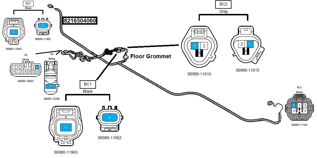

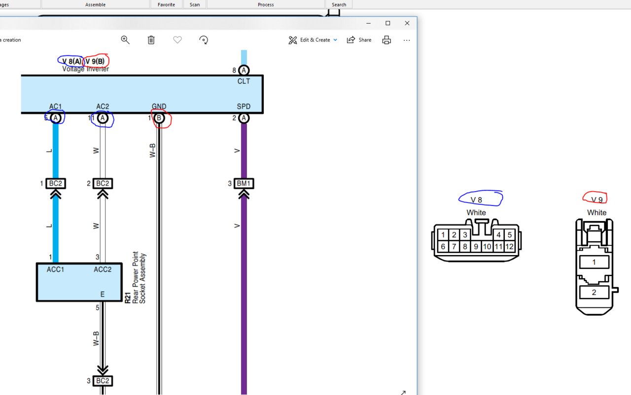

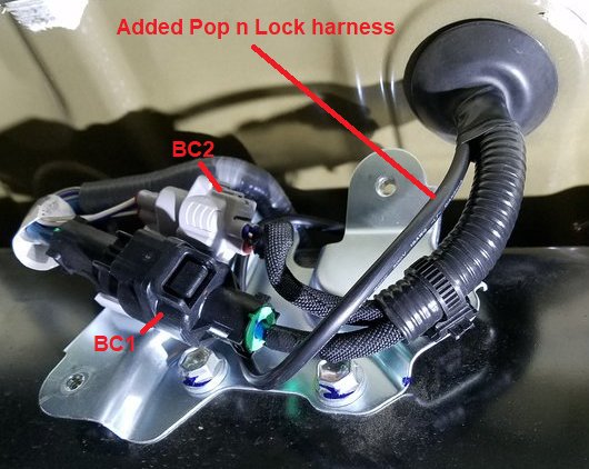

    The connector is under the front passenger seat area right after exiting the floor pan grommet. @mesojdm has plenty of them, they are the same as the Tail n Stop lamps connectors.

    Spoon feeding, I stop doing.
    View the pic again...BC2 not R21...

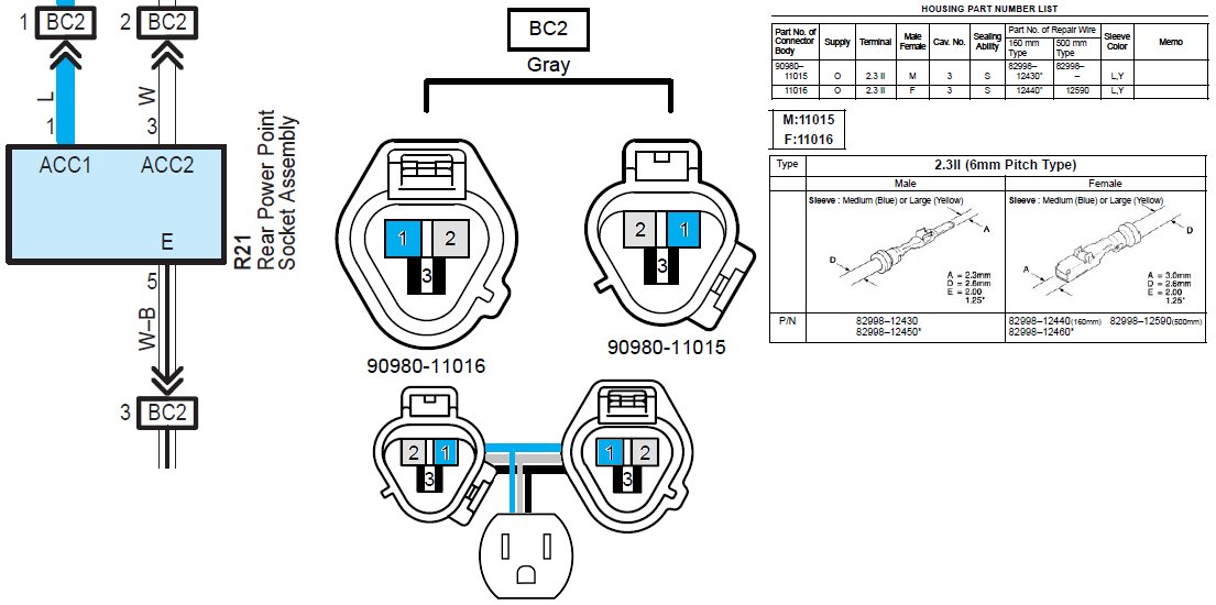

    Help me?...you still don't see...
    BC2 is InCab
    R21 is outside bed
    BC Ground point is also InCab

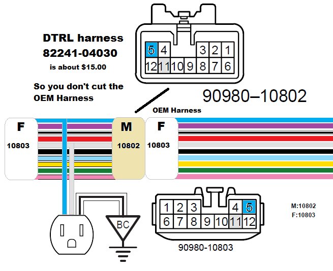

    Here's another to confuse:D
    The connector V8 mates with 10802, which is the connector in the 2nd Gen's DTRL harness.

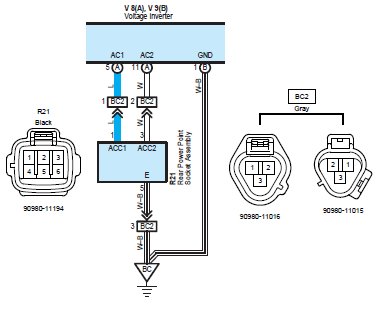

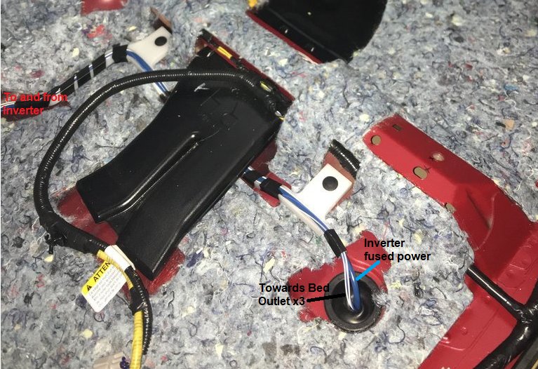

    ED1, BC1 and V9 are 12vDC to the Inverter.
    V8 pins 5 & 11 are 120v AC that run to BC2 THEN out the floor grommet to R21 in rear bed.

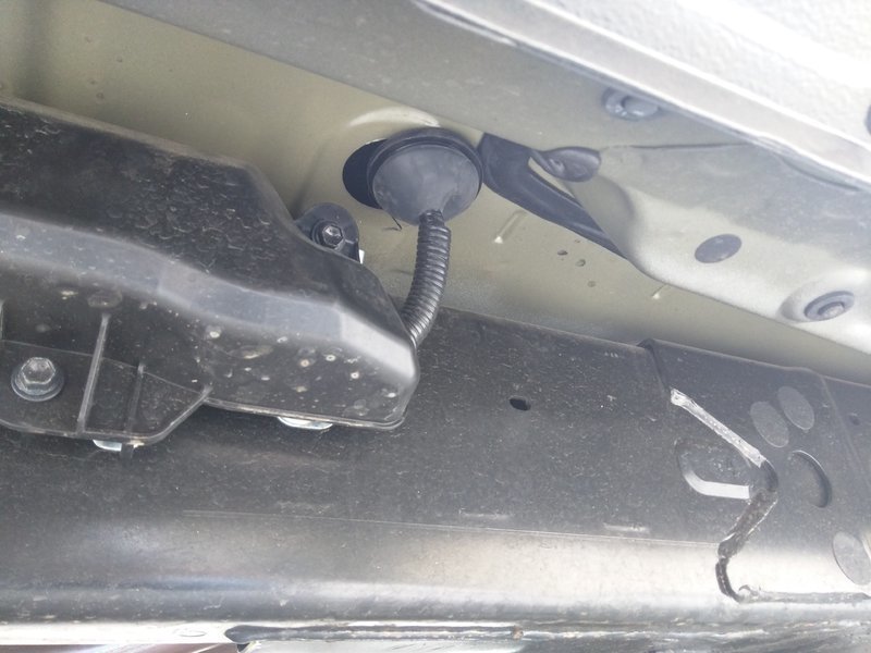

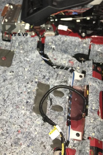

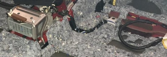

    So the connection would be done outside then routed alongside the original wiring back into the vehicle. But as you can see, the interior needs to be removed "a bit". Maybe a little more than most would even attempt. On the 2nd GEN which uses same connector, this one is inside the cab before it exits the floor grommet, much nicer to hide, but still a task.
