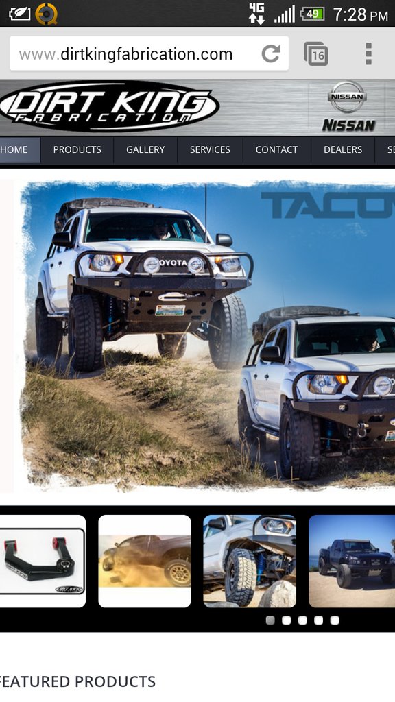

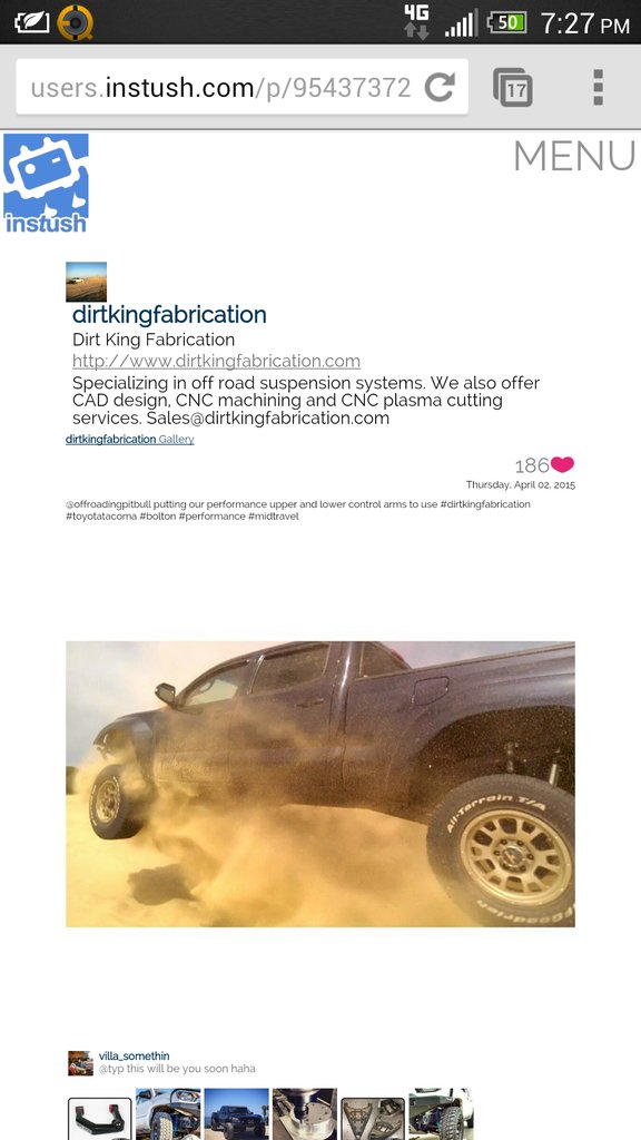

    Well it looks like Dirt King added me onto their slot of pictures on their main homepage for their site today.
    Screenshot_2015-04-02-19-28-17_zpsemzntl_06a255d2e180aaa8bb9b6eb67b78563b51ecd746.jpg
    Upon clicking the picture you get this
    Screenshot_2015-04-02-19-27-23_zpsezdh4x_c217c2c7c3e4422ce95a5248bb44c1b89ddd9e61.jpg

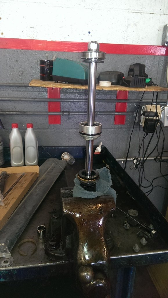

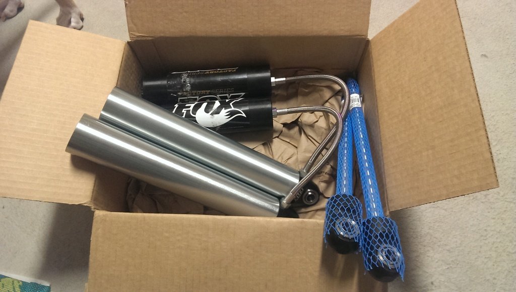

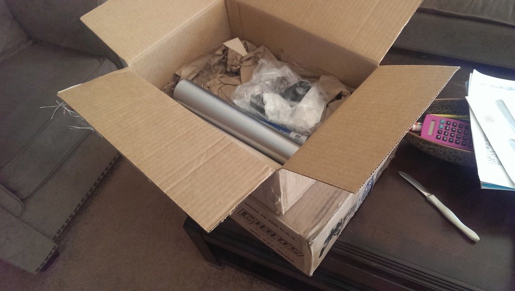

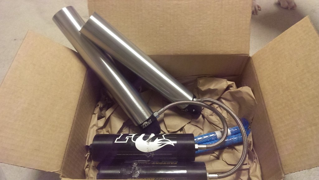

    Well it looks like my parts to build the shocks arrived early. :D
    The parts box came with cool snap bracelets. My model. :D
    About 50% assembled. I have to pull all the snap rings and pistons and miscellaneous random shock part retaining hardware from the old shocks, but here is my stopping point for now. More to resume maybe tomorrow, for sure on Monday.

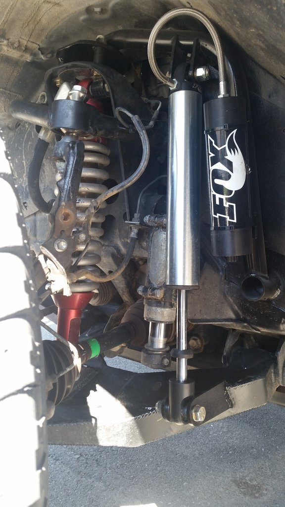

    Dismounting and revalving the shocks to my specs.
    Completed broken to fully functional 2.0 secondaries ready to mount and do some work!

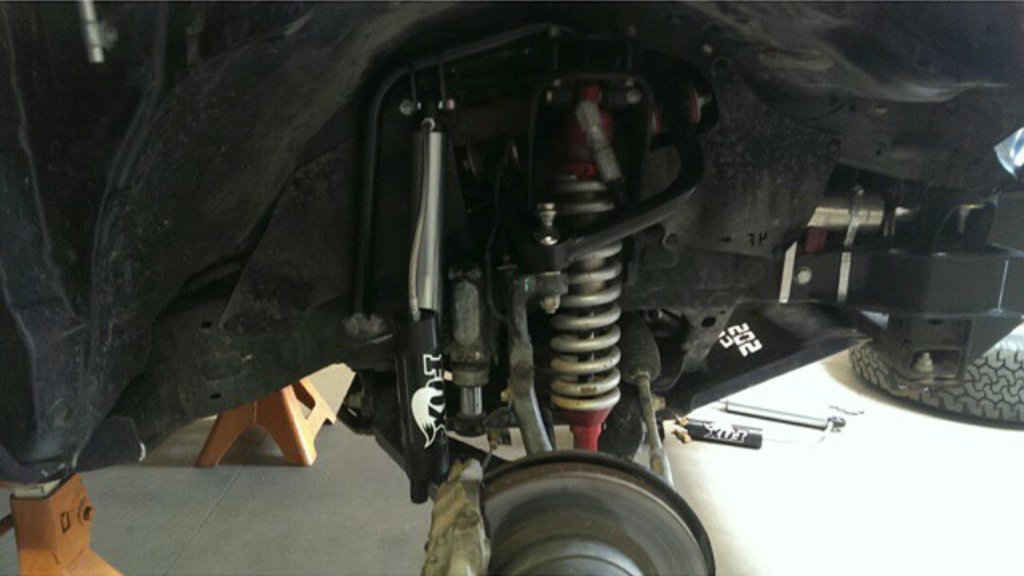

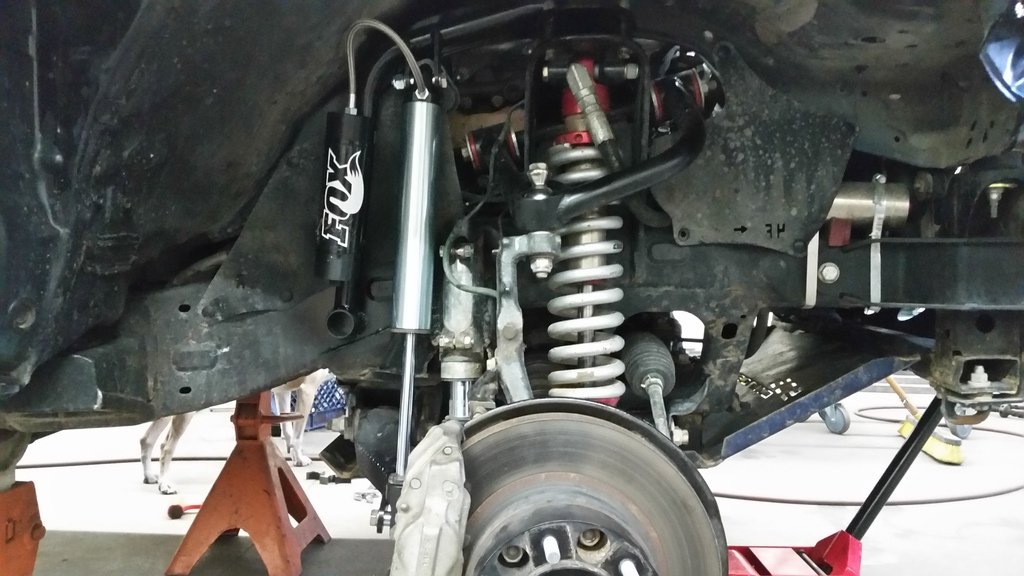

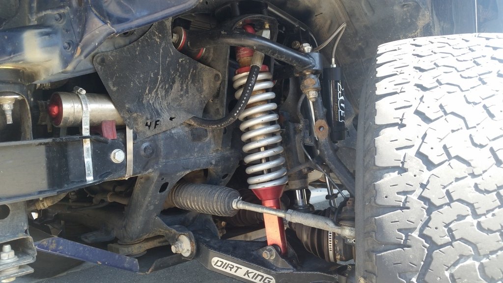

    Mod day mods 4/11/15, I hit a stopping point at this picture waiting for Jerry to make the lower mounts and come over to weld everything.
    Screenshot_2015-04-11-20-46-46-1_zpsnmpx_82c31c51bffaa93f20232048dbb557da84876a57.jpg
    Finished product. Thanks A BUNCH to Jerry at BAMF and everyone else for all your help at the mod day today. I seriously could not had done it without you guys.

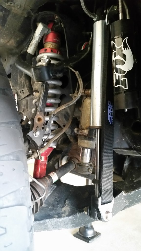

    Installed some PRP quad wrapped limit straps to keep the suspension downtravel at the uniballs in check. The install on these was actually not too bad, but not as easy as it seems.

    Gusset your spindles dude, seriously

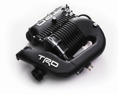

    Jealous... I have a feeling I'll never be boosted now that the TRD S/C program isnt supported. :(
    Oh and nice truck!

    Well just because its not supported doesn't necessarily mean that you still can't get your hands on them. I know of a few dealers that still have the bower left if locating it is the problem!
    You don't live in Cali. Maybe you can settle for a URD blower if worse comes to worse. Oh and thank you! :thumbsup:
