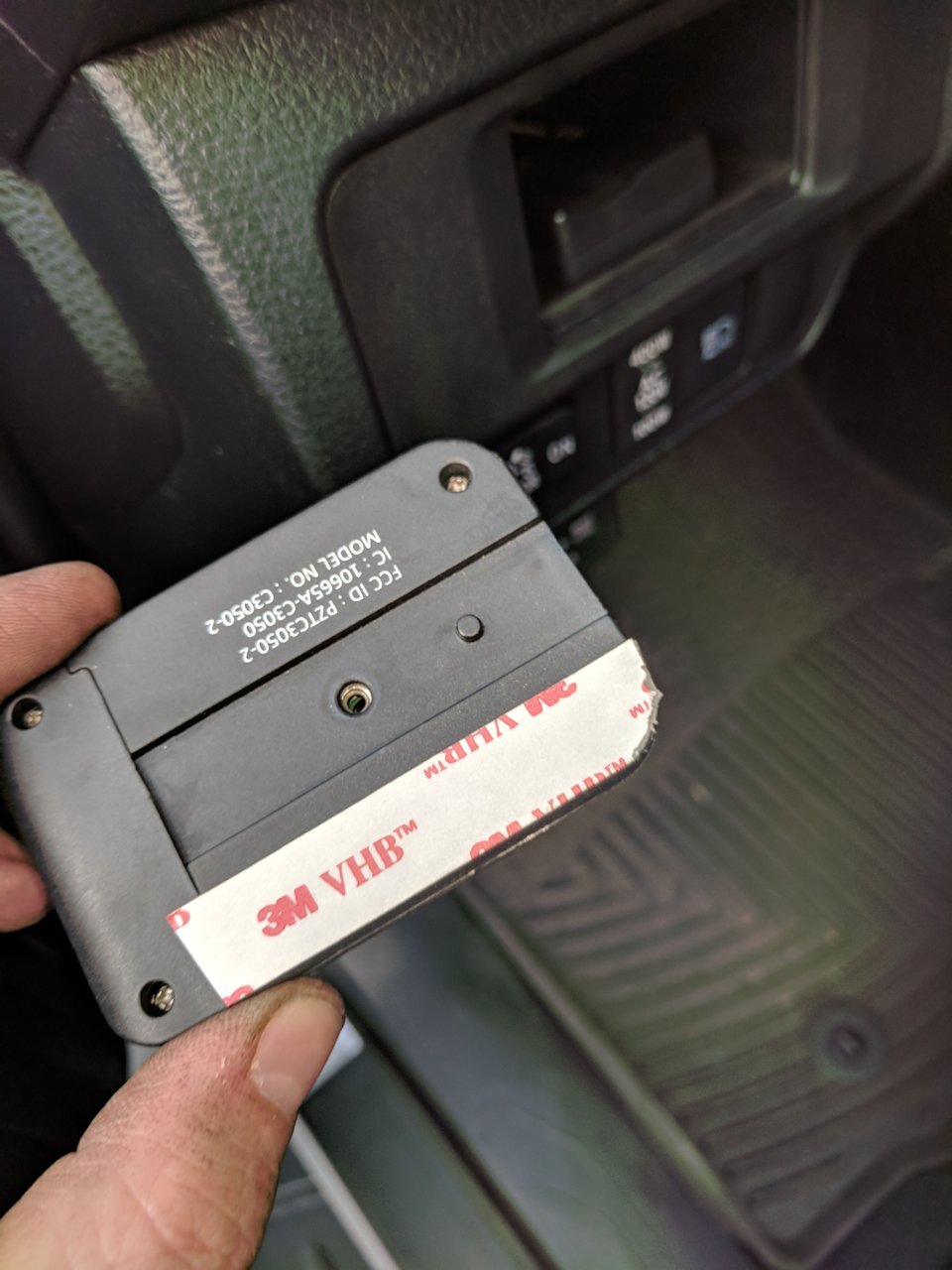

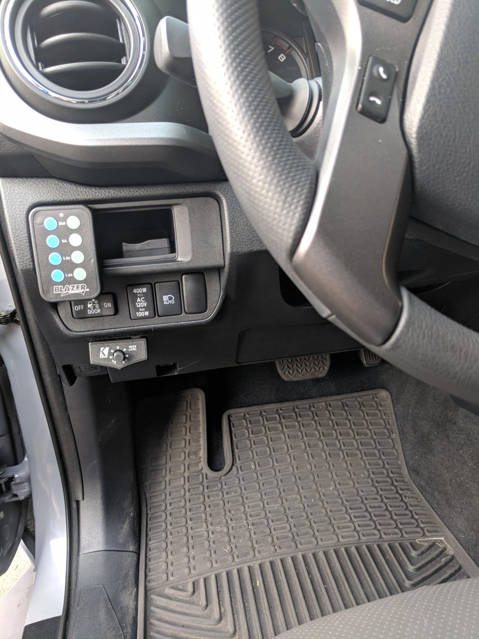

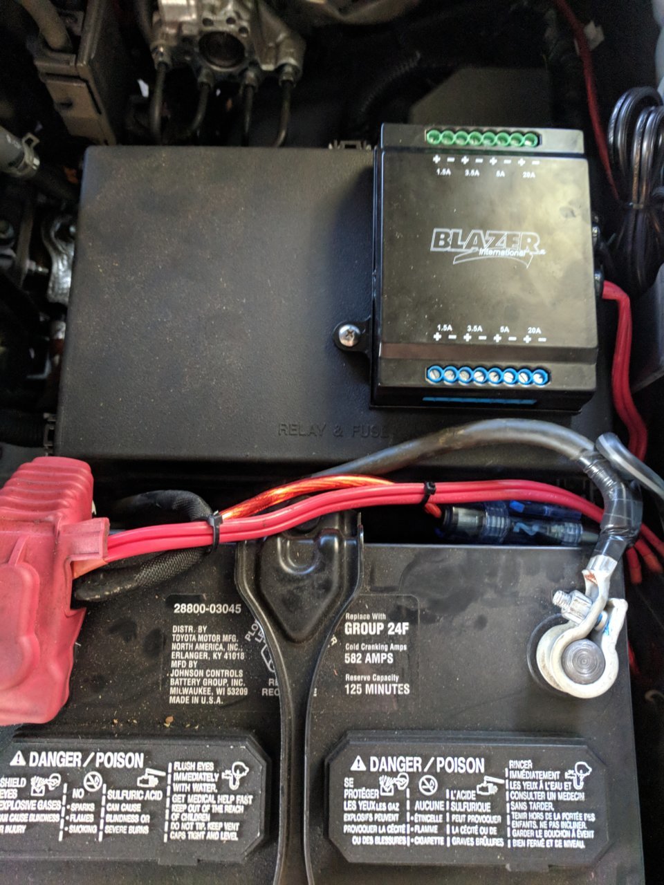

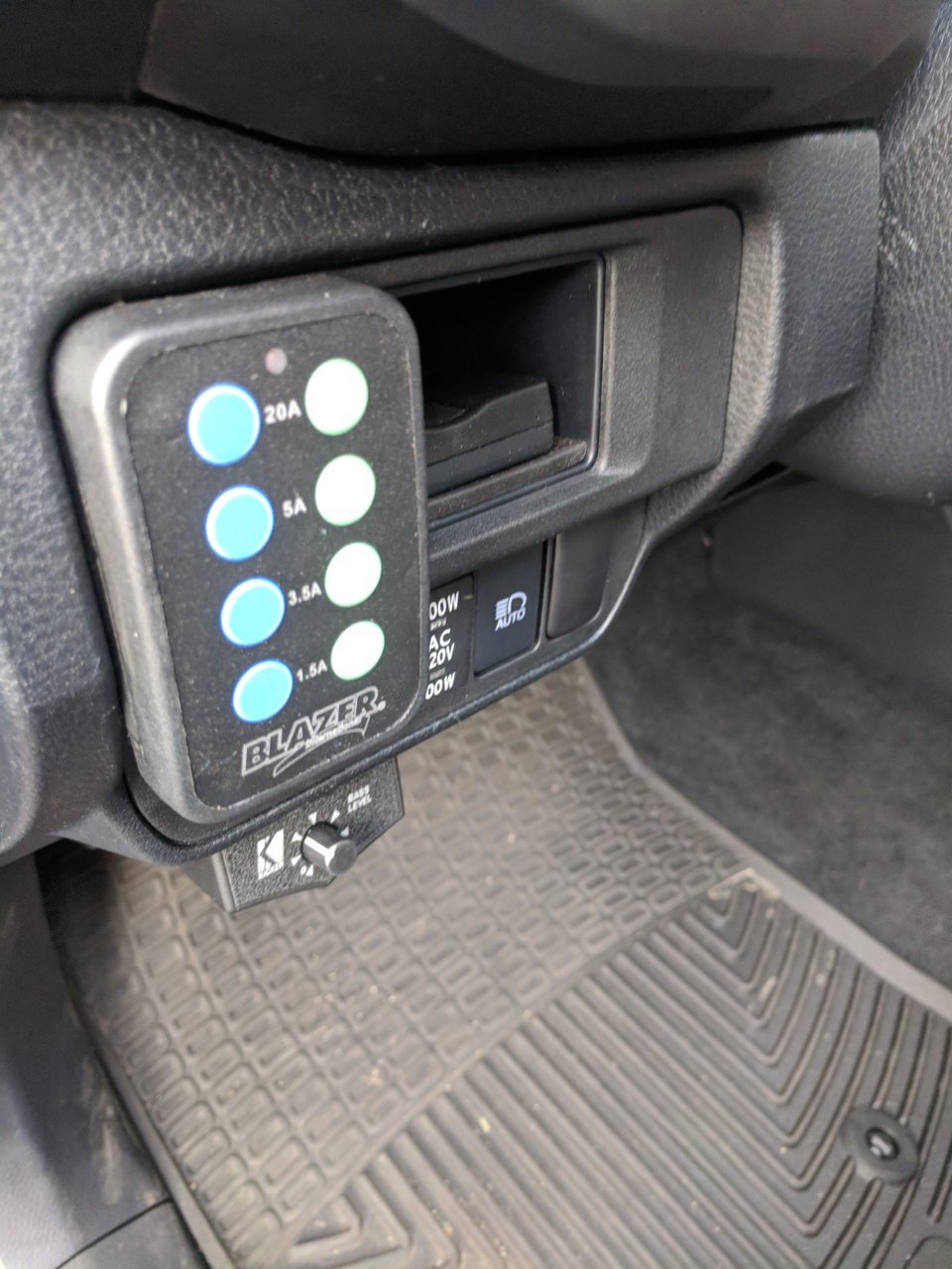

    I ordered one, wired it up in a few minutes and so far am impressed. I mounted it right on top of the fuse box lid. Connected the positive to the battery and ground to the ground location on the side of the engine bay. For the remote, I removed the visor clip, put a strip of 3m VHT tape on the back and stuck it to my dash as shown below.
    So far it powers an LED pod on either side of my hitch. This week I will be adding bed lights, ditch lights and a front bumper light bar. Plenty of empty locations left for adding more accessories! Install of new accessories is crazy easy running one power wire to the new accessory and then grounding that accessory at the mounting location.

    Awesome. If I have this right: install on top of fuse box, connect pos to battery and ground to ground, attach wires from light bar (etc) to unit and use remote to switch off and on? Absolutely no need to go through fire wall and no need for rocker panels/switches? Most time would be spent running wires from the light bar/Pods under the truck to the engine bay to the unit?

    EXACTLY CORRECT!
