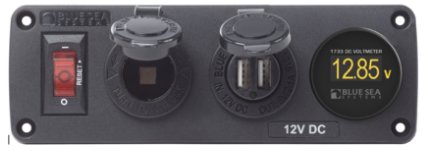

    OME Nitrochargers w/886s & Dakars, ARB Deluxe Bull Bar w/Warn winch, RCI sliders with kick out, IFS & Mid skids, BFF Hi-clearance rear bumper, Brushed Copper 17" SCS Ray10s w/285-70 KO2s, Black OEM 16" steelies w/255-85 KM2s, Leer contractor cap w/Smittybilt overlander xl RTT, Off-Grid Engineering dual battery kit and bed power panel, Blue sea aux fuse block, Wyntner 60L fridge freezer, ARB dual compressor, Pioneer 720BT head unit, CB radio, @Matt_Gecko bed and engine bay lights, @TacomaTruckParts Dirt bike tie down bar, color matched OEM grill, A-Pillar phone mount mod, @Docloco rear seat molle panel
    I got a pretty slick product from Matt from Offgrid Engineering. It came with quality pre-cut wiring that you just have to route to your battery or fuse block. I used a dremel to cut a rectangle out of the bed and mounted it above the storage compartment. Looks clean - I don't have a pic of it installed though. It has a switch to turn the outlets on/off.

  9. Jan 25, 2018 at 9:45 AM
    Clearwater Bill
    Clearwater Bill Never answer an anonymous letter
    Oct 11, 2014
    #140097
    25,080
    Billy
    Largo Florida
    '13 5 lug AC w/convenience package
    A few OE parts from fancy trucks
    Take one please. (and post it)
    I'm assuming this getup is water proof?
